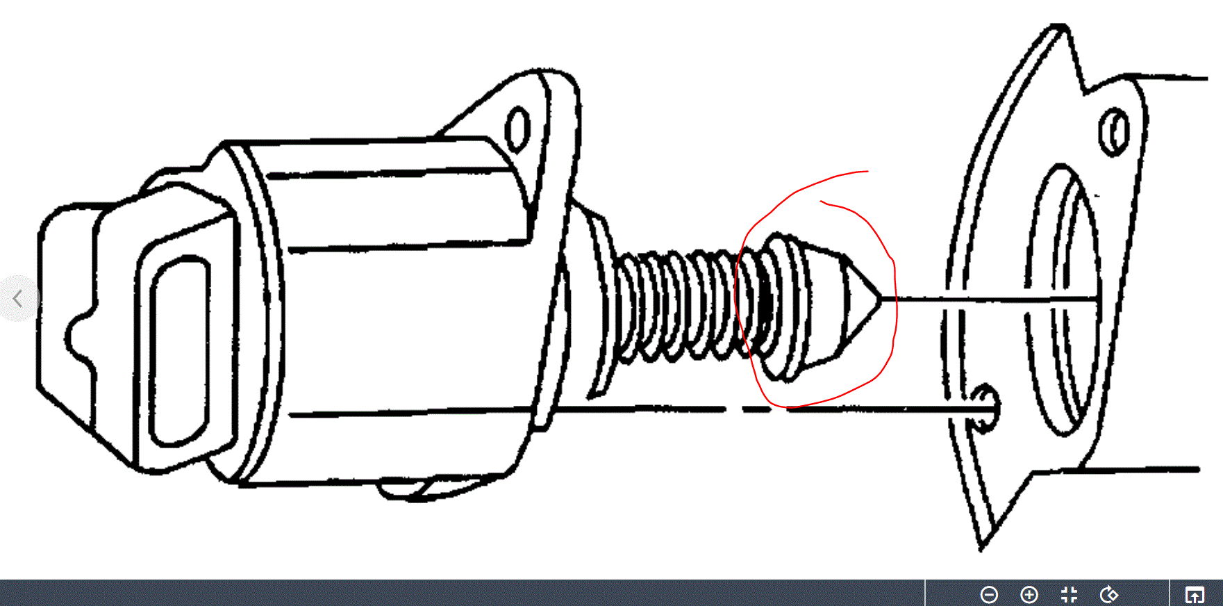

The car will run good 60-70 mph as long as you keep your foot on the gas pedal but as soon as you take your foot of the gas it shuts off. It will start right back up but you can not let off the accelerator. Check engine light is on. It coded MAF sensor. Changing the sensor didn't change anything.

Have you checked for engine vacuum leaks as well as the idle air control valve (IAC)? The IAC is what maintains engine idle speed.

Start with checking those things first. I have the specifics on the IAC. It is located on the throttle body. I attached a pic below showing what it looks like. The pintel, which I circled, is what allows a specific amount of air to enter the TB when the throttle plate is closed (idle). If it is plugged and air can't get in, it will stall the engine.
Let me know what code was originally found and what you find.

I don't know what the code was. I took it to O'reilly's and they checked the engine light and said it was the MAF sensor, so I bought it and replaced it. Nothing changed. I've also changed the MAP sensor, the EGR, the TPS and the coils. We also put a fuel filter on it today still nothing has changed.
