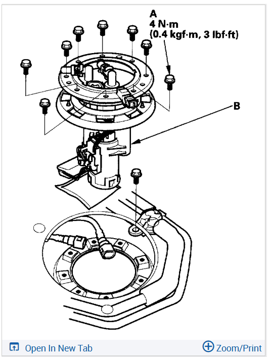

The car idles fine but whenever the accelerator is pressed the engine stalls out and dies. I changed the fuel pump and injectors, but I don't have the right tool to check fuel pressure. I can't figure it out

It does sound like the fuel pump is weak but lets run the codes to see if any are stored? This guide can help
The fuel pump is not that expensive and easy to change, FYI. Here is how in the images below. Also, you can check for bad gas which the car can have if it has been sitting for a while. Check out the images (below). Let us know how it goes.
