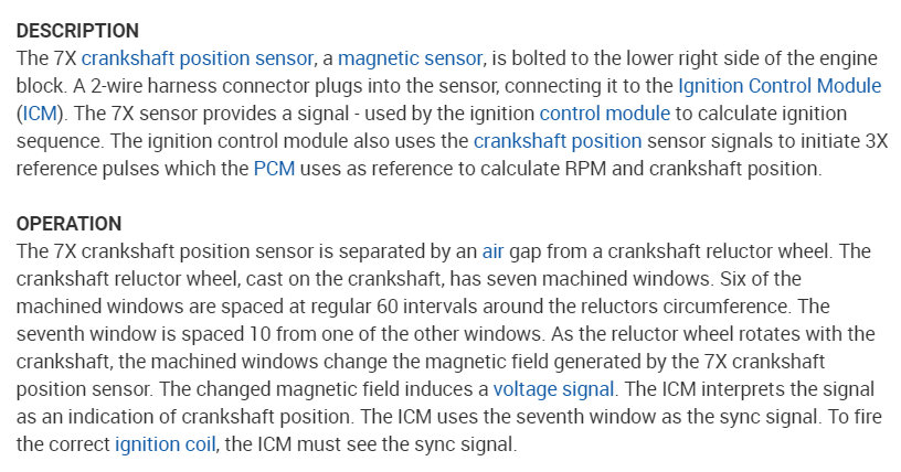

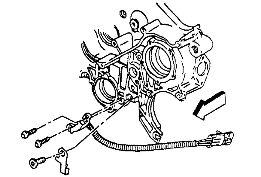

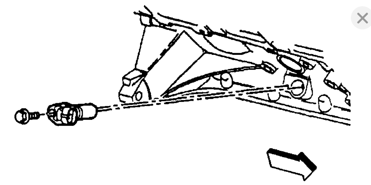

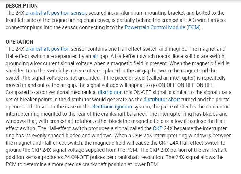

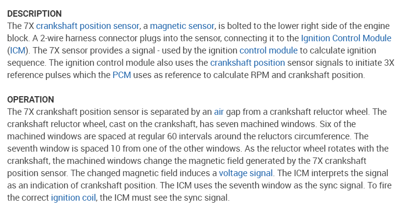

Apr 8, 2019 at 2:49 AM
SCGRANTURISMO
  • 4,897 POSTS
Hello again,
I forgot to put these diagrams in my reply last time. I am sorry about that. They are in the diagrams down below. Also there are two different types of CKP's fro your vehicle, so not knowing which your vehicle has, I included them both for you. As always, if you have any other automotive type questions, please do not hesitate to ask us. That is what we are here for.
