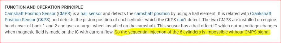

There are a number of things that could cause this. I attached a guide of things that we need to think about.
Not only does your engine use a crankshaft position sensor to determine engine position but it uses the cam sensors as well. If one of these fails it could cause the engine to shut off with no codes.
https://www.2carpros.com/articles/engine-stalls
Unfortunately, each of these items in this guide will need to be monitored with a scan tool to determine the issue. Without a little more detail as to what is happening with them, it would just be a guess as to what the issue is.
