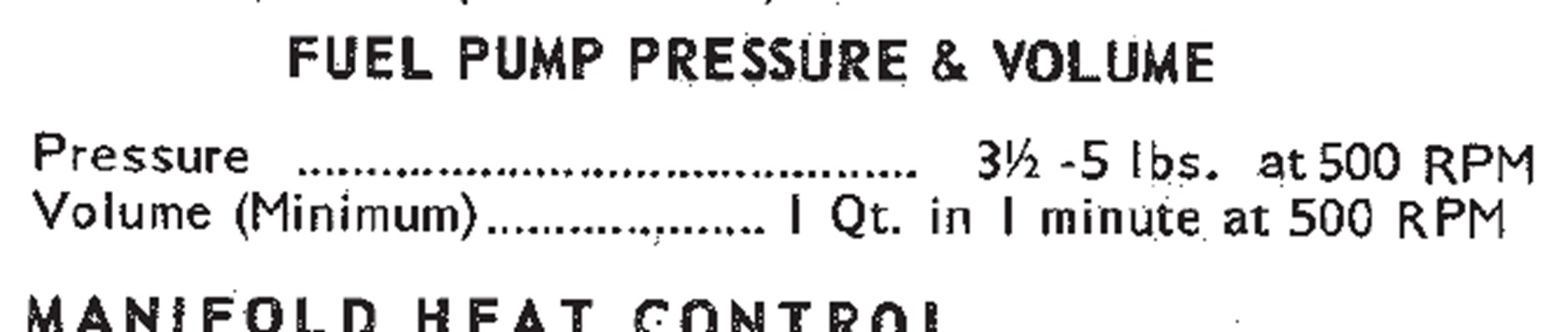

The car runs great when it is in park and idling or stepping on gas in park. Once you put it in drive and go about a quarter to half a mile the car will quit, like turning the car off. It seems the more you drive the more it does it. Now, What I have replaced,Carburetor, fuel pump, starter relay, and voltage regulator.

Yes, it does fire back up, it still has the points and condenser. Put on the new carburetor, first than the fuel pump after it died. The first new fuel pump lasted about 2 weeks. The 2nd pump didn't have enough p.s.i. 1.4. this is when I started having running problems, I noticed that the fuel pump was not keeping the clear gas filter full of gas so changed out the fuel pump again to a 1.8 p.s.i. pump. STILL DIES! I read on the web that it might be the starter relay or the voltage regulator put no go!

fuel pressure on this as well as volume is in pic and from your description is to low. also the ground wire for dist shold go from one of the screws that hold the points to either the plate just below or on the side of dist housing. if you don't have that it won't run because it can't complete the circuit. timing shold be about 8-10 but that can be checked as long as it doesn't spark knock. a bad voltage regulator will not stop a Chrysler product from running, not charging yes but nothing to do with running. also Chrysler's used to have a fuel filter on the rubber hose that came from tank to fuel pump, it may be a clogged filter or the hose is sucking together giving you the low pressure. those are cheap items to fix.
