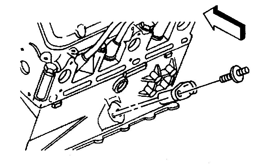

Car shuts off at red lights or of parked and idling for to long but eventual starts up
2003 BUICK CENTURY
70,000 MILES • 3.3L • V6 • 2WD • AUTOMATIC
ERODRIGUEZ24
no check engine light no anti theft light any more I by passed it with a resistor because the wire to the the ignition switch was cut. I hve already replaced fuel pump, IAC valve,PC valve,fuel pump relay,Maf air flow sensor,manifold running control valve,cleaned throttle body, throttle position sensor. Can any one help? any ideas?

Other than at an idle, does it run good? Have you checked for engine vacuum leaks? Have you checked to see if fuel pressure drops off when it stalls? Does it immediately start after this happens? Have you checked the crankshaft position sensor to see if the engine loses an RPM signal when it stalls?
You have replaced a lot already. My first suspect is a vacuum leak. These engines are known for intake leaks. Lets start with that. Here is a link that shows how to test:
Next, a bad crankshaft position sensor symptom is the engine will just stall at an idle and not set a code. Take a look through this link.
If you find the sensor is the issue, here is a link that shows in general how one is replaced.
Here are the directions specific to this vehicle. There are two different designs. I will include both The attached pics correlates with these directions.
REMOVAL PROCEDURE
pic 1
1. Turn the steering wheel fully to the left.
2. Raise and support the vehicle. Refer to Lifting and Jacking the Vehicle.
3. Remove the right tire and wheel.
4. Disconnect the crankshaft position (CKP) sensor electrical connector.
5. Remove the CKP sensor bolt.
6. Remove the CKP sensor.
7. Inspect for wear, cracks, or leakage if the CKP sensor is not being replaced.
INSTALLATION PROCEDURE
1. Lubricate the O-ring with clean engine oil before installation and replace if damaged.
pic 1
2. Install the CKP sensor.
3. Install the CKP sensor bolt.
NOTE: Refer to Fastener Notice in Service Precautions.
Tighten
Tighten the bolt to 11 N.m (97 lb in).
4. Connect the CKP sensor electrical connector.
5. Install the right tire and wheel.
6. Lower the vehicle.
7. Perform the crankshaft position (CKP) system variation learn procedure. See: Vehicle > Programming and Relearning

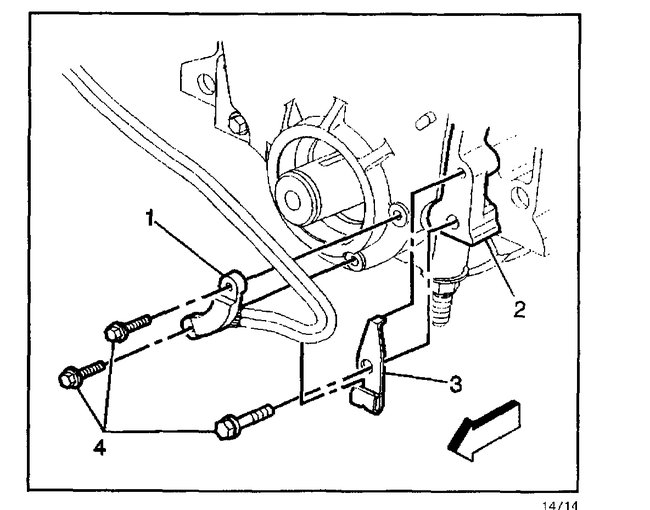

Type 2
CRANKSHAFT POSITION (CKP) SENSOR REPLACEMENT (24X)
REMOVAL PROCEDURE
pic 2
1. Raise and support the vehicle. Refer to Lifting and Jacking the Vehicle.
2. Remove the lower air deflector.
3. Remove the crankshaft balancer.
5. Note the routing of the sensor harness before removal.
6. Remove the harness retaining bolt (4) and the clip (3).
7. Remove the CKP sensor bolts (4).
8. Remove the CKP sensor (1).
pic 2
1. Install the 24X crankshaft position sensor (1) to the front cover.
2. Install the CKP sensor bolts (4).
Tighten
Tighten the bolts to 10 N.m (89 lb in).
3. Install the harness retaining clip (3) and the bolt (4).
Tighten
Tighten the bolt (4) to 10 N.m (89 lb in).
5. Install the CKP sensor harness to the bracket.
6. Install the crankshaft balancer.
7. Install the lower air deflector.
8. Lower the vehicle.
9. Perform the crankshaft position (CKP) system variation learn procedure. See: Vehicle > Programming and Relearning
