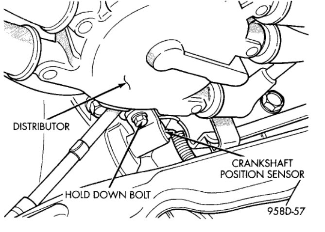

When I am driving down the road my truck will shut off and everything turns off and five to ten seconds later it will restart by itself. The last time this happened when it restarted and I kept going it had a big backfire.
Oct 22, 2017 at 4:34 AM
  • 55,766 POSTS

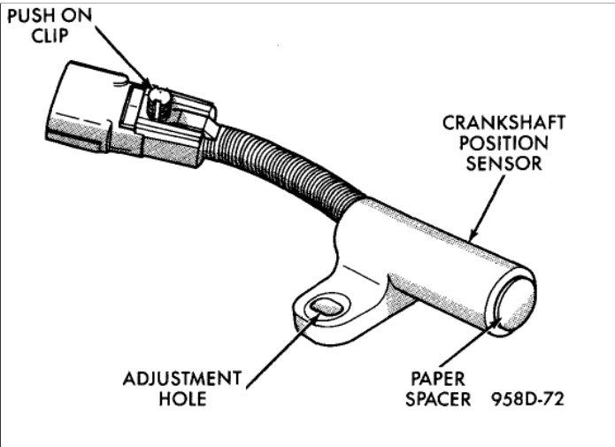

This sounds like a classic crankshaft angle sensor problem which may or may not leave a trouble code. Here is a guide to help us get an idea of what you are in for when doing the job.
and
Here are some diagramm of what it will be like on your car (below)
Here is a generic guide that can shed some light on the subject as well.
https://www.2carpros.com/articles/engine-stalls
