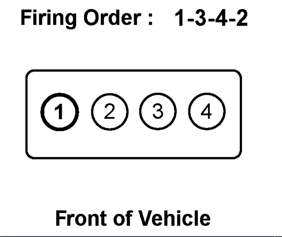

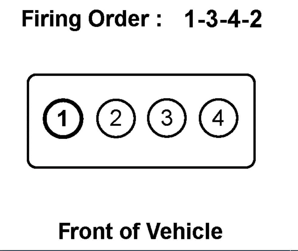

If the spark plug wires are arcing, that is causing the problem. Where are they arcing from? Are you able to move them away from the area to see if the vehicle runs better? Are all the wires doing this?
Let me know. The arcing wires certainly are causing misfires. Let's get that fixed and then see what other issues there are. Also, make sure the plug wires are installed to the correct cylinders. The firing order needs to be correct. See pic 1 below.
Let me know what you find.

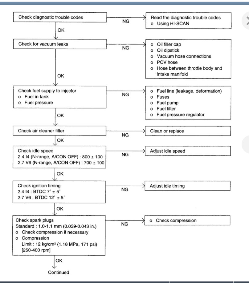

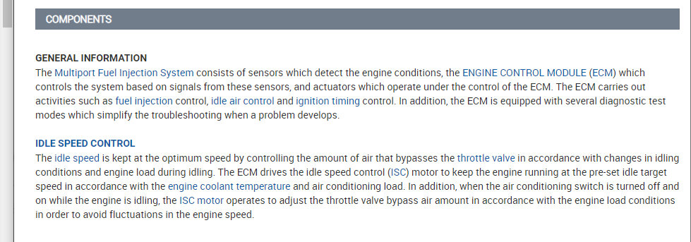

The most likely cause of this is the idle control device.
https://www.2carpros.com/articles/idle-air-control-valve-service
I attached the info below on how it works on this vehicle but also the testing that we need to run through in order to confirm this is a throttle control issue.

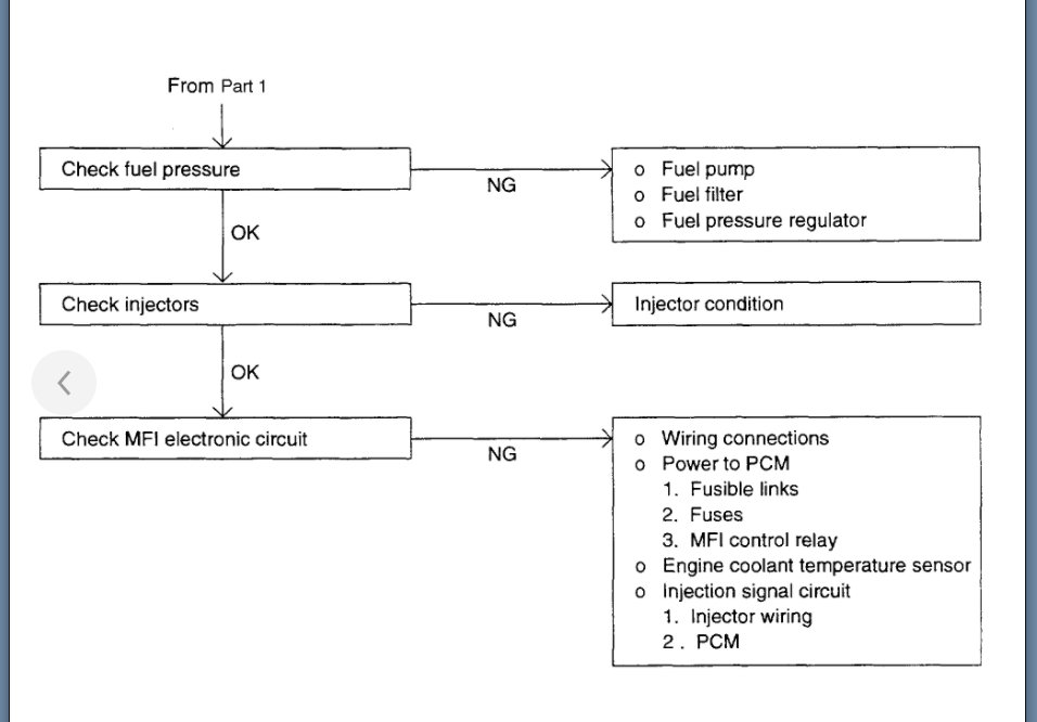

You will need to check the fuel pressure so here is a guide that will help with this as well:
Please run through this flow chart below and let us know where you end up with it and that should get us on the right path.

Hi, since I posted my question I went to AutoZone and have them do a check. The first thing we replaced was the cam sensor and we are yet to replace the coolant temperature sensor which is the codes that they read. we want to know if the coolant temperature sensor can make the car idle up and shut off? because it controls the computer for the injector system supposedly. thank you so much for all your help.
Sep 3, 2021 at 1:16 AM
It is unlikely. The coolant temperature sensor can cause idle issues but it won't cause it to shut off. However, the easiest way to check this is to unplug it and run the vehicle. If it runs normally then it is the issue as the PCM will switch to a preprogramed set of data when it looses a signal from the sensor.
Let us know what happens with that and we can move on. Thanks
