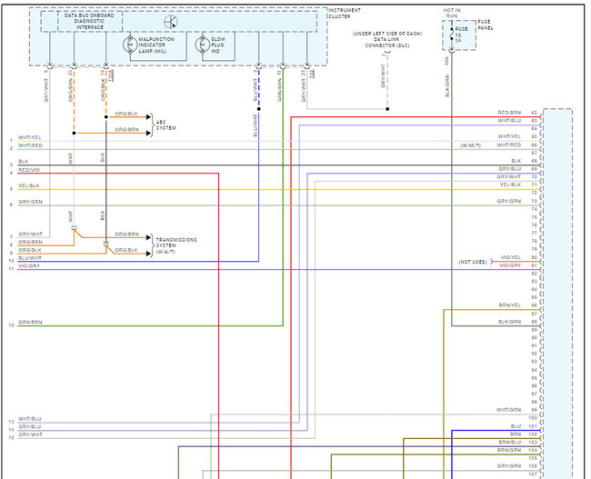

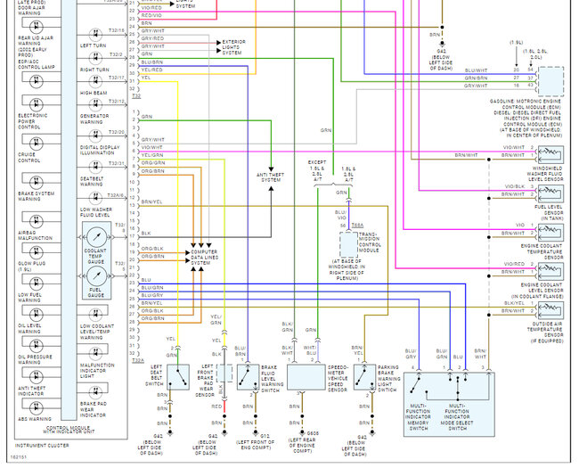

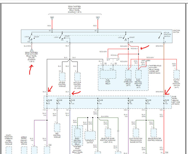

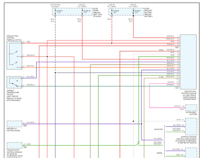

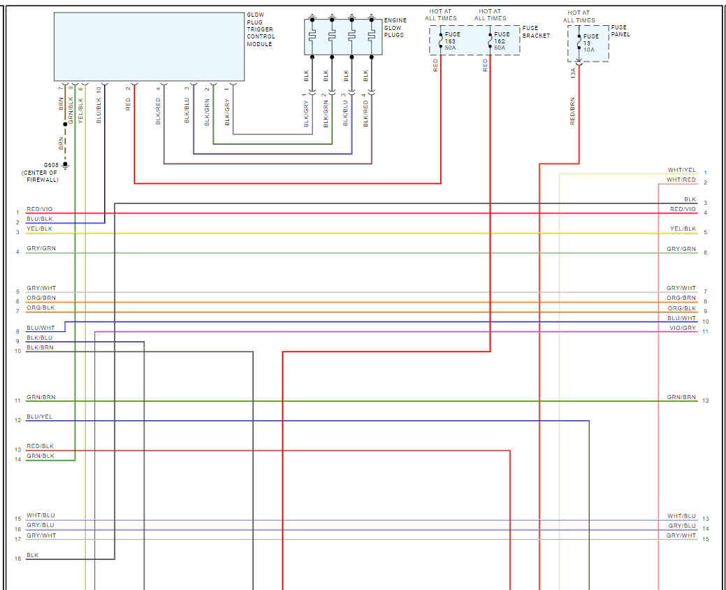

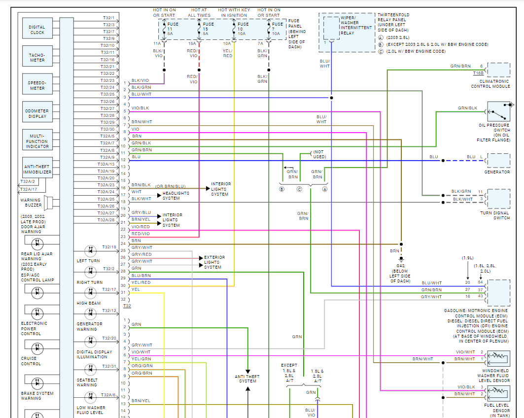

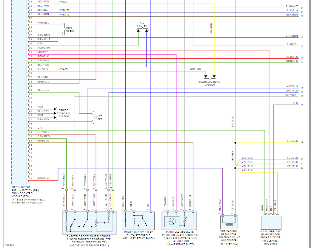

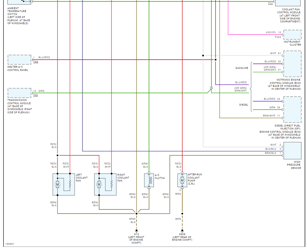

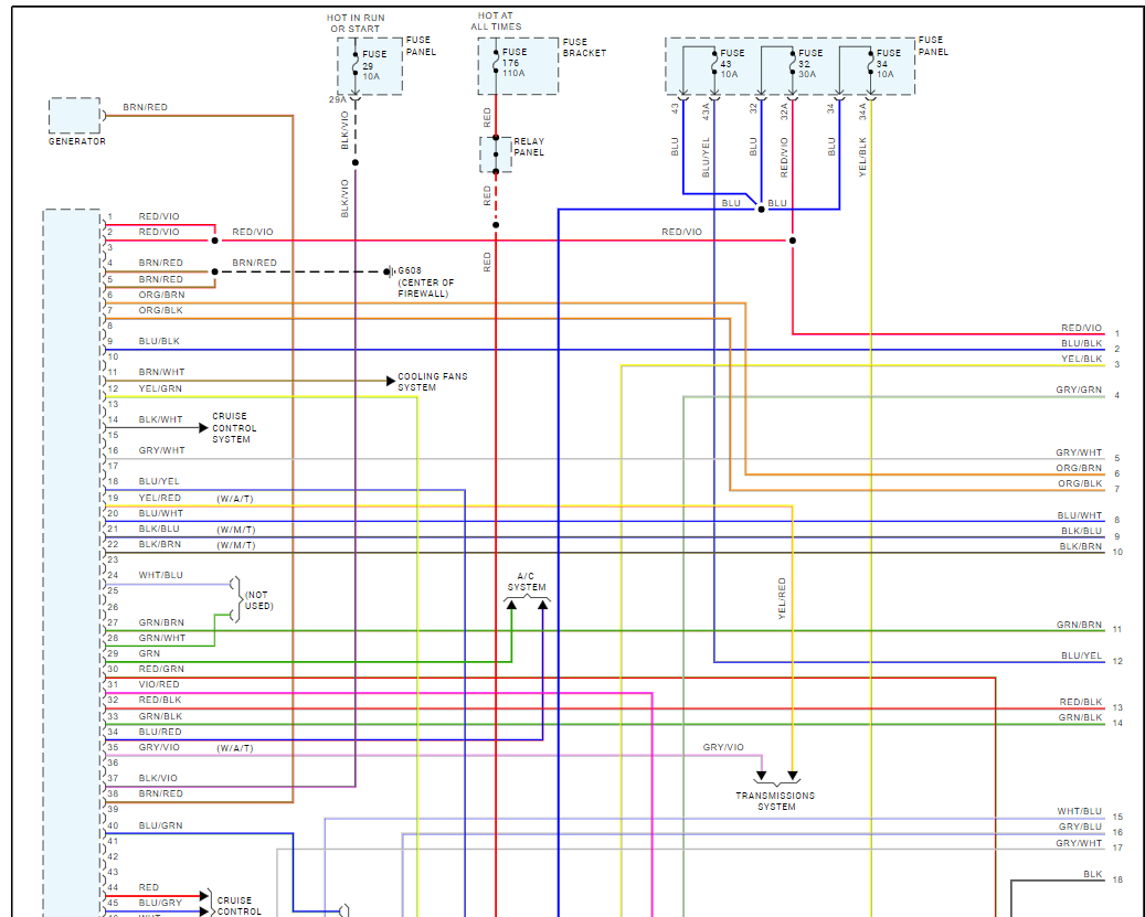

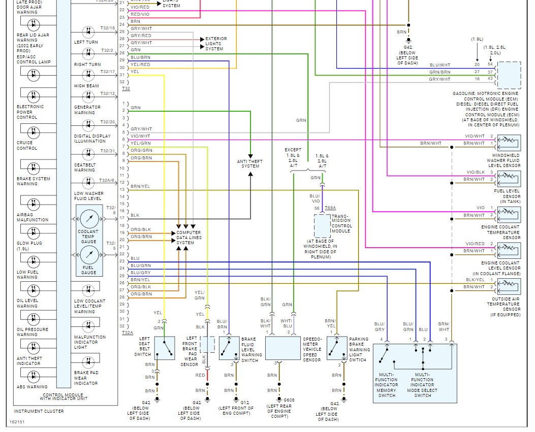

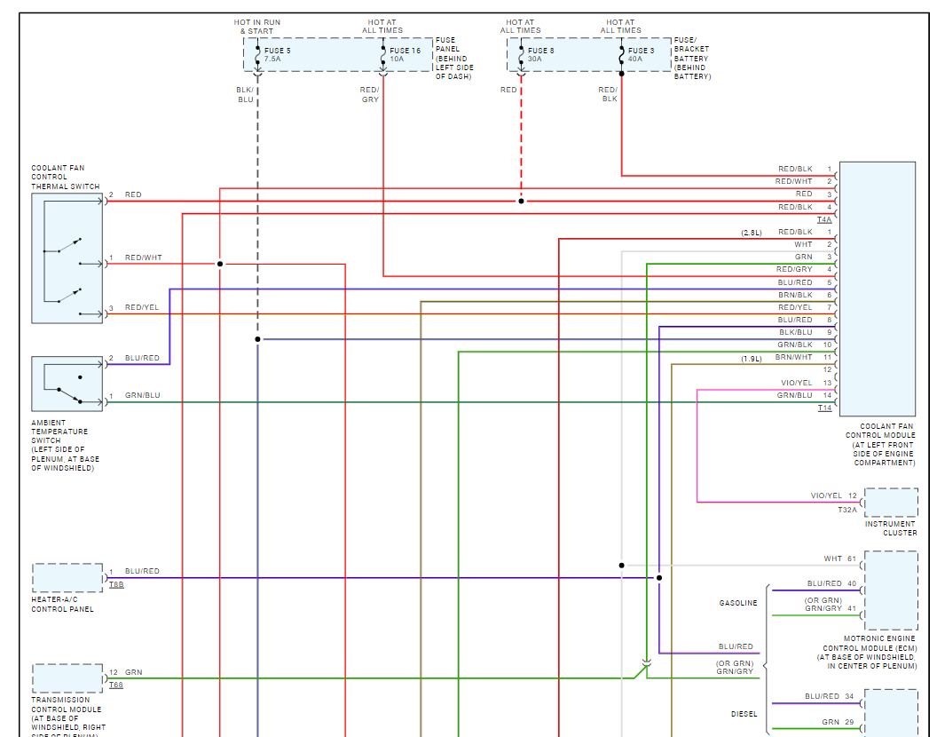

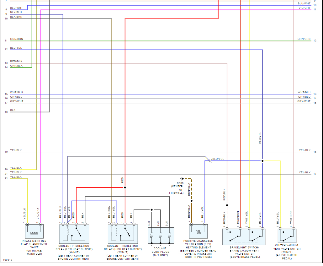

instrument cluster goes blank, radio and interior lights go out, coolant fans stay on, and engine shuts off after my son busted a wheel and tire on the right side. replaced tire and wheel after a few days problem started, checked grounds at steering wheel, and ignition switch, wiggled and engine dies replaced ignition electrical part and problem still exists, need help possible pictures of grounds and power for ECM and instrument cluster schematics. please
Aug 25, 2024 at 4:32 AM
  • 55,402 POSTS

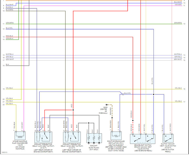

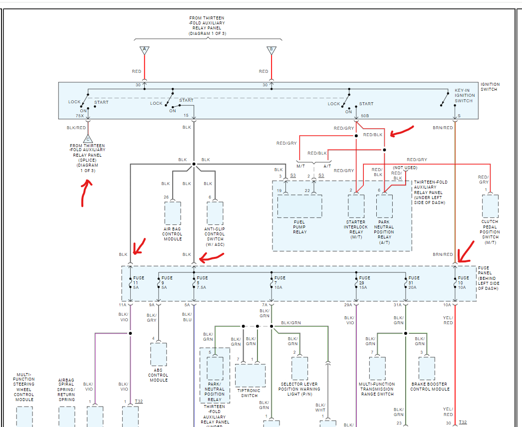

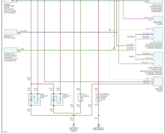

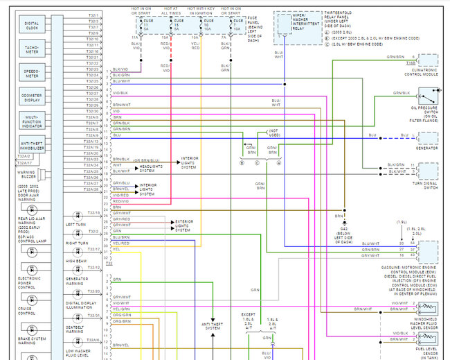

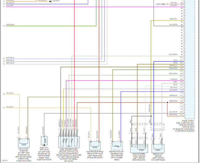

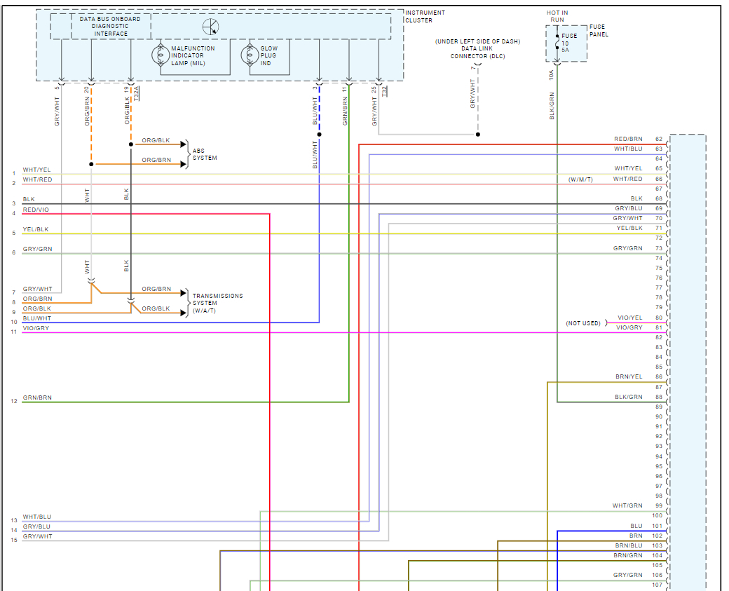

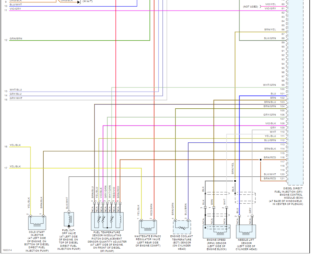

Yep, that is a good one, does the engine run with no codes? If so the PCM is probably okay, Here is the instrument panel, cooling fans, PCM wiring diagrams and a guide to help you run tests.
Check out the images (below). Please upload pictures or videos in your response of any problems so we can see what to help you with.

Thank you very much but I found my problem, it was a broken stud on the fuse holder on top of the battery red wire next to the one going to the alternator. hopefully this will help you guys in resolving electrical issues for someone else. have a great rest of your weekend bye.
