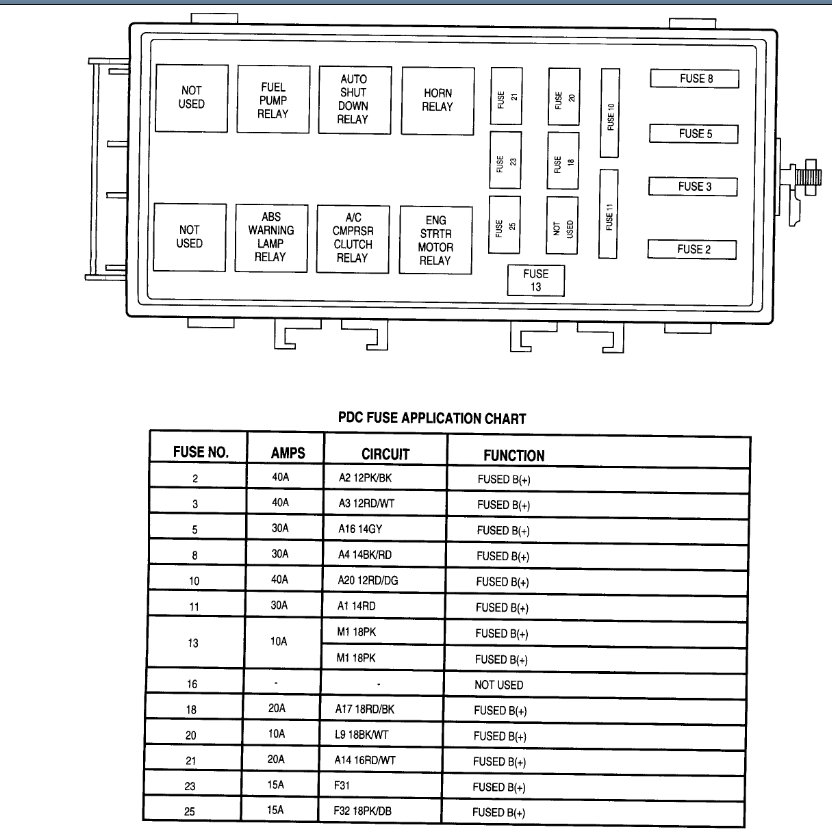

I drive it for about 1 hour and it stalls, let it sit for about 10 minutes and it will start up again. The engine compartment was very hot, but the gauge says it's okay.

Are there any codes in the system? We should run the codes to see what comes up. This guide can help but it sounds like auto shutdown (ASD) relay needs to be replaced.
here is the location under the hood in the images below so you can check it out.
and
