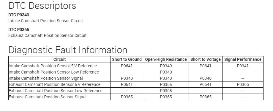

Sounds like it's not getting spark. Engine light is on and the codes are p0340 and p0365. Changed both camshaft sensors and the crankshaft sensor. No change at all.

This could be a wiring issue. All the diagnostics point to a wiring issue.

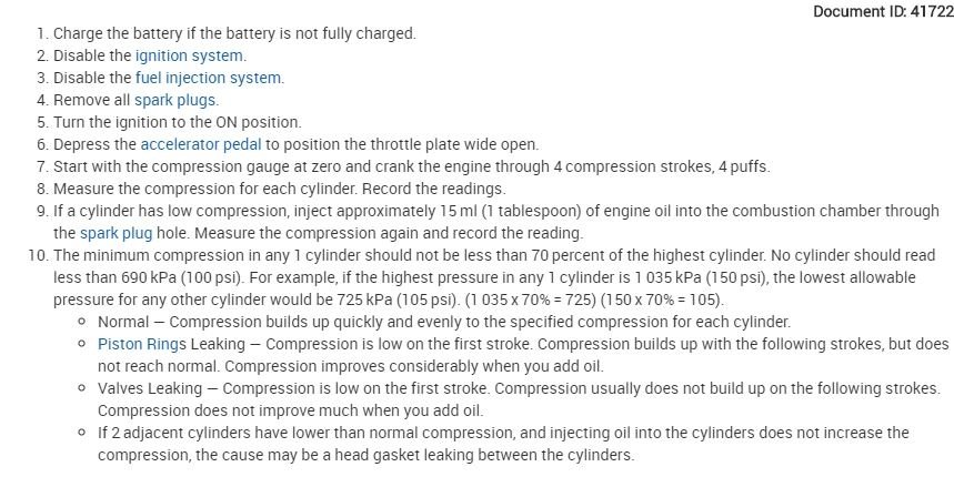

I would do a compression test to make sure the timing chain has not failed.
