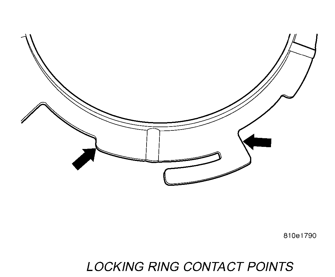

6. Remove Fuel Pump Module lock ring.
Locking Ring Contact Points
picture 1
NOTE: Use a brass punch to remove the 1/4 turn lock ring. Make contact only at the points.

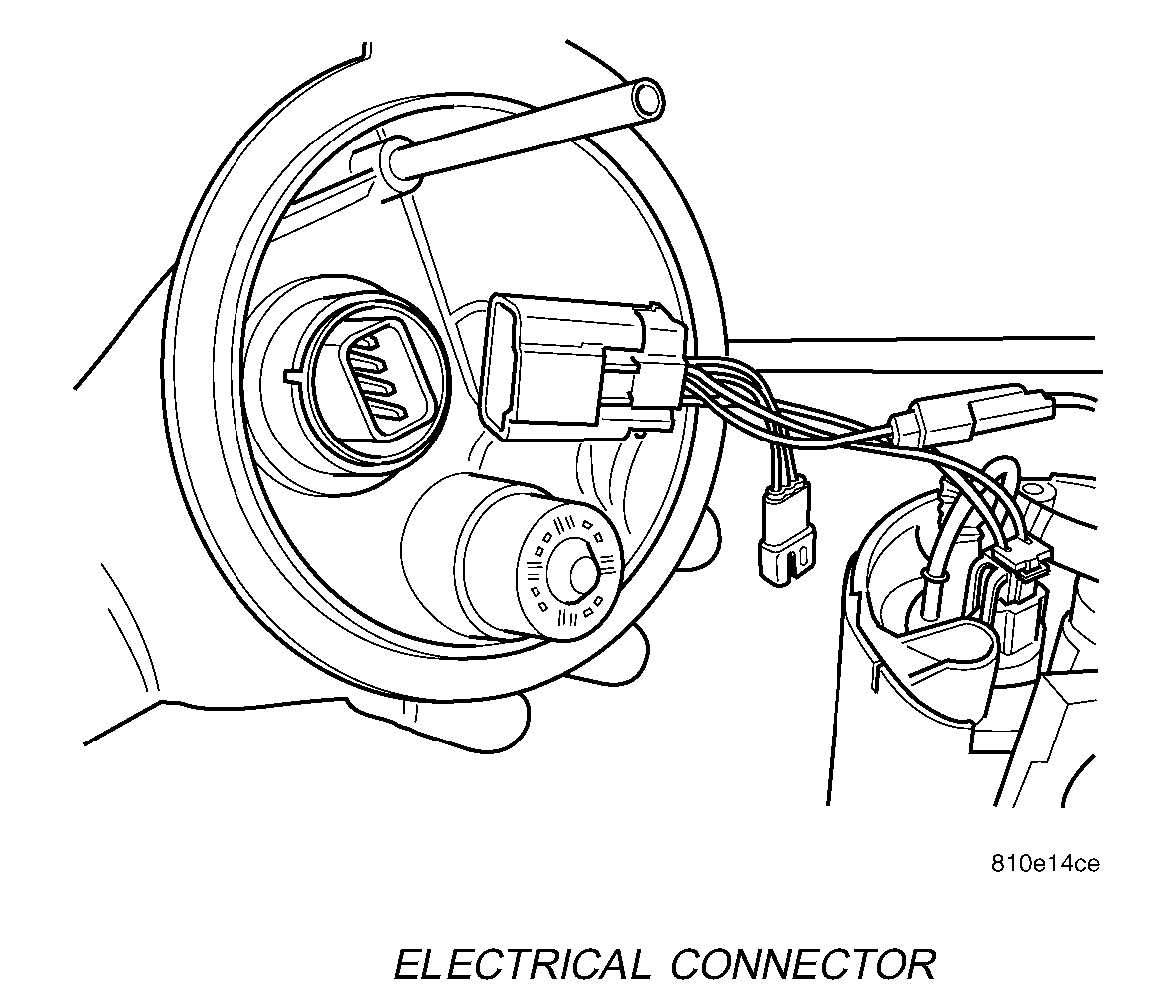

Electrical Connector
picture 2
9. Disconnect electrical connector.

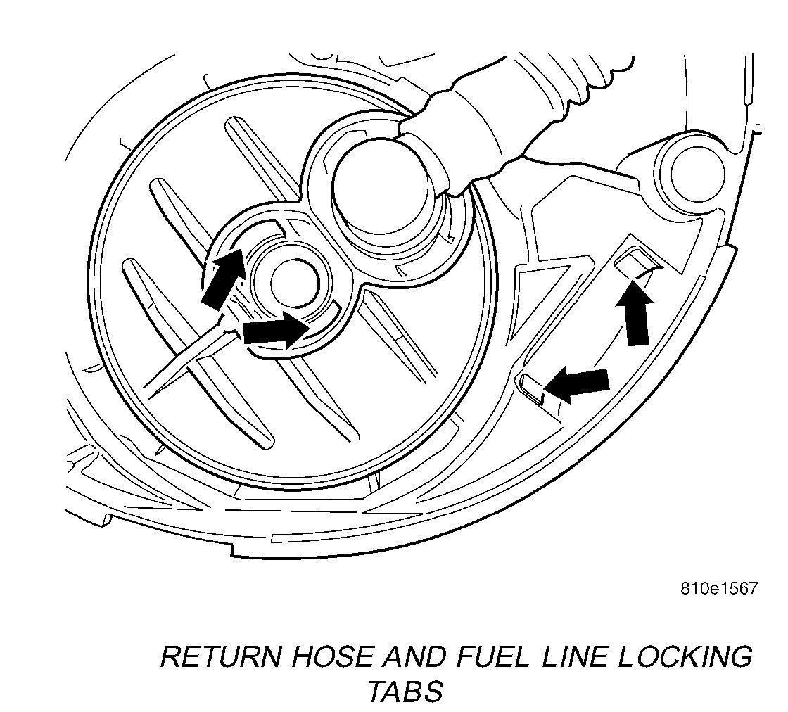

Return Hose And Fuel Line Locking Tabs
picture 3
11. Tab location in fuel pump module for return line and fuel supply line.

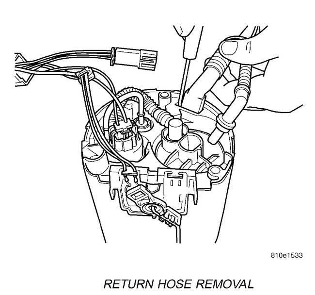

Return Hose Removal
picture 4
12. Remove return line from pump module. Use a small screwdriver to pry tab back and tip hose to one side. Pry tab on other side back to release hose.
CAUTION: Care should be taken to not crack/break the locking tabs or supply line fitting.
13. Remove fuel line from top of the pump module. Use a small screwdriver to pry tab back and tip hose to one side. Pry the tab on other side back to release hose.

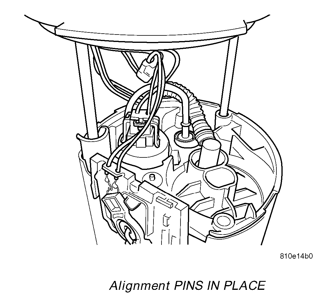

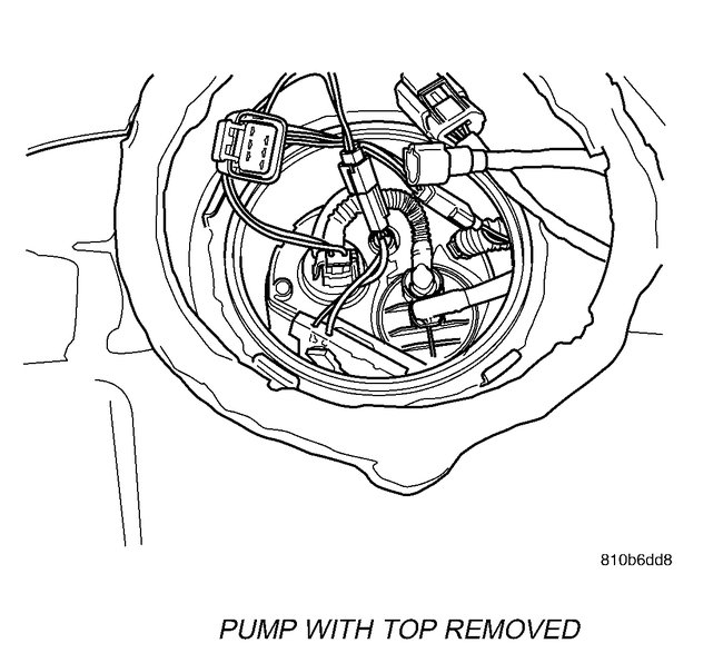

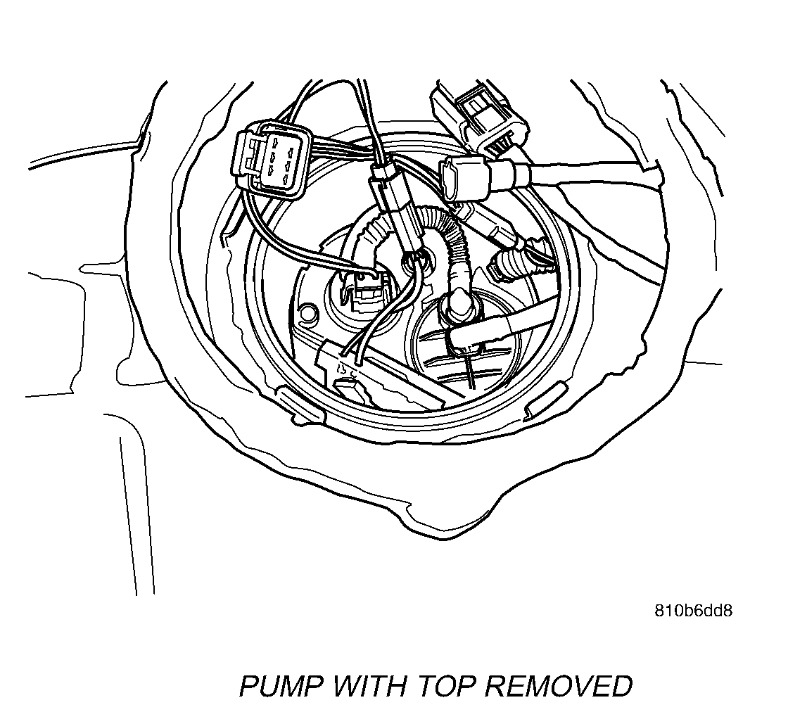

Pump With Top Removed
picture 5
2. Connect siphon and fuel line to fuel pump module.
3. Connect fuel pump electrical connector to bottom of module top.
4. The wire connector to the passenger side level sensor needs to be connected.

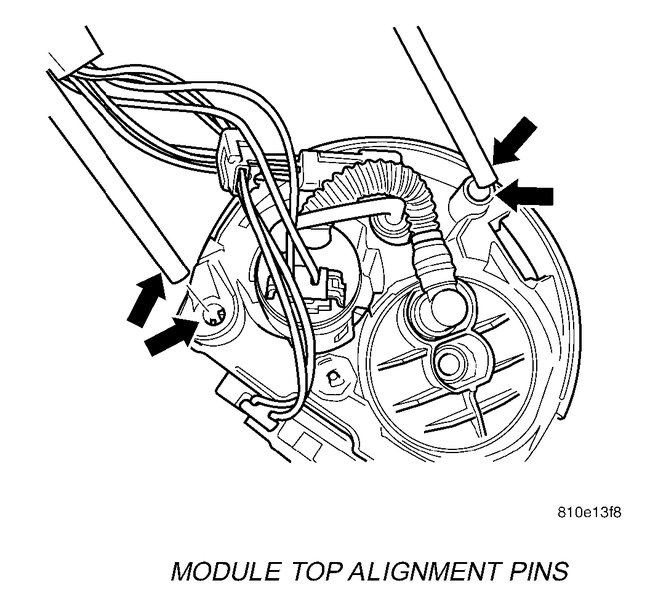

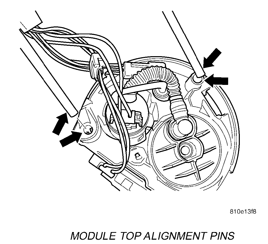

Module Top Alignment Pins
picture 6
Alignment Pins In Place
picture 7
5. Install fuel pump module top to module.
6. Install Fuel Pump Module gasket and lock ring.
NOTE: Use a brass punch to install the 1/4 turn lock ring.

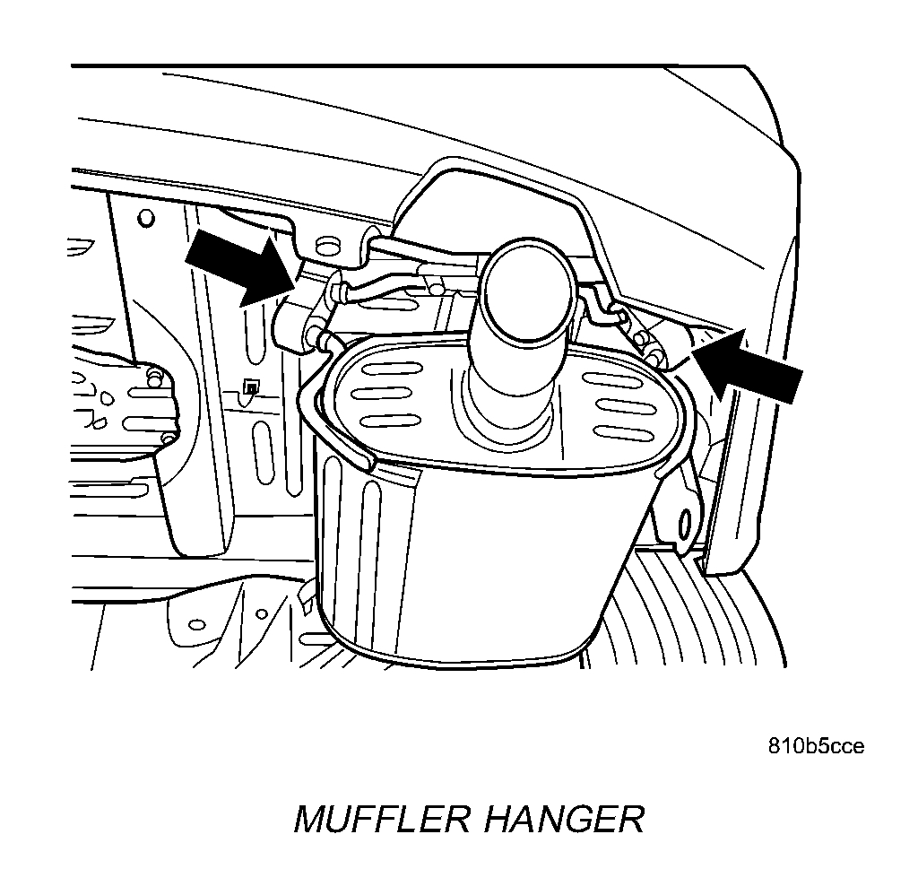

Muffler Hanger
picture 8
7. Remove muffler hanger rubber garments.

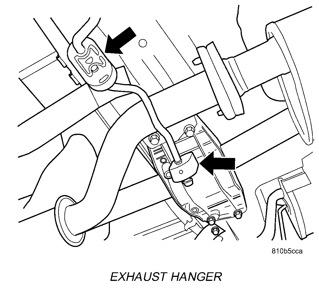

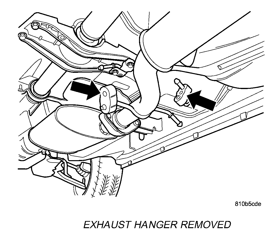

Exhaust Hanger
picture 9
Exhaust Hanger Removed
pic 10
8. Remove the center exhaust hanger rubber grommets.

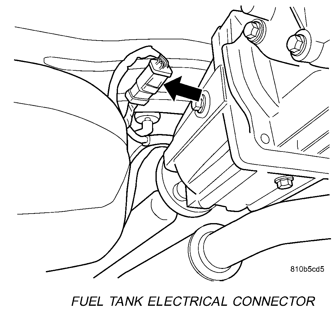

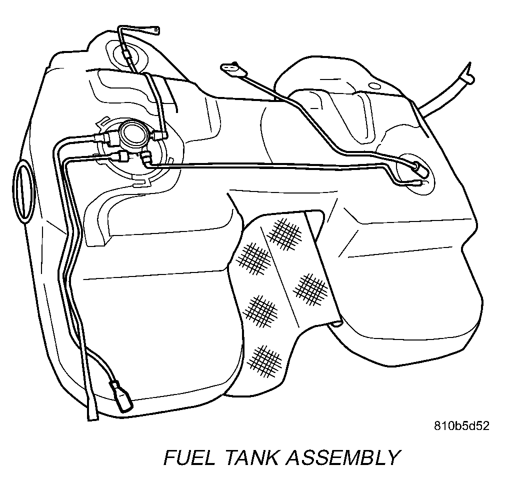

Fuel Tank Electrical Connector
picture 11
10. Disconnect the fuel tank electrical connector.

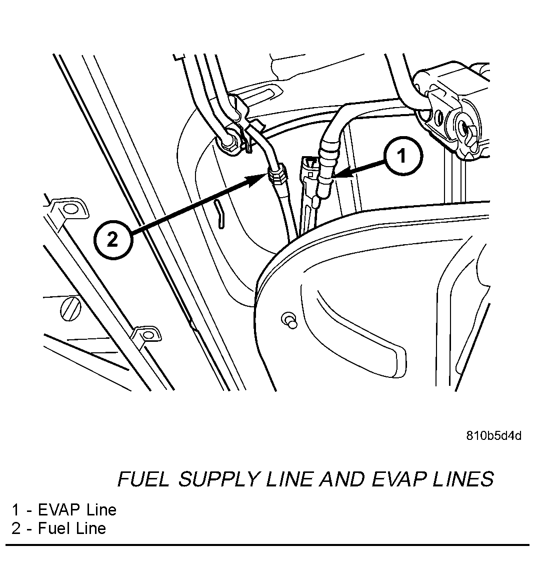

Fuel Supply Line And EVAP Lines
picture 12
11. Disconnect the fuel line and EVAP line.

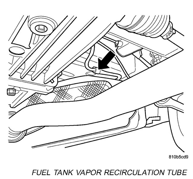

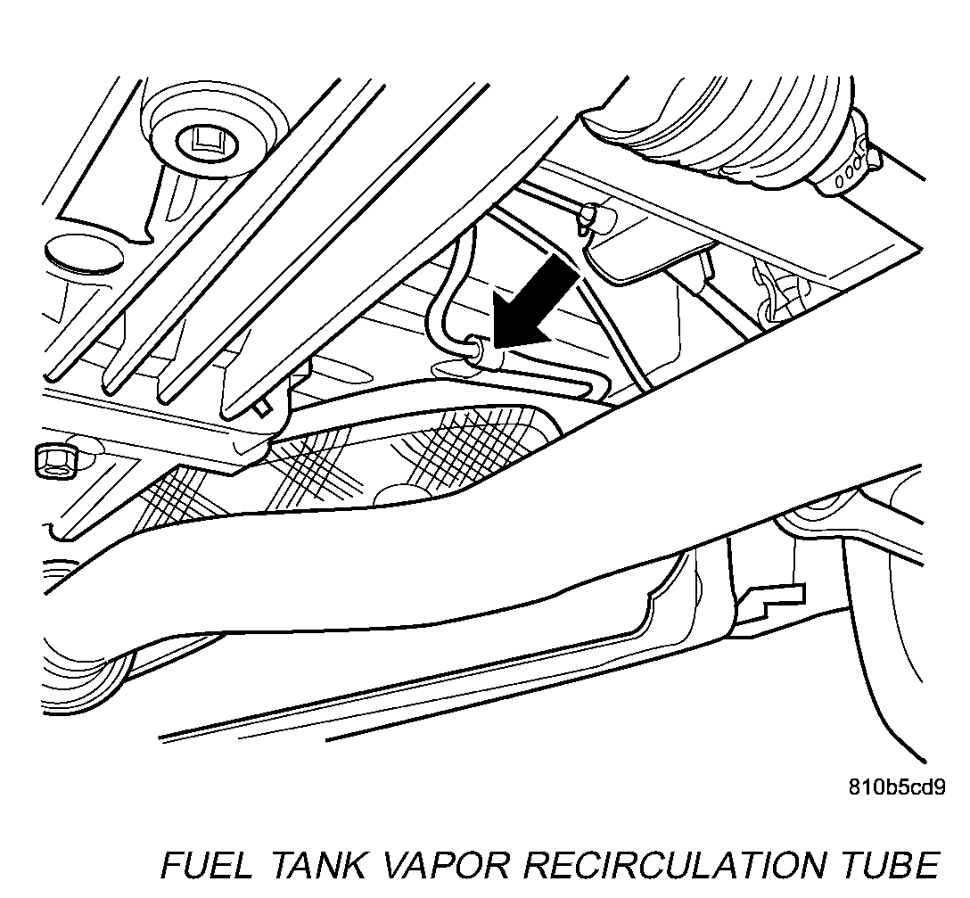

Fuel Tank Vapor Recirculation Tube
picture 13
12. Disconnect the vapor recirculation tube.

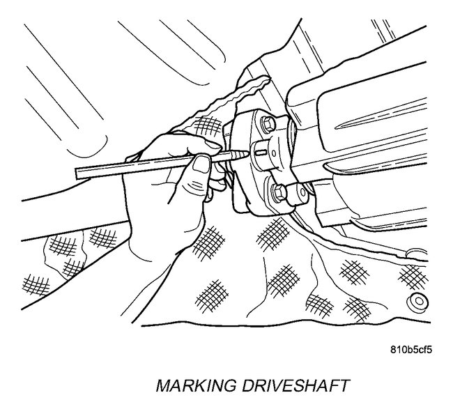

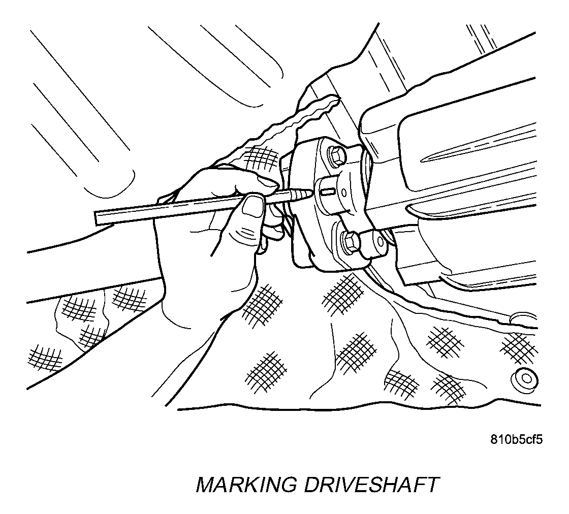

Marking Driveshaft
picture 14
13. Mark the driveshaft rear connection.

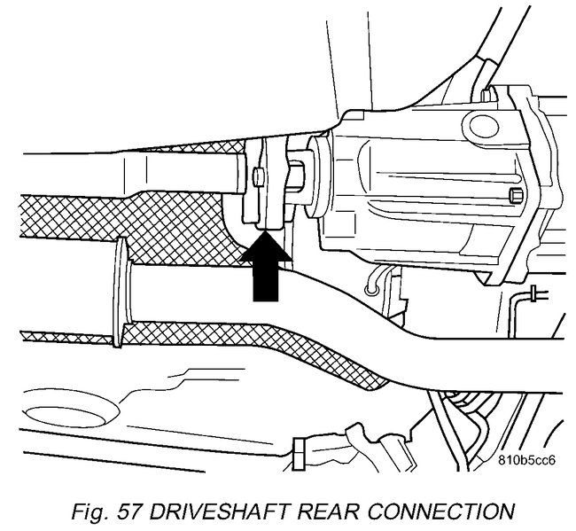

Driveshaft Rear Connection
picture 15
14. Disconnect the driveshaft rear connection.

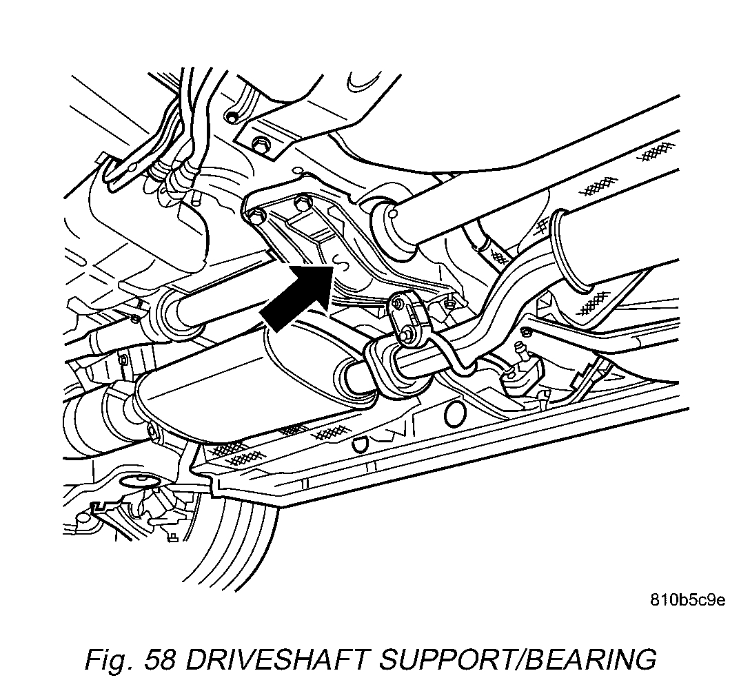

picture 16
15. Remove the driveshaft support/bearing.

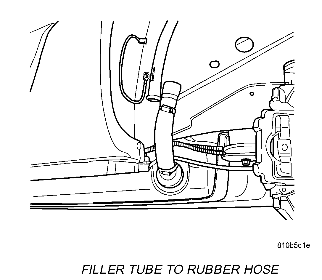

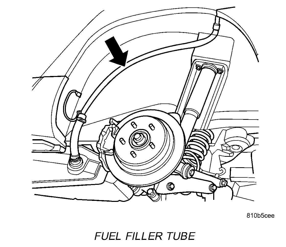

Fuel Filler Tube
picture 17
Filler Tube To Rubber Hose
pic 18
18. Remove the fuel filler tube from the rubber hose at fuel tank.

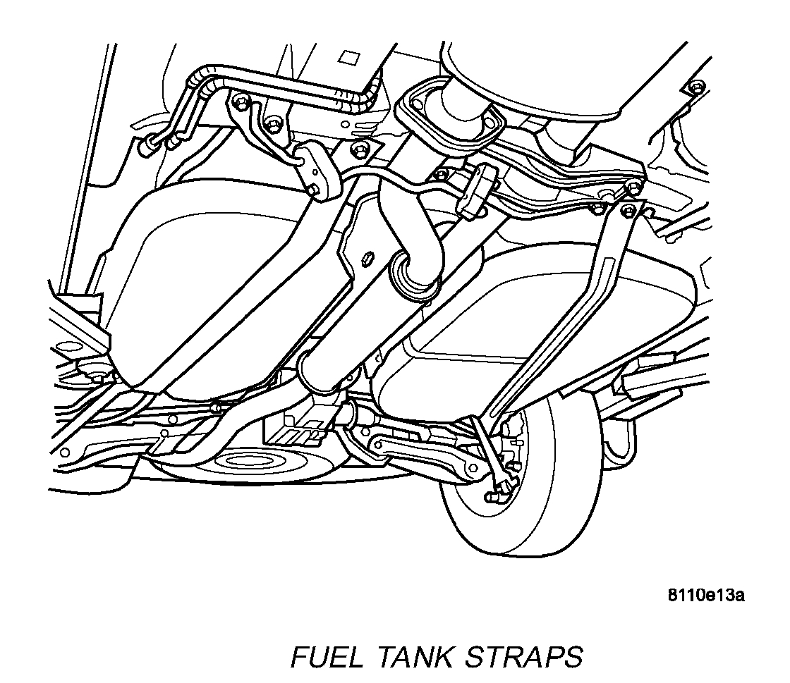

Fuel Tank Straps
picture 19
20. Remove the 2 fuel tank straps.
21. Lower fuel tank
22. Drain Fuel Tank, use an approved GASOLINE draining station.

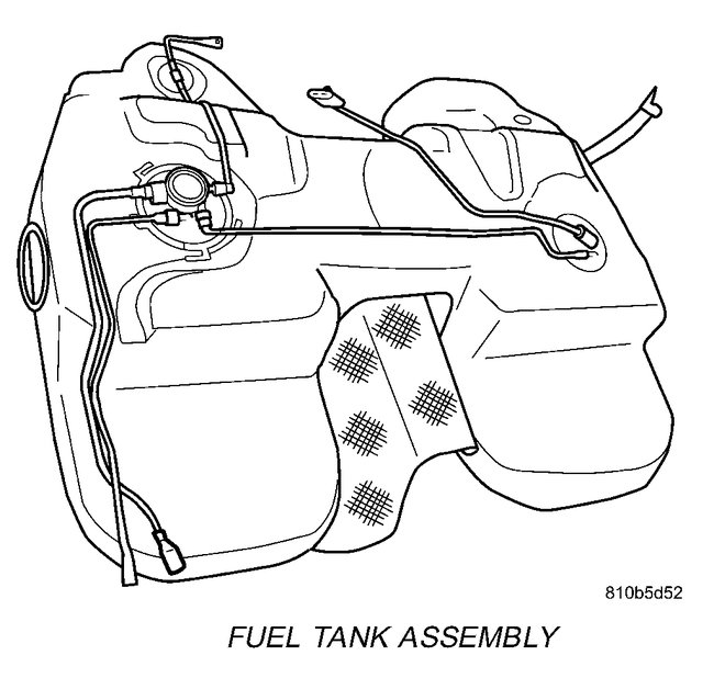

Fuel Tank Assembly
picture 20
23. Remove tank from vehicle.

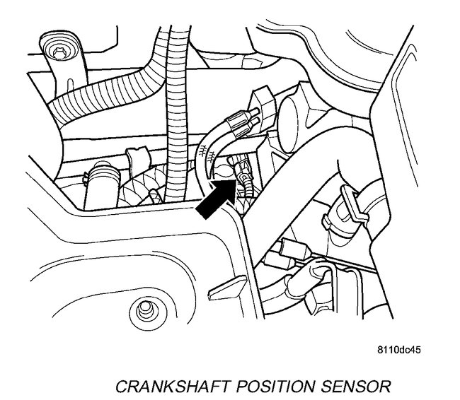

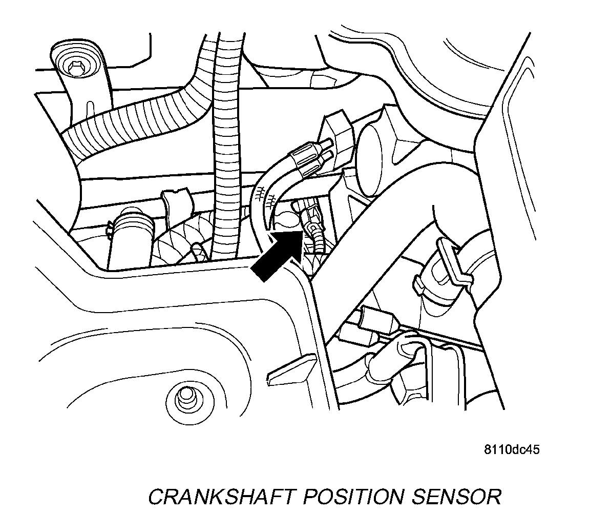

If the fuel pressure isn't an issue, then you need to check for spark to the plugs. Here is a link that shows how it is done:
If there is no spark, my first suspect is the crankshaft position sensor. Take a look through these links:
https://www.2carpros.com/articles/how-a-crank-shaft-angle-sensor-works

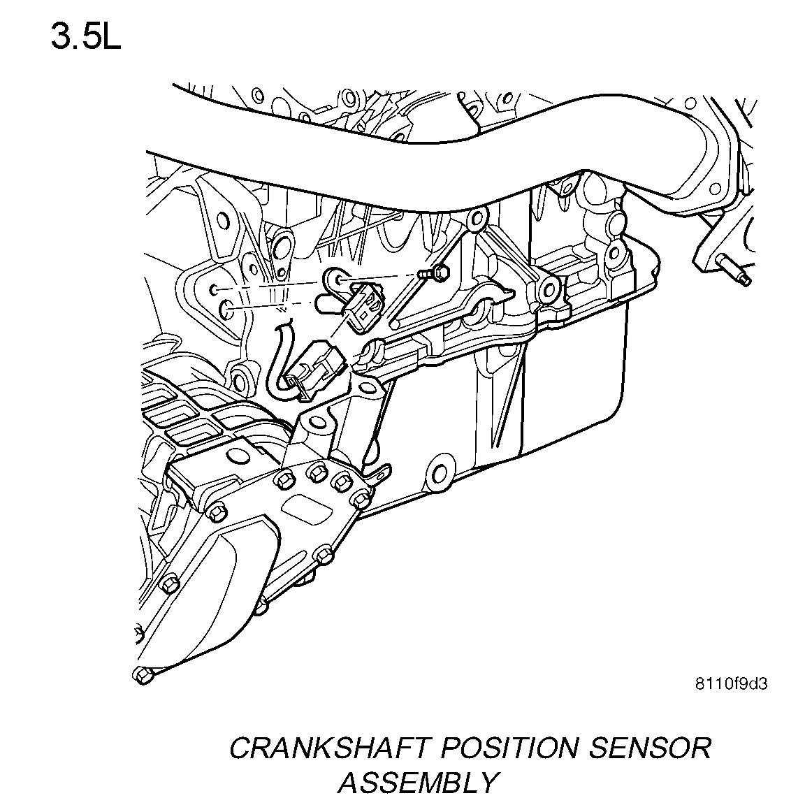

Here are the directions specific to replacing the sensor for your vehicle. The last two pictures correlate with this procedure.
REMOVAL
Crankshaft Position Sensor
Picture 21
The crankshaft sensor is located on the driver side of the vehicle, above the differential housing. The bottom of the sensor sits above the drive plate.
1. Disconnect the negative and positive battery cable.
2. Remove the battery.
3. Unlock and disconnect electrical connector from crankshaft position sensor.
4. Remove sensor mounting screw. Remove sensor.
INSTALLATION
Crankshaft Position Sensor Assembly
Picture 22
1. Install sensor and push sensor down until contact is made with the transmission case. While holding the sensor in this position, install and tighten the retaining bolt to 12 N.m (105 in. lbs.) torque.
2. Connect electrical connector and lock to crankshaft position sensor.
3. Install battery.
4. Connect the positive then the negative battery cable.

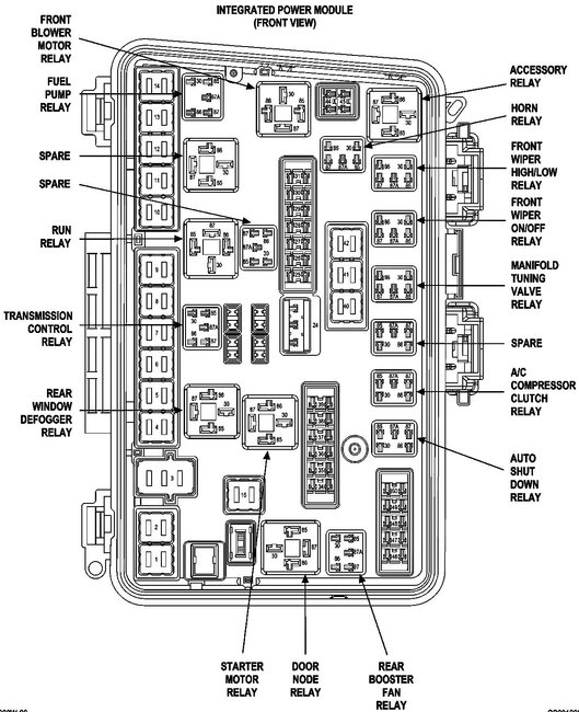

At that mileage, with the full tank of gas, I'd put money on a failed fuel pump. The most accurate way to confirm would be to run a fuel pressure test. You can borrow the necessary gauge from the local parts stores. Here's our general guide on that process: https://www.2carpros.com/articles/how-to-check-fuel-system-pressure-and-regulator

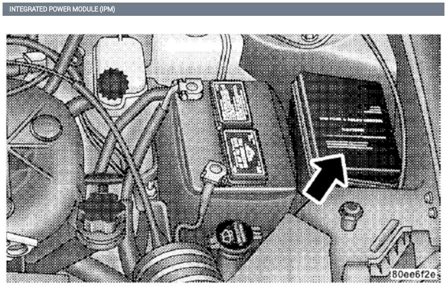

Actually, now that I think about it, try checking your fuses first. I'm trying to look up more specific information, but I'm having some technical issues over here. I'm attaching what I was able to dig up though. There should be more information in your owner's manual, if you have it. If you don't have it, here's a .pdf of it: https://carmanuals2.com/d/31252
And here's our guide on checking fuses: https://www.2carpros.com/articles/how-to-check-a-car-fuse
Let us know what you find and we'll go from there. Good luck!

If it won't fire with starting fluid, my first suspect is the crankshaft position sensor, which is part of the ignition system. We have a couple choices here. First, simply replace the sensor and hope that is the problem, or do further testing.
To test the sensor, my recommendation is to get your hands on a live data scanner. With the scanner, you need to check if there is an RPM signal when the engine is cranking. If there isn't, replace the sensor.
Another thing you could check is to see if there is spark to the plugs. Refer back to my first post for testing for spark and crankshaft position sensor.
If you determine the sensor is bad or just want to try replacing it, here are the directions specific to your vehicle for replacement. The pictures correlate with these directions.
__________________________________
REMOVAL
Picture 1
INSTALLATION
Picture 2
3. Install battery.
