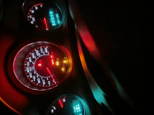

I was driving when my ABS, traction control, and red brake light came on and when I stopped at a light my car just shut off and won't start again. tried to jump it and it didn't help. it won't even make a noise like it's trying to turn over. all the lights and radio just flicker on and off. i'm at a complete loss as to what's happening.

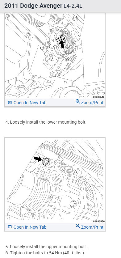

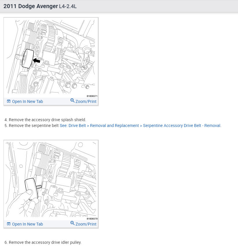

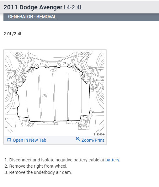

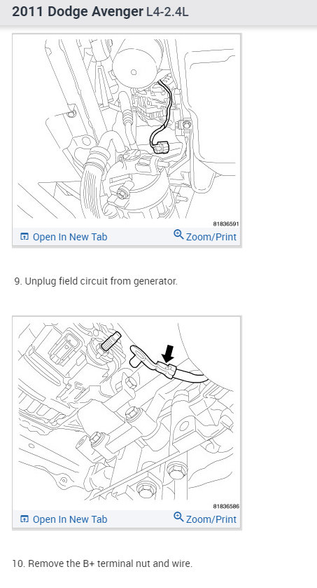

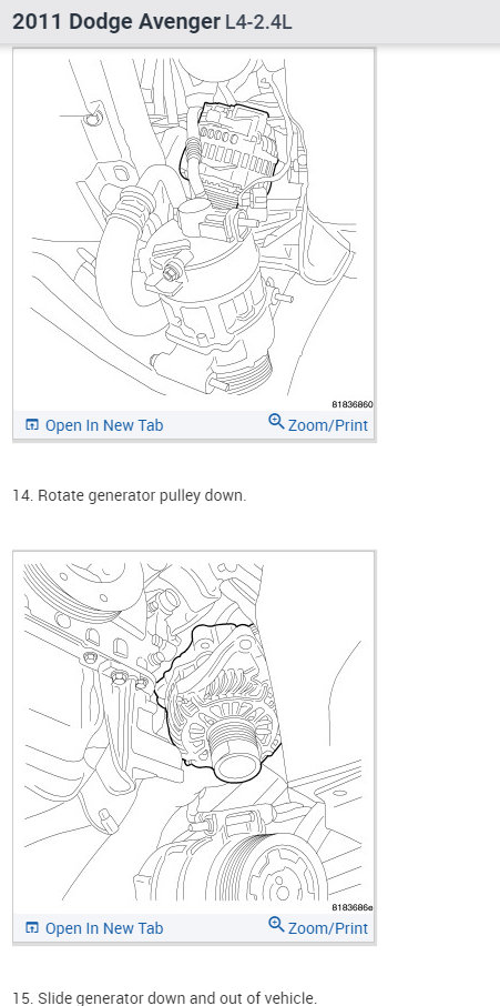

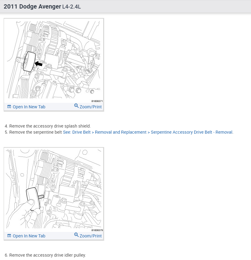

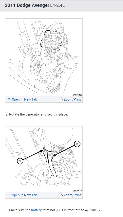

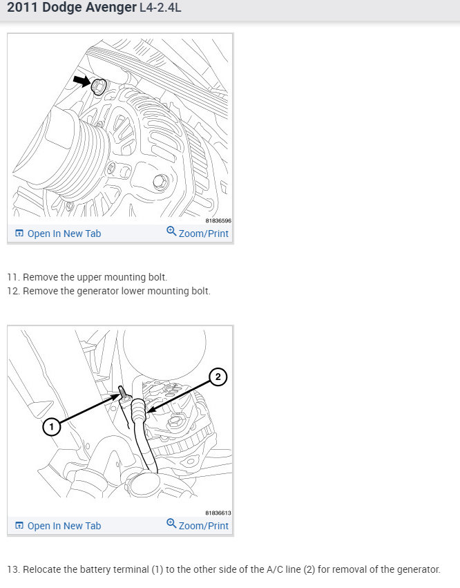

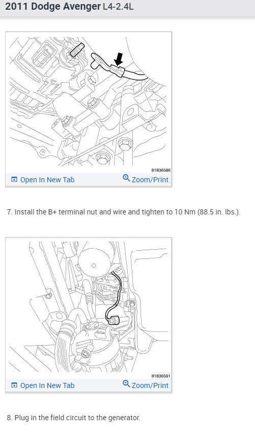

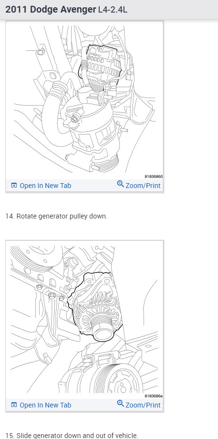

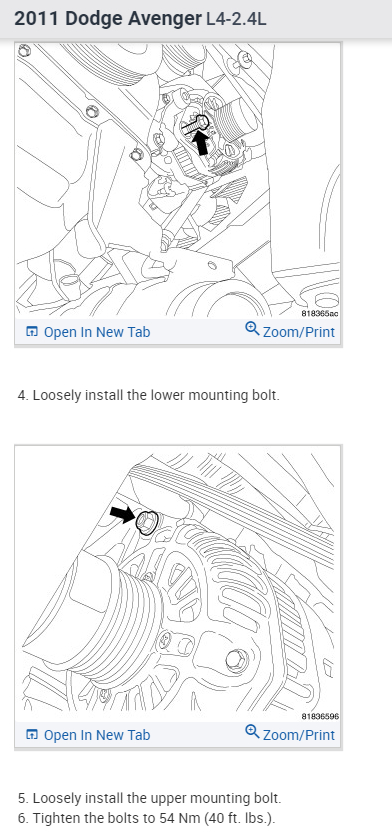

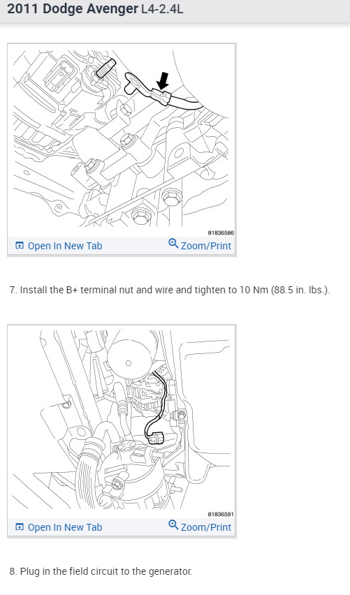

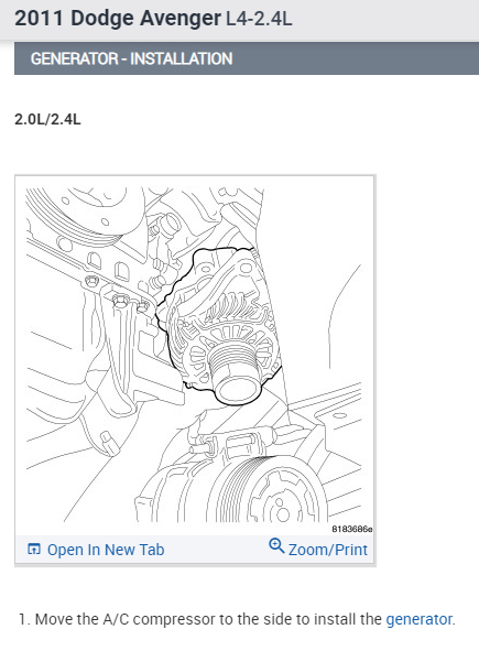

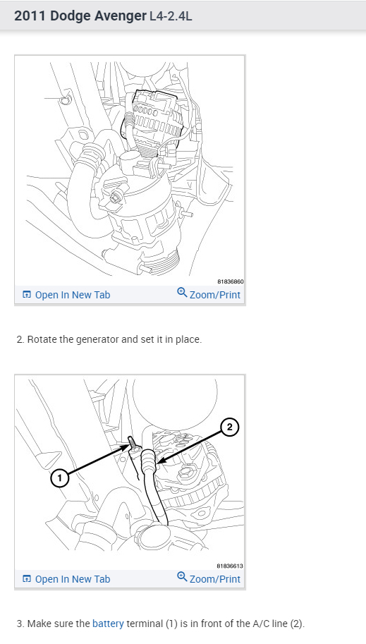

It sounds like you might have a faulty alternator. When the alternator goes bad it will discharge the battery, rather than charging it. And that will stall the engine when you come to a stop. If the discharge is high enough, it can really damage the battery and can make it difficult to even jump start it.
So, it is likely that the battery is bad. You might want to charge the battery if you are able and see if that allows you to start. However, if the alternator is not charging the battery the engine will stall again as soon as the battery gets discharged.
Also, this issue can happen due to wiring issues from the battery to the alternator. So, inspection of the cable is important.
Here are a couple of helpful articles:

These are the lights that come on when I start the car for when they do stay on.
