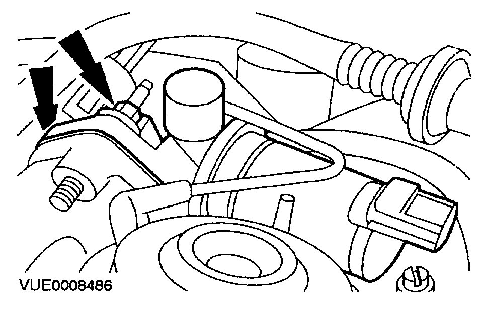

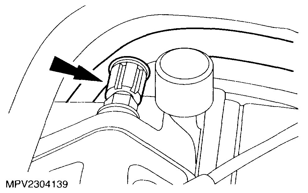

Code read EGR valve with air leak in bank one. But after changing it still cuts off. But if I am drive it does not shut off.
Sep 24, 2018 at 10:19 AM
  • 110,240 POSTS
If the engine is stalling, has the check engine light come back on? If so, have the same codes returned or something different? Have you confirmed there are no engine vacuum leaks? Here is a link that shows how to check:
Next, the idle air control motor (IAC) is responsible for maintaining the engine idle speed. If it is closed and not working, no air will get to the engine until you pressure the gas. Thus, the engine will stall.

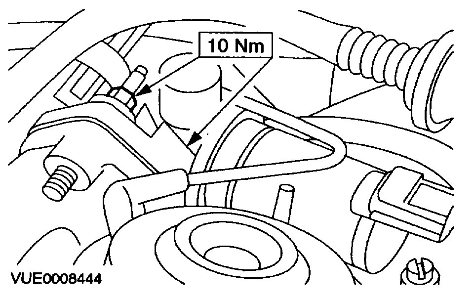

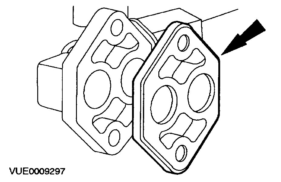

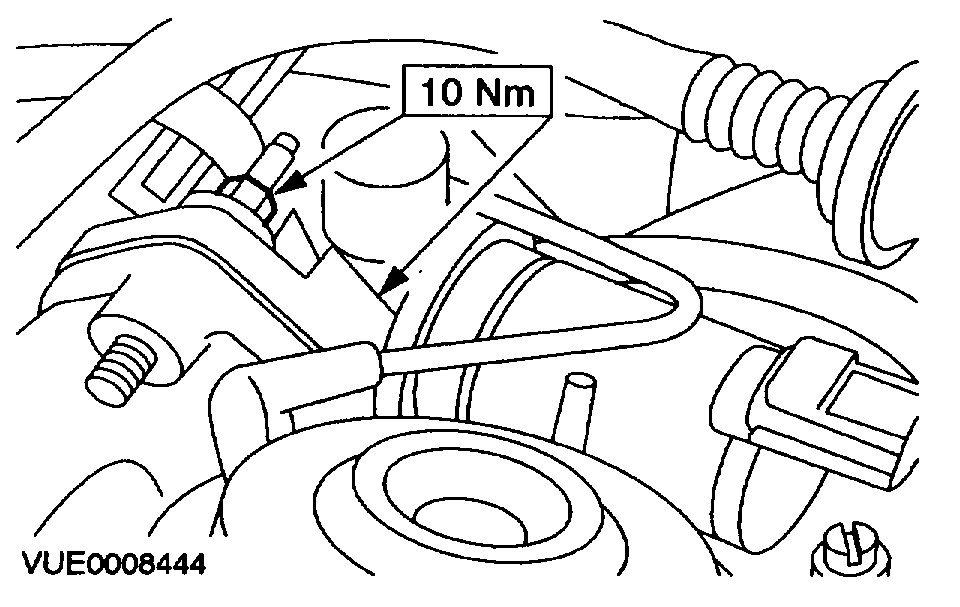

Here are the directions for replacement of the IAC. The first seven pictures correlate with these directions.
REMOVAL
1. Disconnect the vacuum line from the exhaust gas recirculation valve.
2. Disconnect the Idle Air Control (IAC) valve electrical connector.
3. Detach the wiring harness from the IAC valve stud.
4. Disconnect the vacuum supply lines from the upper intake manifold.
5. Remove the IAC valve.
6. Remove and discard the IAC valve gasket.
INSTALLATION
1. To install, reverse the removal procedure.
NOTE: Install a new IAC valve gasket.

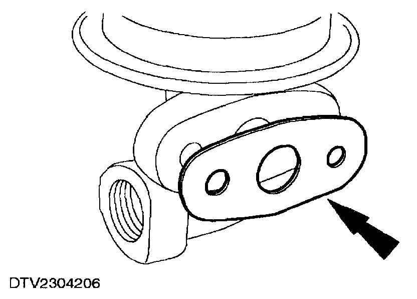

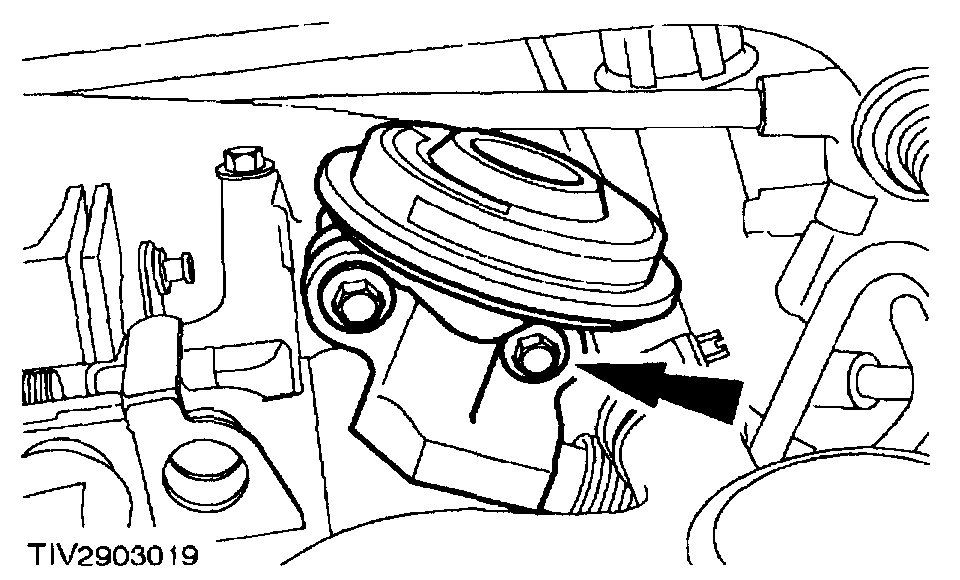

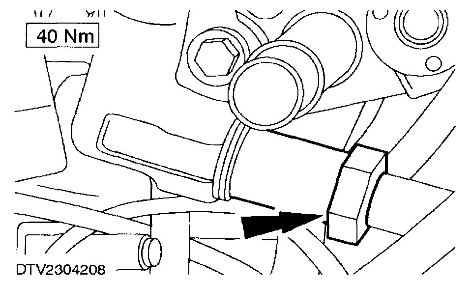

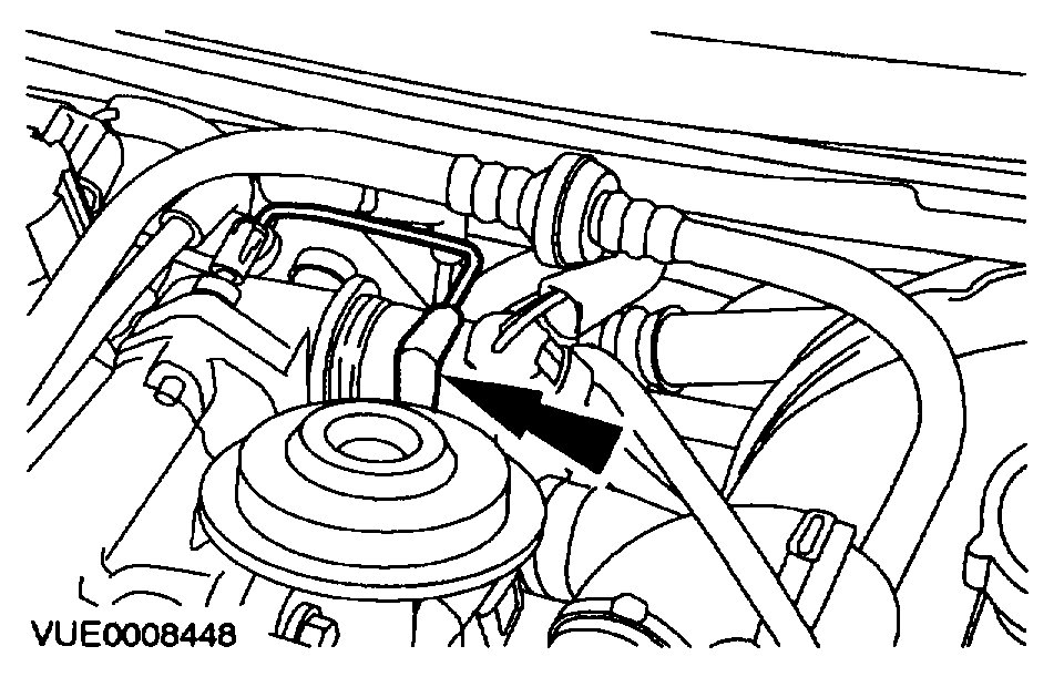

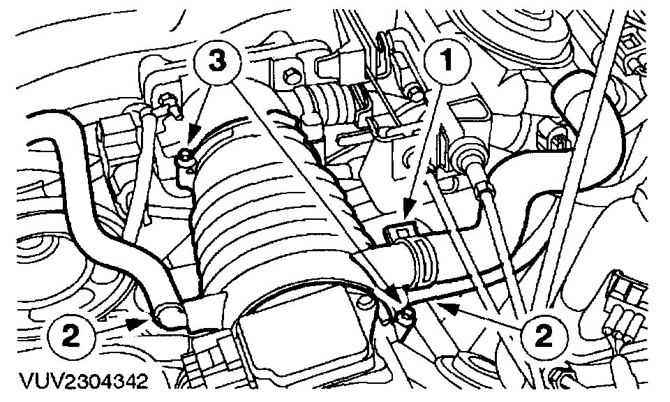

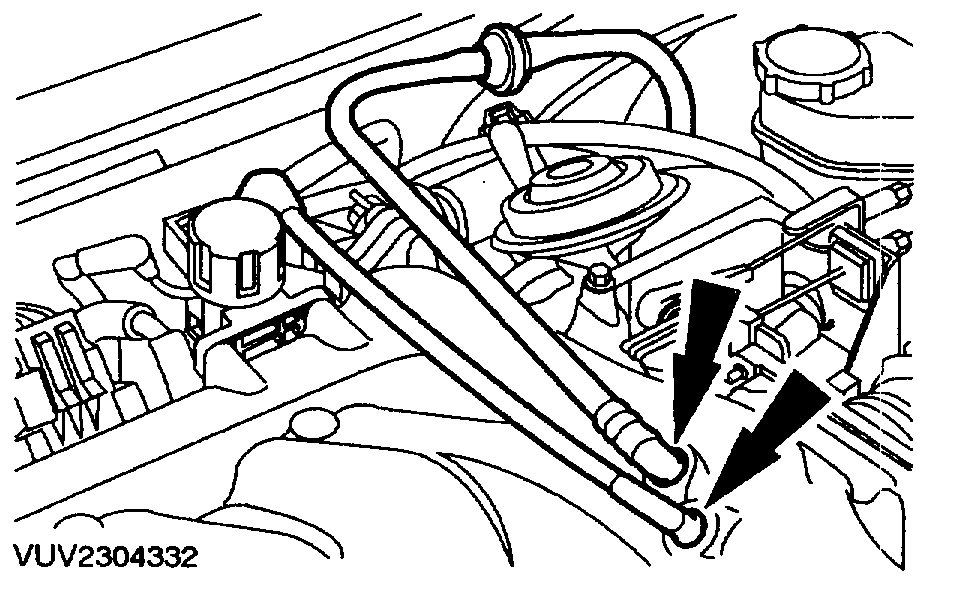

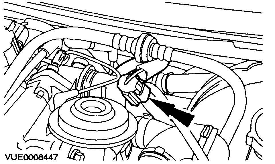

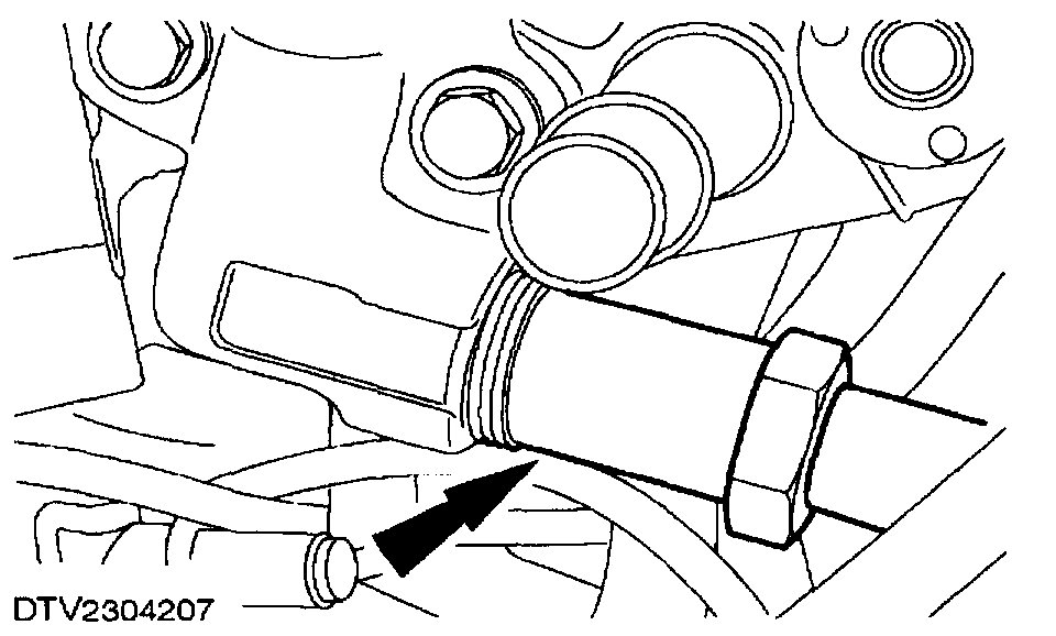

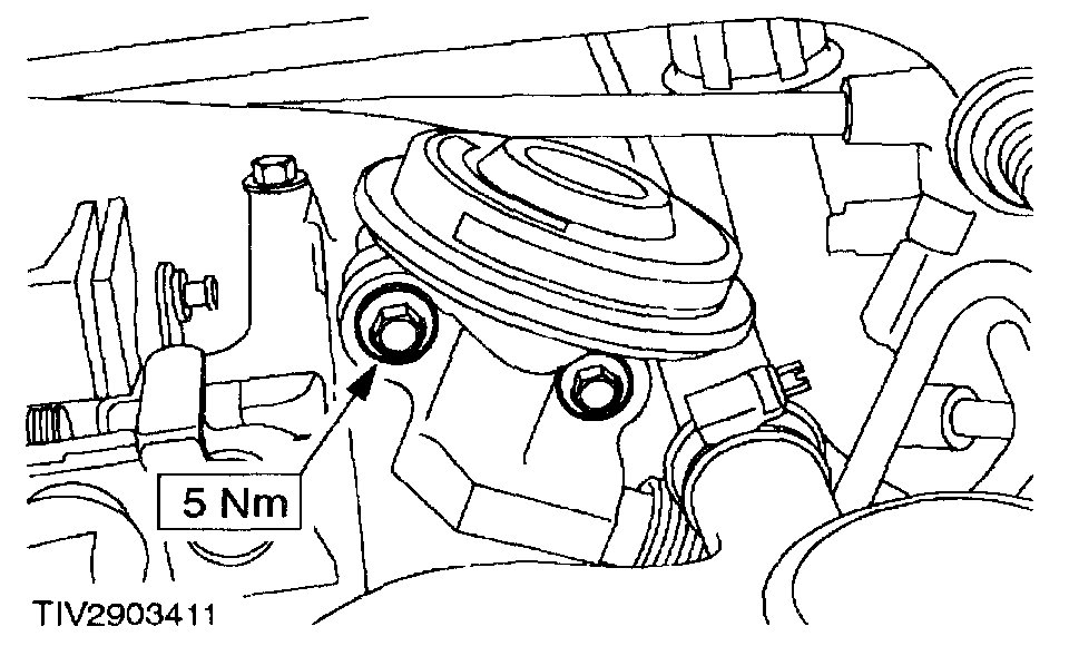

Here are the directions for replacing the EGR. I included it so you can confirm everything was done to specification. The remaining pictures correlate with these directions
PROCEDURES
REMOVAL
1. Remove the air cleaner outlet tube.
1 Disconnect the intake air bypass hose.
2 Disconnect the positive crankcase ventilation hoses.
3 Remove the air cleaner outlet tube.
2. Disconnect the tube from the exhaust gas recirculation valve.
3. Remove the exhaust gas recirculation valve.
^ Disconnect the vacuum hose.
INSTALLATION
1. Clean the gasket faces of the intake manifold and exhaust gas recirculation valve.
CAUTION: When cleaning the gasket faces, do not allow debris to enter the intake manifold or exhaust gas recirculation valve.
2. Install a new exhaust gas recirculation valve gasket.
3. Position the EGR valve and install the bolts.
^ Install the vacuum hose.
4. Connect the EGR tube.
5. Install the idle air control valve.
