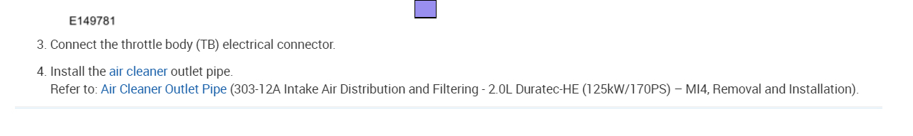

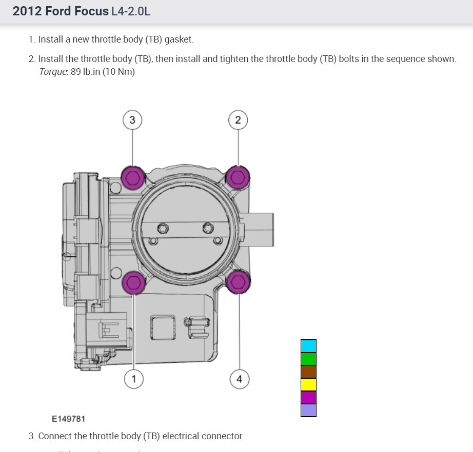

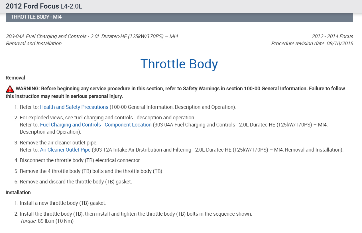

Okay, the check engine light is telling you there is a code present, lets run the codes to see what comes up. this guide can help:
and this guide can help as well because it sounds like you have a vacuum leak, or the throttle body needs to be serviced.
and
Use this guide when the engine is cold only.
