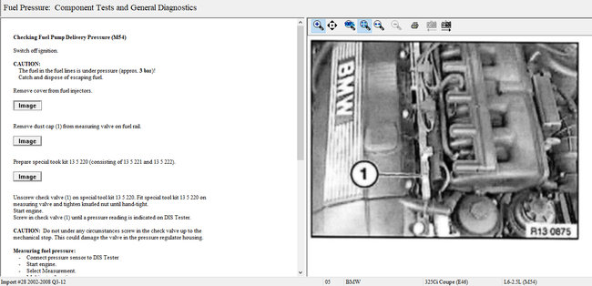

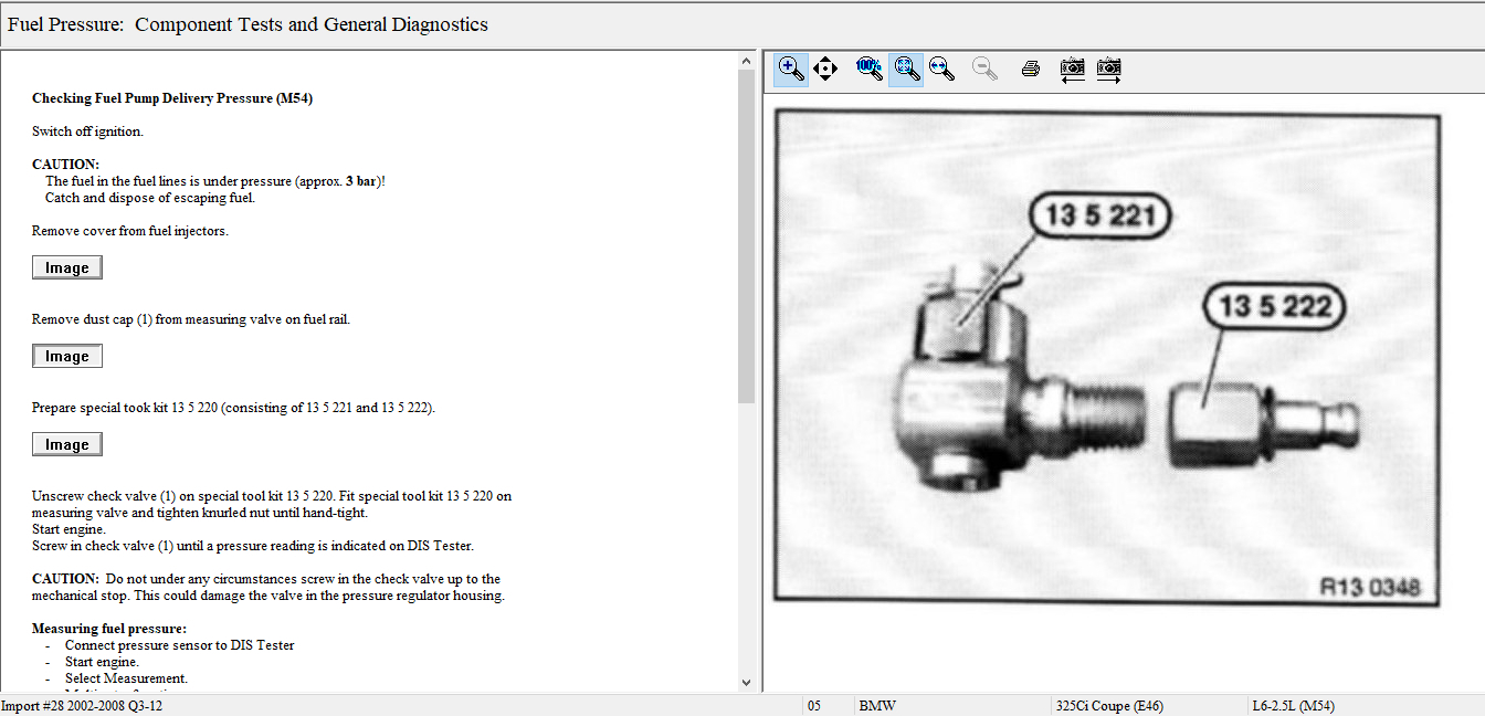

A few days ago my car was running just fine, then it suddenly shut off on me and when I turned it back on it would vibrate the entire car violently. I managed to get it home before it completely shut off. I changed the ignition coils and spark plugs recently, I’ve also cleaned out the idle control valve and changed out all the fuses. I also checked fuel section and it still won’t stay on. Starts but stalls out or doesn’t star. odm2 has no codes.

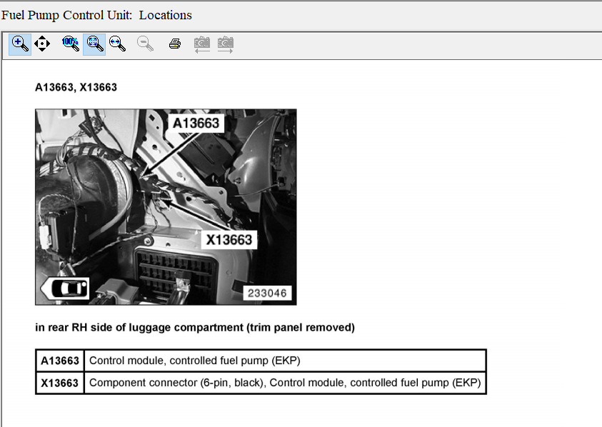

You have to check if spark is present, injector pulse and fuel pressure, also it could be from security system prevent from starting use spare key and try to start. also it can be a big vacuum leak.
check again with scan tool if you get any fault code.
check our link below how to read fault code.
Check our link below helps you why engine cranks with no start.
Check our link below for spark test and injector pulse.
https://www.2carpros.com/articles/how-to-test-a-fuel-injector

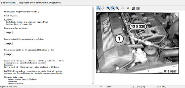

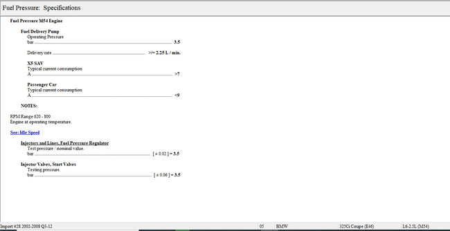

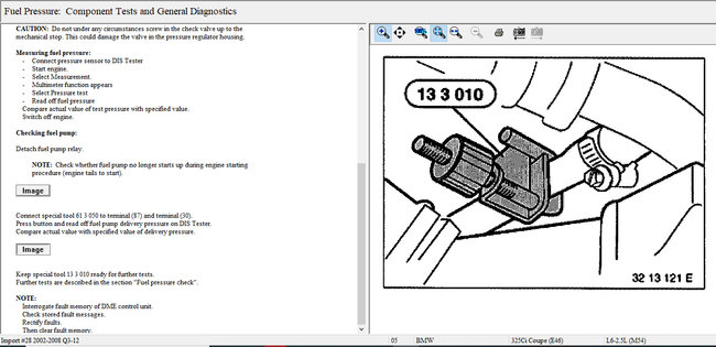

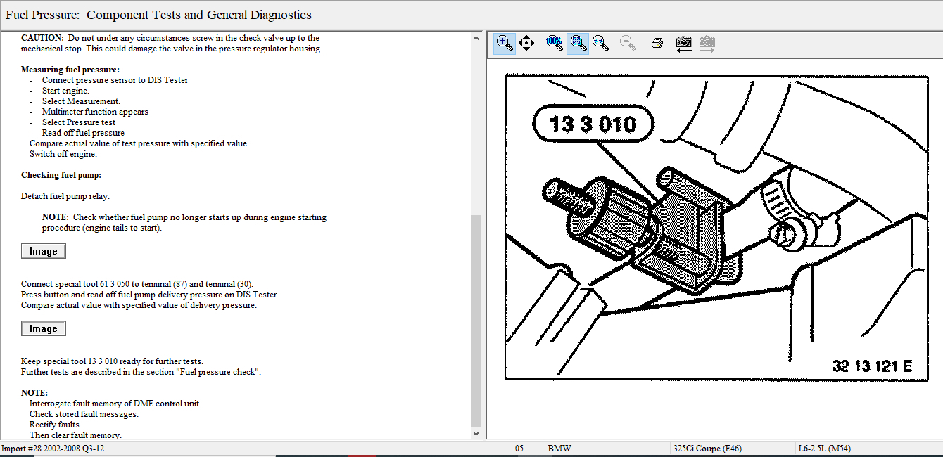

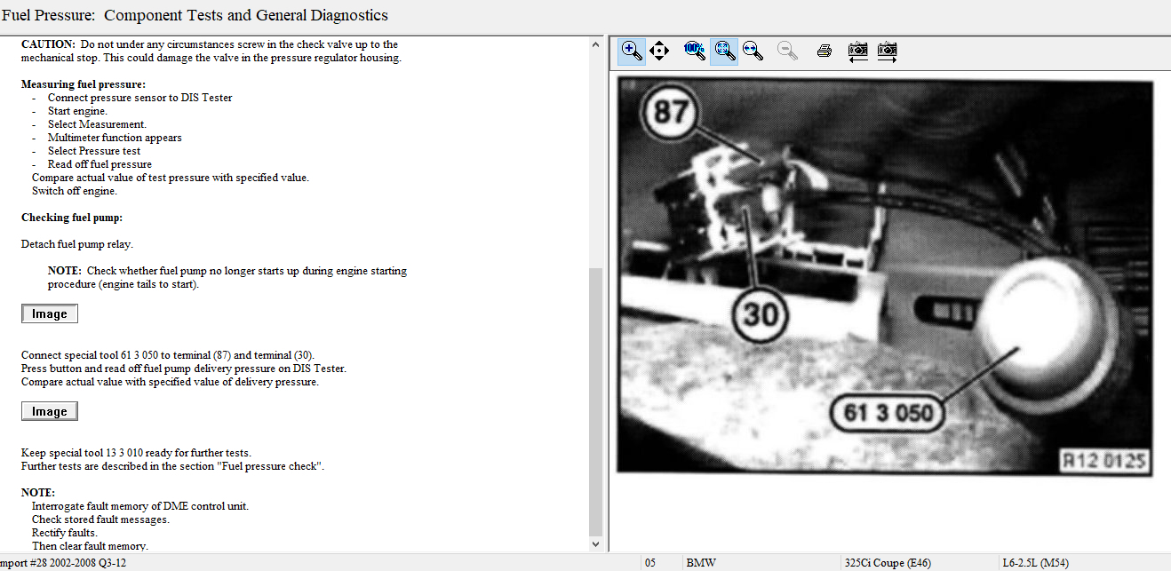

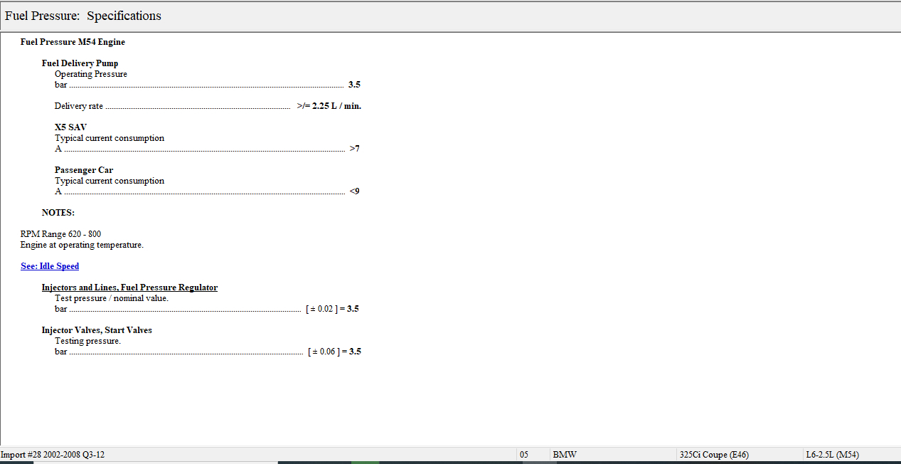

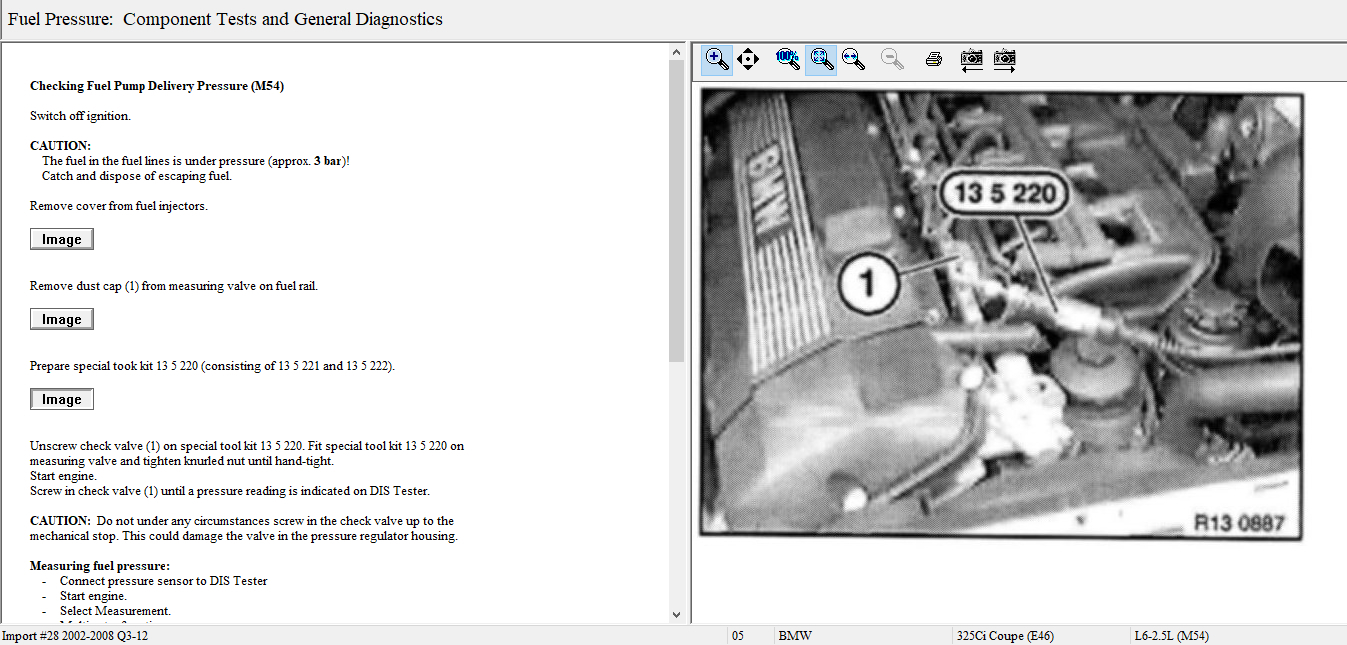

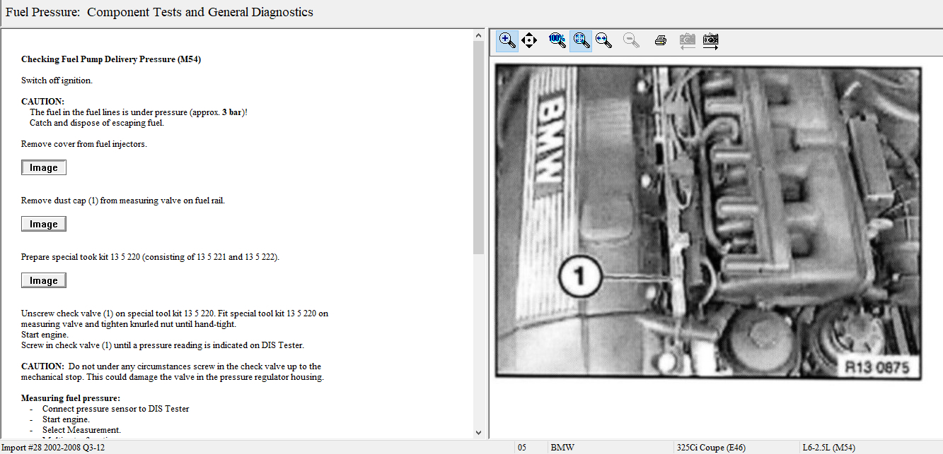

have you checked the fuel pump pressure? how much is the pressure?

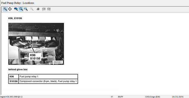

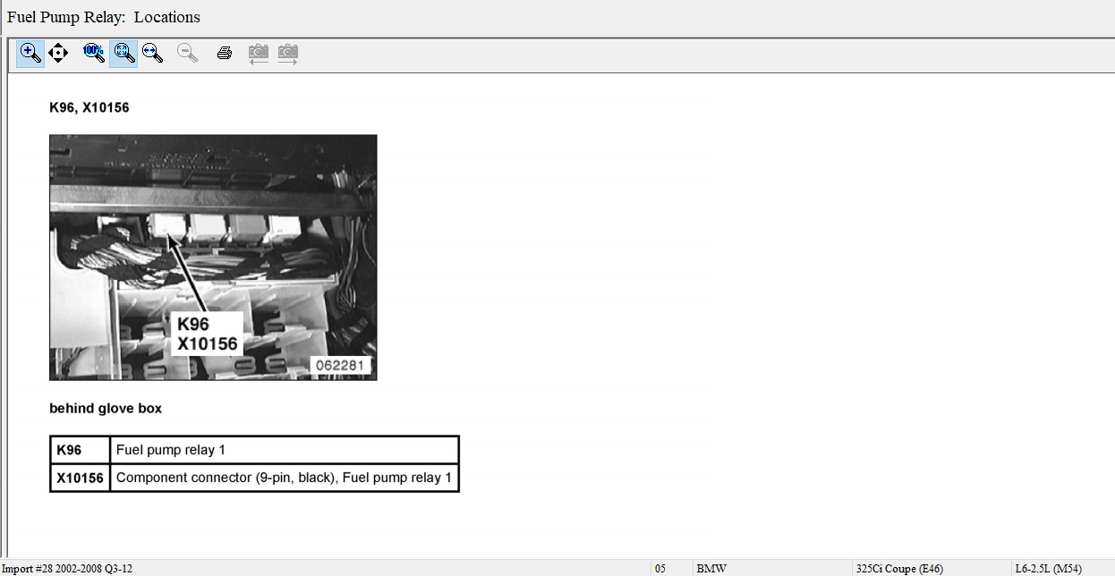

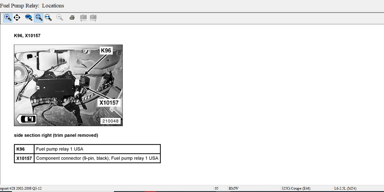

Check the diagrams below how to check fuel pressure and the location at the relay for fuel pump.
if you get any fault code send to us to guide you for diagnosis steps.
let us know what happens with you.
