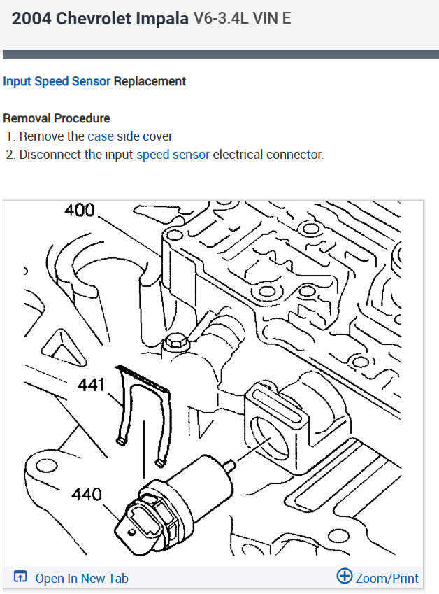

Can you tell me the code number? You may have an input shaft speed sensor that is not good, here is the location of the sensor so you can check it out. Check out the images (below). Please let us know what happens.

The code that is given on code scan is P0730 "Incorrect Gear Ratio" an like I said it's the only transmission code that is appearing on scan nothing else. An so I just double checking it so I know exactly what I have to do. The input shaft speed sensor is located in the side casing where the shift solenoid and pressure control solenoid is located correct?
Feb 9, 2026 at 1:38 AM
MANUELD1977
  • 41 POSTS
Ok I was way off I located it. It's located on the passenger side of car at end of CV axle on transmission casing. Should I replace the output shaft speed sensor as well at same time?
Feb 9, 2026 at 1:55 AM
MANUELD1977
  • 41 POSTS
Correct last message it is in the driver's side transmission casing where shift solenoid is located at. Going to get the input shaft speed sensor and install it and will give update on results of it after replacing it. Is there a way to tell when I remove old one if it's no good or no?

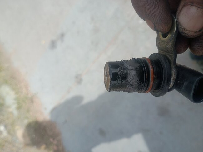

Located and removed speed sensor from housing and it's covered in metal shavings all around it and it's covered with thick layer. Uploading picture of sensor so you can see it
Feb 9, 2026 at 5:03 AM
  • 55,433 POSTS
Nice work on getting the sensor out of there, the metal shaving are not a good sign but I would try installing a new sensor and if that does do anything the transmission will need to be rebuild. Let me know how it goes, thanks for the image it helps.

Ok so I took it to next step and decided to go ahead and pull the other sensor as well to see it's condition it was in. An plus the first sensor I pulled was the "Output Shaft Speed Sensor". So I had to pull the side cover of transmission to access the "Input Shaft Speed Sensor" and it had some metal shavings that was on it but nothing like on one in picture. By time I finished putting everything back together it was late so didn't test it to see if anything changed. Will send response with results of changing them.
