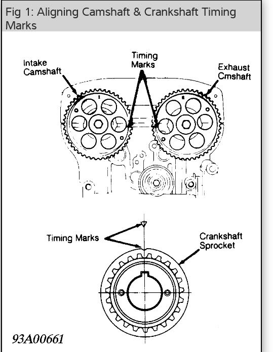

check fuel pressure with a gauge then see link.

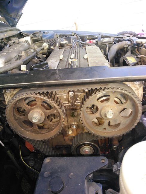

Here is to prove that my timing belt is fine, if you can even see anything on the image

  • 54,837 POSTS
I cant see any of the marks but if they are on I would start to look at a plugged exhaust and check the engine compression. Here are two guides that will help you get the problem fixed.
and
Please run some tests and get back to us so we can continue helping you.
