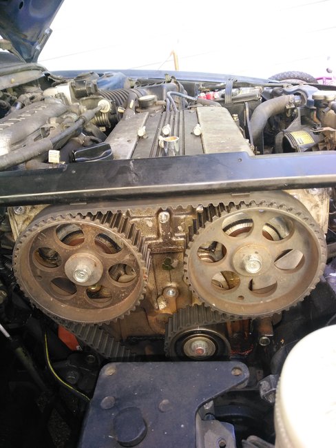

So I just bought it with a big hole in one of the hoses. The person I bought it from did not know much about cars and said the car overheated (due to the giant hole). He tried to fix it himself and got the water pump replaced and got a new timing belt on it, so it could not be those things. I got the hose replaced and then tried to start the car. At first, it just turned over, but then I learned that if I stamped on the gas a bunch, it would slowly turn on and get moving. When it was moving, it would sometimes never go above a certain speed even though I was flooring it but it only got going about twenty miles per hour. It then would rectify itself and get going. One day, I was driving it on my 4th test and it randomly just turned off and would not get started again and I do not know why (I had to push it a block into my driveway). It still cranks over but it does not start no matter what I do anymore.

check the timing belt for being on correctly and not jumped the guy may have changed it and not said anything. If it is out of time it probably bent some valves. so do a compression check

I have checked the belt and it is not off, and I just checked all my sparks yesterday and they are all of them are working. And it turns out, my car will still run, it just needs over half battery to start

Here is to prove that my timing belt is fine, if you can even see anything on the image
May 26, 2017 at 9:24 AM
  • 55,423 POSTS

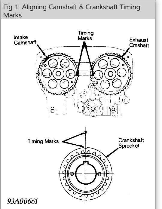

I cant see any of the marks but if they are on I would start to look at a plugged exhaust and check the engine compression. Here are two guides that will help you get the problem fixed.
and
Please run some tests and get back to us so we can continue helping you.
