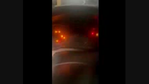

The car cranks, but isn't turning over. Dashboard lights come on. Battery is about a month old. 1/2 tank of gas.
