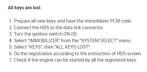

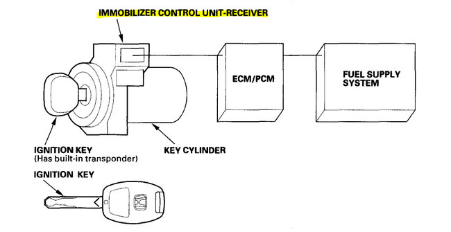

What was removed? As far as the new key is concerned, did the locksmith reprogram the immobilizer to recognize the new key? If not, the vehicle will not run. The immobilizer must recognize the key to signal the ECM to allow the fuel system to run. See pic 1.
If this was not done, the car won't run and will require the new key to be registered within the ECM. Here is the catch: It requires Honda programming. I don't believe it can be done with an aftermarket scan tool.
If you look at pic 2, it explains what needs to be done if you lost both original keys.
