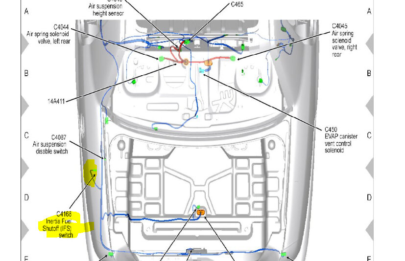

For power to reach the FPDM, it has to come from the fuel pump relay and through the inertia switch. Have you checked the switch? Also, the FPDM is what controls the voltage to the pump. However, power must go through the inertia fuel shut off switch first.
I you haven't already, try resetting it. It is located in the trunk, driver's side behind a panel.
See pic below.

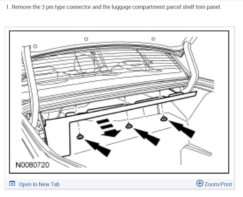

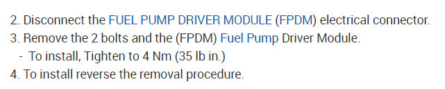

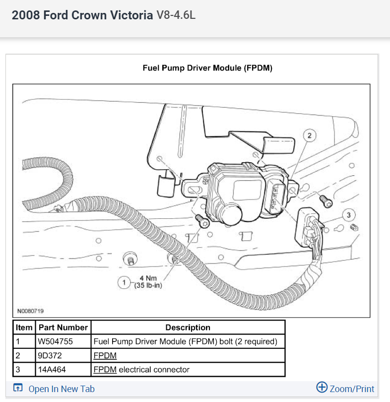

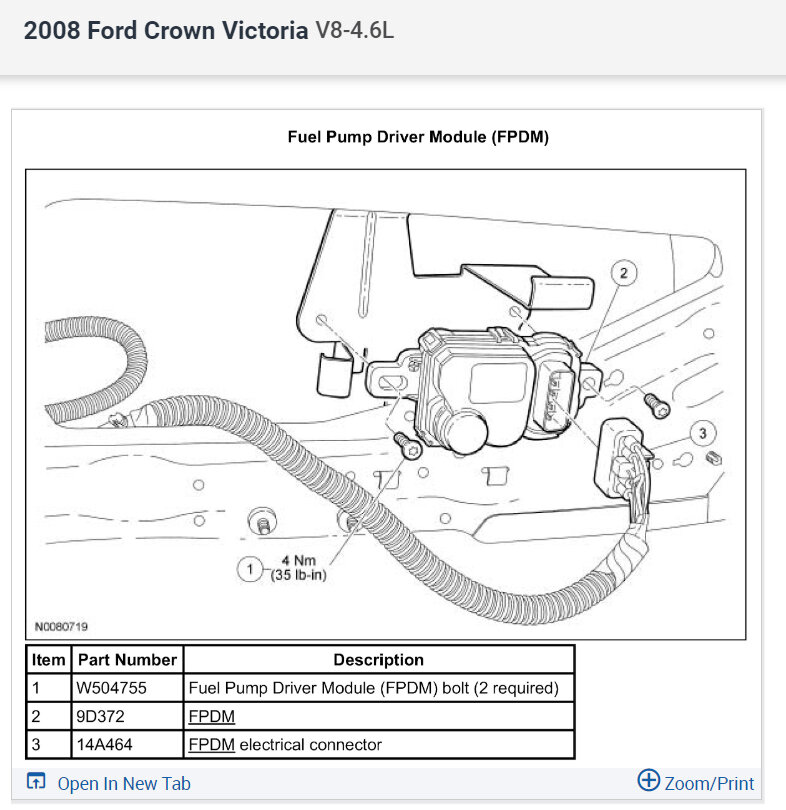

Here is a new guide that can help but is sounds like you found the problem.
Here is the location of the FPDM which is in the truck and how to change it out. Check out the images (below). Please let us know what happens.
