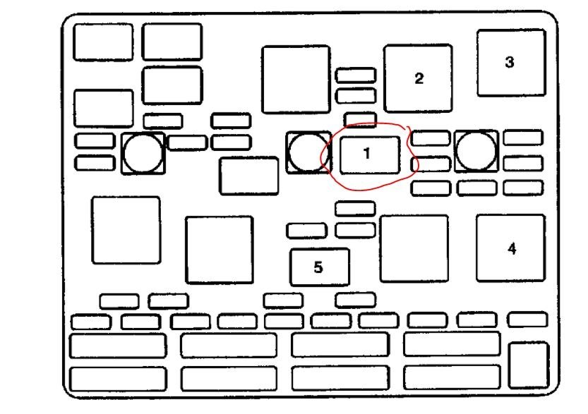

Cranks over, sometimes sputters and quits. Put fuel pressure gauge on and has no pressure.
Nov 16, 2020 at 2:24 AM
Good afternoon,
If you have no pressure it could either be wiring to the pump or a bad fuel pump.
I would check for voltage at the fuel pump itself to be sure there is a voltage at the grey wire.
https://www.2carpros.com/articles/how-to-replace-an-electric-fuel-pump
I attached a wiring diagram for you to view showing the wire.
I would start at the relay. We can start testing there. I attached the location for you.
