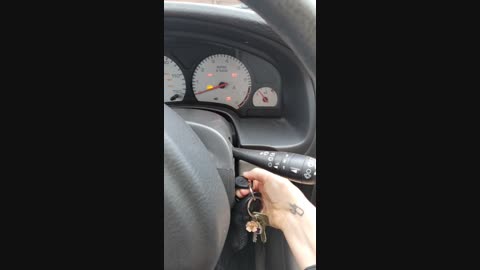

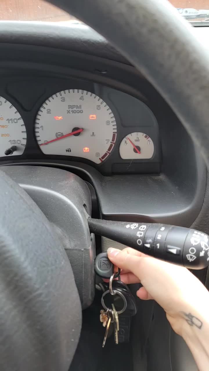

Here's a video of it just cranking. After it starts it's perfectly fine and doesn't sound bad at all. No knocking or any weird sounds. The only time it sounded bad was when one of the cylinders wasn't running or something. It had 952 misfires in 8 minutes. It runs after turning the key a second time. Sometimes it starts normally. It's random. I'll send a video of it starting after this one.

Thanks for the video. It still sounds strange to me, can you get a video from under the hood while cranking? I am trying to see if you have a bad cylinder without doing a compression test. Please go over this guide for misfires:

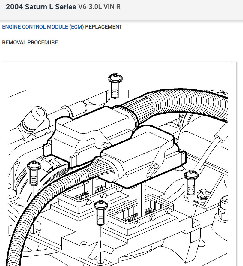

Can I get a video of the engine cranking from under the hood, did you do the compression test? I am leaning towards the PCM being bad with all these codes coming up at once, I would send the PCM in for testing. Here is how to remove it, you can get a preprogrammed unit by searching Google or Ebay.
