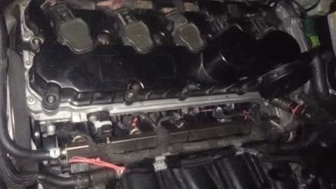

Car cranks but doesn't start I tried already Pressure on the gas is good and check my spark is good. Check my chef sensory sensors. Check my camshaft sensors good. Check my if I have fuel, I do but I still will not start. What can it be?

How does it sound when cranking over? The reason I ask is because if the timing chain has jumped the engine will not run. Please go over this video:
https://youtu.be/lXLJbuAZ4CE?si=avQqIHPK5iK86Ep5
Can you please upload a short video of the engine cranking over so I can see if the engine is hurt or not? In the meantime, you can do a compression test to see if the engine is okay as well.
Please go over these guides and get back to us.

Hi, there is the video and i also believe my car is in limp mode. how do i take off limp mode?

See the head gasket just got replaced the car ran ok for about a day or two then it started to lose power when acceleration and even at times i would be at a light and i would press the gas and car wouldn't go until it did but very slowly so i thought it would be a sensor or something i. Clean those did a compression test cheeked for gas in tank and also gas cap was on good .also when i spray starting fluid it won't start i thought it was fuel but everything checks out. So, I'm not sure what it is.

Yep, it sounds like it might have jumped time, what was the compression test reading? Thanks for the video, it helps.
