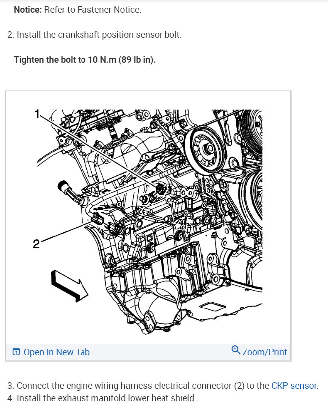

Okay, so my car cranks but won’t run.
Battery.
Fuses & Relays.
Spark Plugs.
Coil Packs.
No Lock Pass.
No Check Engine Light.
OB2 Scan Shows No Codes (I've used 3 different scanners).
Starter.
Fuel Pump.
I can’t figure out the issue.

It sounds like it wants to start. It'll crank and crank then sometimes bogs out. No, it does not run on starting fluid.

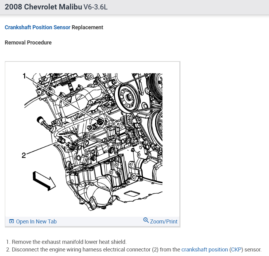

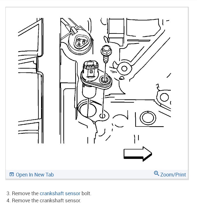

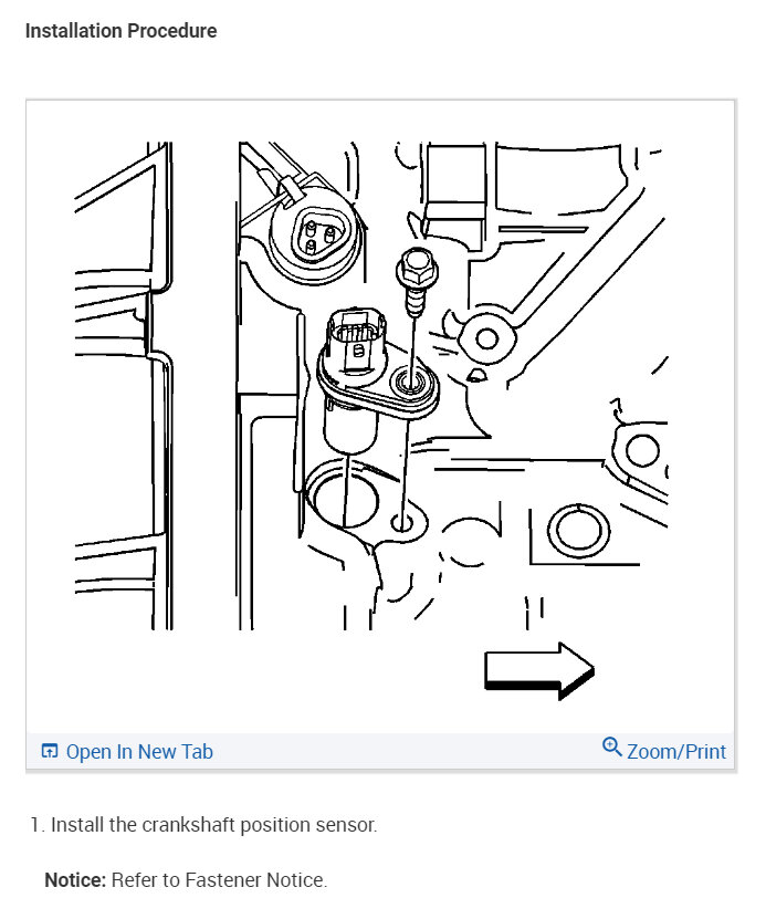

So, it sounds like you don't have spark, did you see the video and try it? If so and you don't have spark the popular cause of no spark on these cars is a crankshaft position sensor. Here is the location so you can check the electrical connector and if okay swap out the sensor. Check out the images (below). Please let us know what you find.
