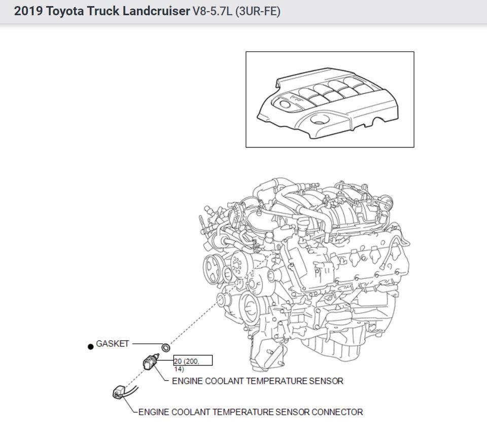

In the night i park my car in normal condition and when i try to start in the morning i see check engine light and the engine cranks but the car won't start.
But in the afternoon when i tried it, it started.

Yes, the cold can affect the engine running when the coolant sensor goes out. Also, we should run the codes to see what comes up. here is a guide to help and the location of the coolant sensor so you can unplug it when the engine will not start to see if anything changes.
