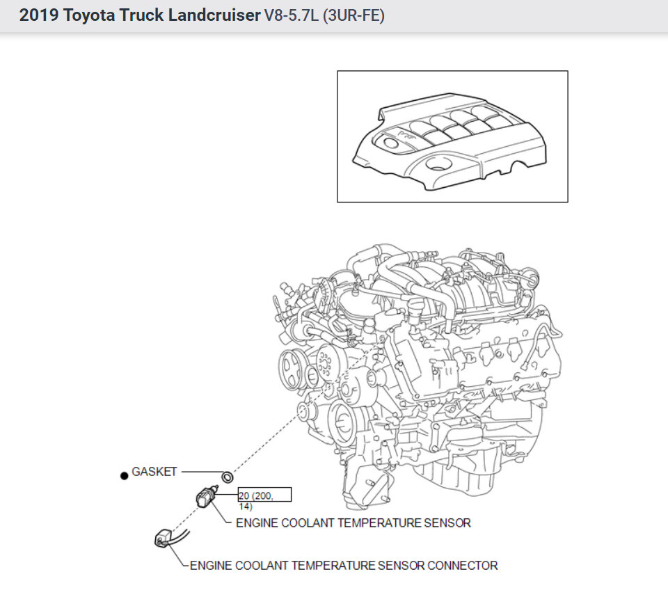

In the night i park my car in normal condition and when i try to start in the morning i see check engine light and the engine cranks but the car won't start.
But in the afternoon when i tried it, it started.
Jan 6, 2023 at 2:09 PM
  • 55,405 POSTS
Yes, the cold can affect the engine running when the coolant sensor goes out. Also, we should run the codes to see what comes up. here is a guide to help and the location of the coolant sensor so you can unplug it when the engine will not start to see if anything changes.
