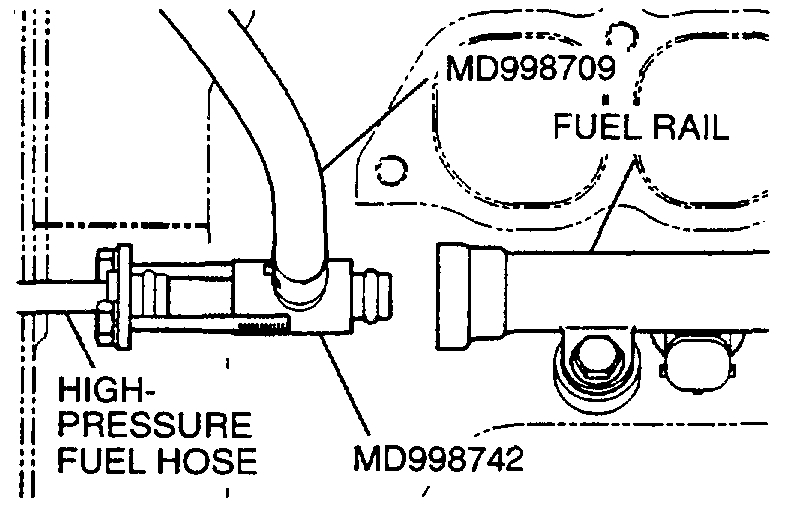

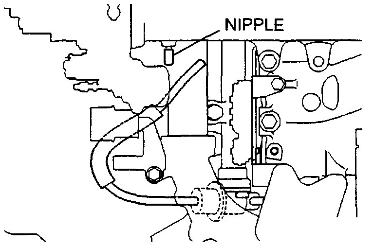

2. Disconnect the high-pressure fuel hose at the fuel rail side.
3. Assemble special tool, M0998709 and special tool M0998742
pic 2

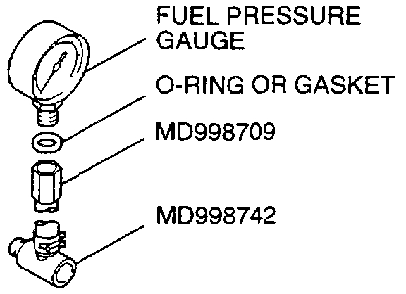

4. Place a suitable O-ring or gasket on the assembled special tools MD998709 and MD998742 and install the fuel pressure gauge.
pic 3
5. Install special tool MD998742/MD995709 (created in steps 3 and 4), between the fuel rail and the high-pressure fuel hose.

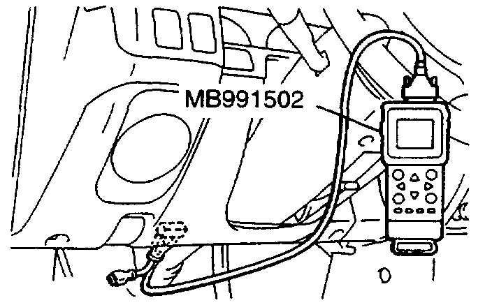

6. Connect scan tool MB991502 to the data link connector.
7. Use the Actuator Test 25 to drive the fuel pump. Check that there is no fuel leaking from any section when the fuel pump is operating.

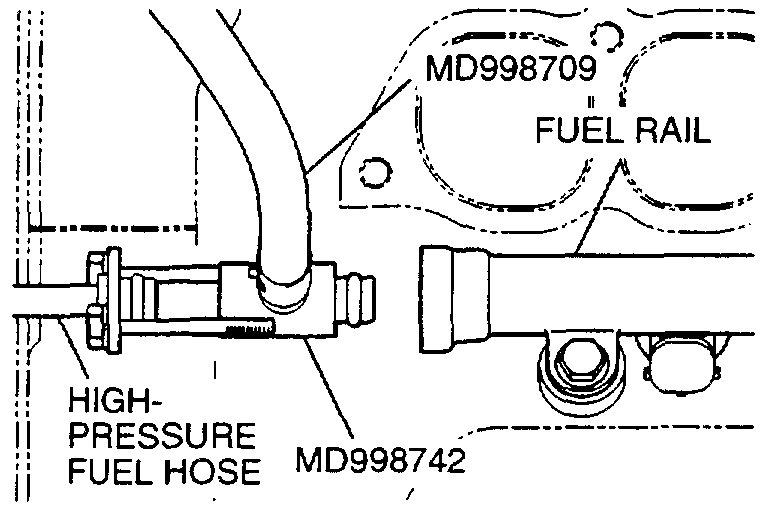

9. Start the engine and run at idle.
10. Measure fuel pressure while the engine is running at idle.
Standard Value: Approximately 270 kPa (38 psi) at curb idle
pic 5
11. Disconnect the vacuum hose (blue stripe) from the air intake fitting and then plug the nipple.
Measure the fuel pressure in this condition.
Standard value: 330 - 350 kPa (47 - 50 psi) at curb idle

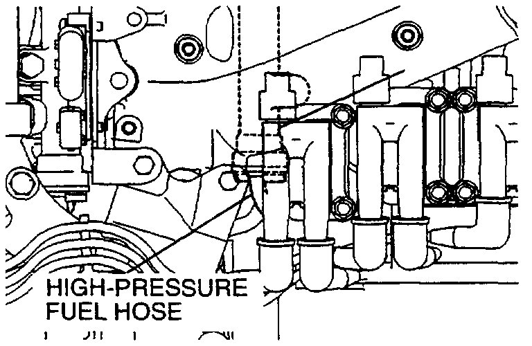

12. Check to see that fuel pressure at idle does not drop even after the engine has been raced several times.
13. Racing the engine repeatedly, hold the fuel return hose lightly with fingers to feel that fuel pressure is present in the return hose.
NOTE: If the fuel flow rate is low there will be no fuel pressure in the return hose.
pic 6

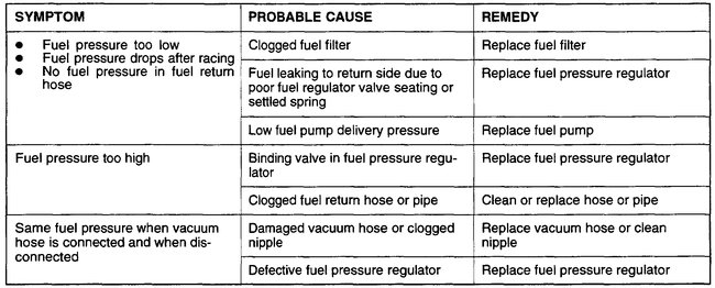

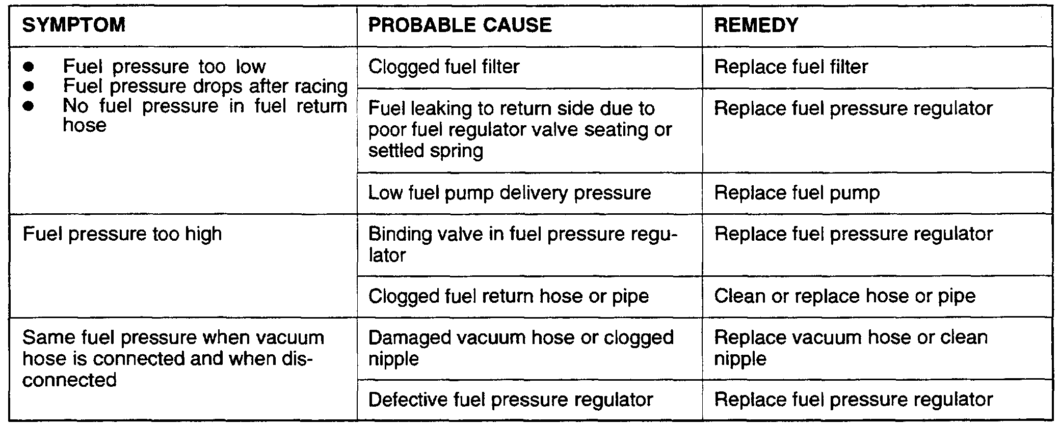

14. If any of fuel pressure measured in steps 10 to 13 is out of specification, troubleshoot and repair according to the table above.
pic 7

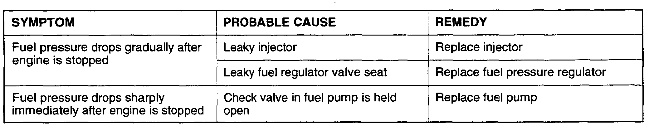

15. Stop the engine and observe fuel pressure gauge reading. Normal if the reading does not drop within two minutes. If it does, observe the rate of drop and troubleshoot and repair according to the table above. Start, then stop the engine.
(1)Squeeze the fuel return line closed to confirm leak-down occurs from defective fuel pressure regulator.
(2)Squeeze the fuel supply line closed to confirm leak-down occurs from defective fuel pump check valve.
(3)If pressure continues to drop with both fuel lines squeezed closed, injector(s) are leaking.

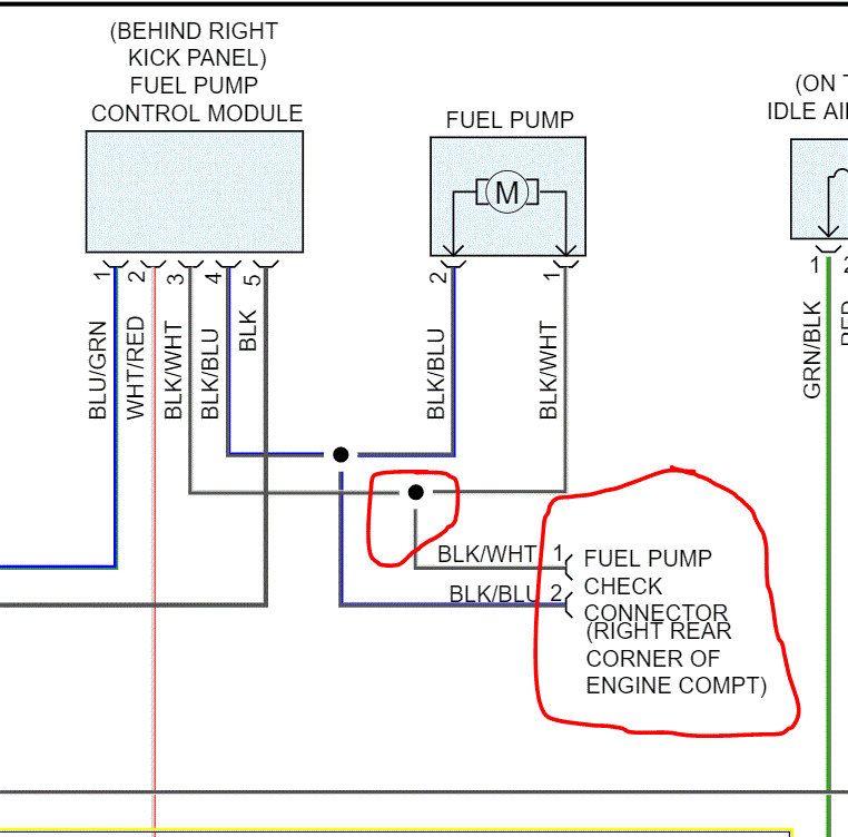

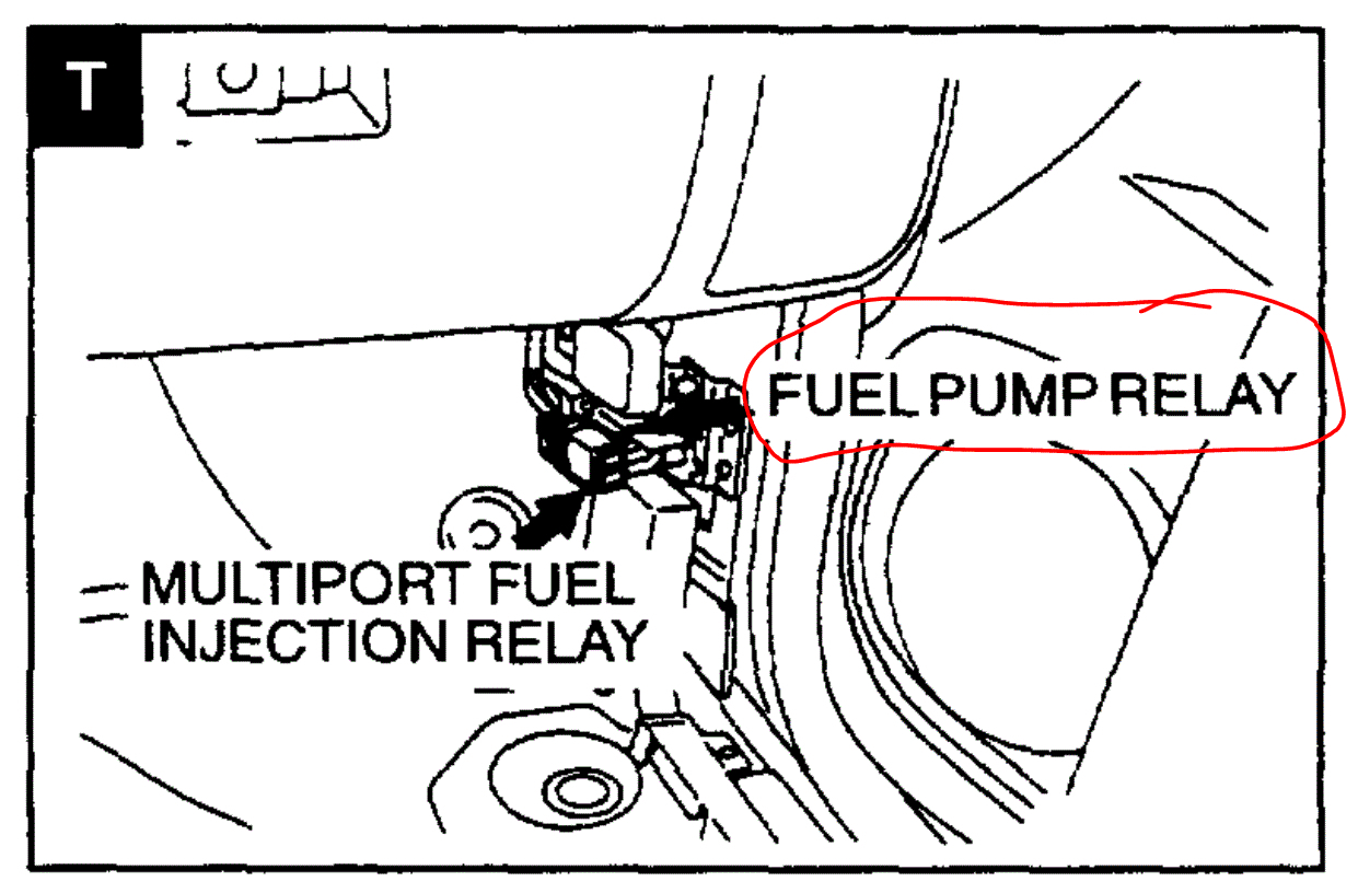

Have you checked the fuel pump relay? I attached a picture of its location. Here is a link that explains how to test one:
Also, check the pump ground which could be weak. See picture 2.
