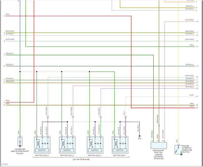

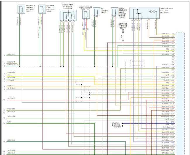

My car won’t start but cranks, the issue started after it has been stalling for while driving or at idle and codes of lost communication e.g. (U0073, U0101, U0121, U0155), and the car will start immediately if I restart it. I cleared the codes and drove for some time, it will happen again and i will start again, now it won’t start at all but cranks and won't display any codes.
Some Checks already performed are:
1. Fuel pressure
2.coil
3. Spark plugs
4. Crankshaft sensor
5.injectors.
6. All Air intake sensors and possible leaks
7. All relays and Fuse Checked
They all check out to be fine except when cranking, the spark plugs and Injectors do not have ground from the PCM.

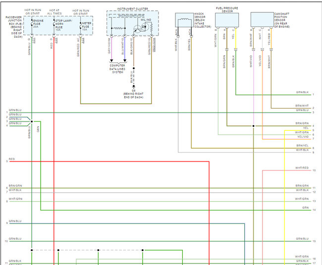

Am thinking of replacing the PCM but a check i need to perform last before that is testing the harness of the PCM to the instrument Cluster.
I need assistance for the instrument cluster terminal diagram, wiring and label to perform next check.
Thank you in Advance.

i need to verify the wiring harness and pins that connect the ignition Coil and PCM along with the Instrument Cluster.
I don’t want to rush to replace PCM.
I once had a P0606 issues and replacing the PCM couldn’t solve the problem.
I need assistance as to have the pins labelling to perform the test.
Thank you

Sure, no problem, here is a guide to help you check the wiring and the engine/PCM wiring diagrams so you can see how the system works and high power and ground to check.
Apr 16, 2024 at 2:02 AM
HUDUMASAUD
  • 45 POSTS

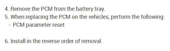

I tried my best to check the igniters wire (GRN) to the PCM socket directly and there is no continuity to any of the PIN. I don’t know if i need to check continuity through the fuse or it should be directly but i did it straight from PCM harness pins to Coil connection

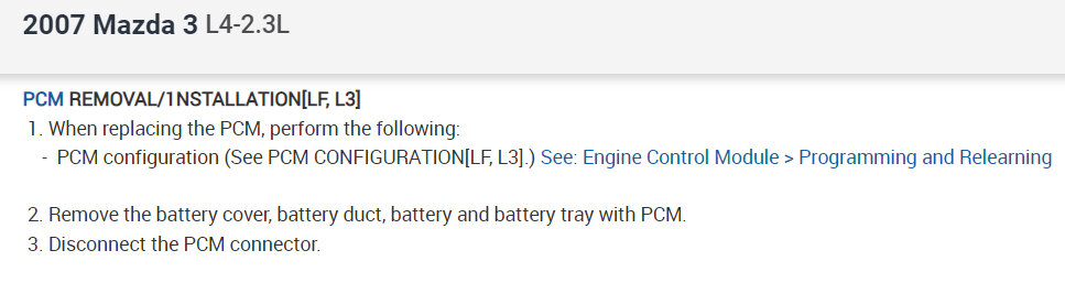

I replaced the PCM, and it couldn’t crank the car until it was programmed.

When you crank the engine over is the security light flashing? Also, the PCM must be programmed, did you get a pre-programed unit? Sounds like the PCM was the problem because the no communication codes have disappeared.

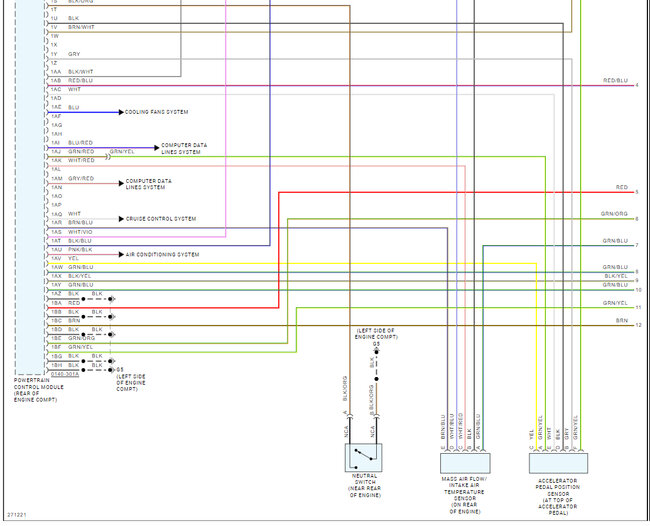

I recently traced all the injectors, ignition coil, MAF, and IMRC wired to the PCM harness, and they all have a sound continuity.

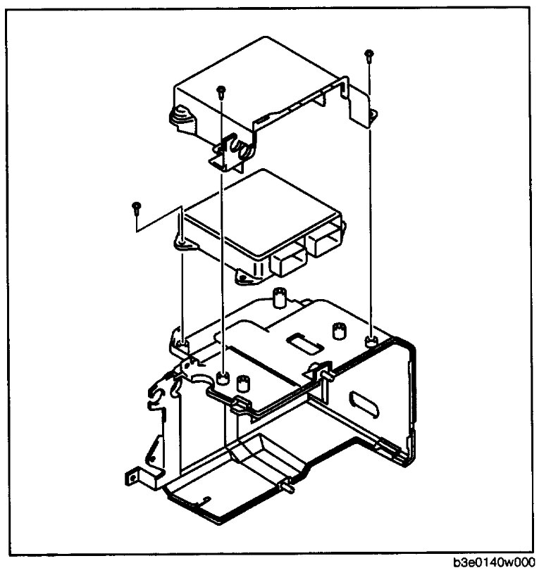

With the problem you are having and the fuses and grounds are good I would send the PCM and instrument cluster out for testing.

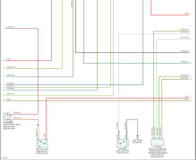

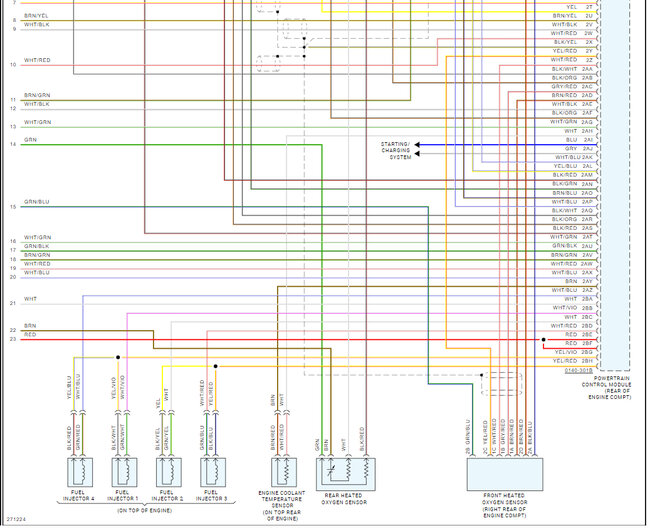

I called in a CAN scanner and all there is some codes about ABS and few for instrument clusters, then we decided to try a new PCM. The car will start but won't stay idling, tried to check the issue and it was found that only Injectors nozzle 1&2 are working. The rest have no voltage on the signal wire. The car will start now if the key is turned on to ignition twice and making the third turn to a start position. But it won't idle because it lacks enough fuel distribution.
May 2, 2024 at 7:00 AM
  • 55,628 POSTS

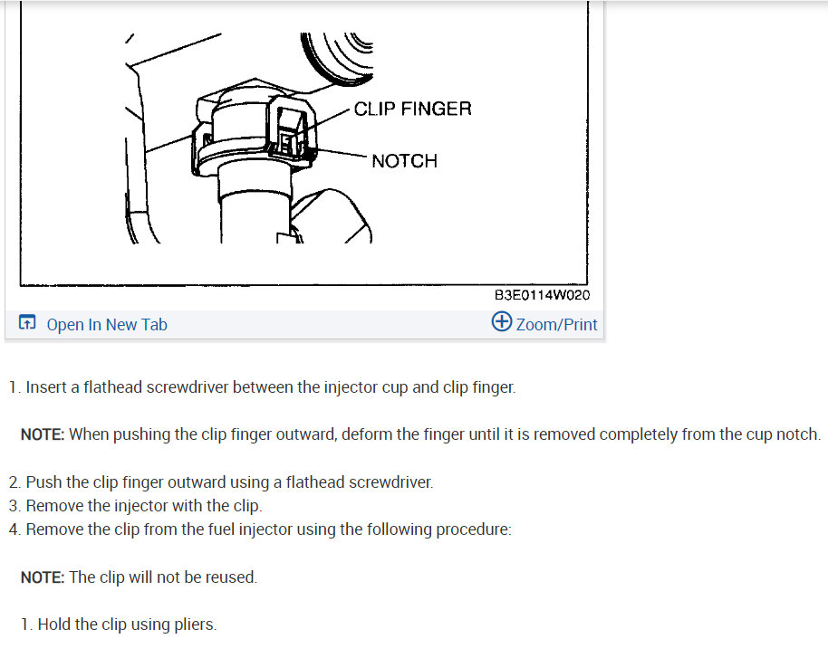

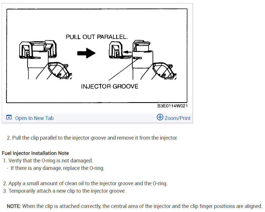

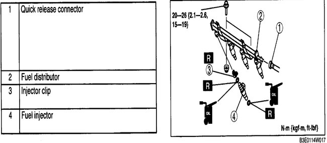

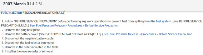

Okay, for the injectors that are not working let;s use a voltmeter to check the OHMS readings. Here is a guide that will help with the testing. If you got 0 ohms, the injectors is bad.
https://www.2carpros.com/articles/how-to-test-a-fuel-injector
A shorted injector can take out the PCM. Check out the images (below). Please let us know what happens.

I will perform the test. Update on the PCM, I replaced another PCM and it was supplying. Injectors 1&4 but 2&3 have no light on the test bulb. The car will start but quench between 5-8 seconds, but if i place my foot on the pedal, it runs till i let it go.
May 3, 2024 at 8:35 AM
HUDUMASAUD
  • 45 POSTS

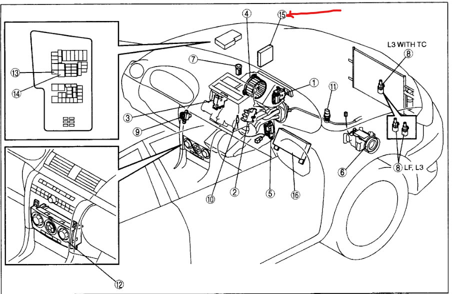

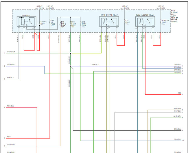

I performed the checked as you instructed. It all checked out fine. I also went ahead to perform as the workshop manual instructed and reads 12.5 ohm . What I couldn’t perfected is how to identify “MAIN RELAY terminal A”
Though i opened the fuse box under the hood by the driver side and i got continuity from some terminals including most fuses giving a beep sounds for continuity , Also checked main relay as designated on the fuse box cover label which i can’t verify if that’s the correct relay with terminal A to the Terminal B of the fuel Injector, though, one the terminals of that relay has continuity. All this test was performed without battery attached to the vehicle. Thank you.
May 4, 2024 at 12:45 AM
  • 55,628 POSTS
The battery needs to be connected to the car to check for voltage. Also, was the fuel injector good?

That voltage test has been carried out since the beginning of the no crank. though i still did it again and i got 5v on 1 and 4 but no volt in 2 and 3.
