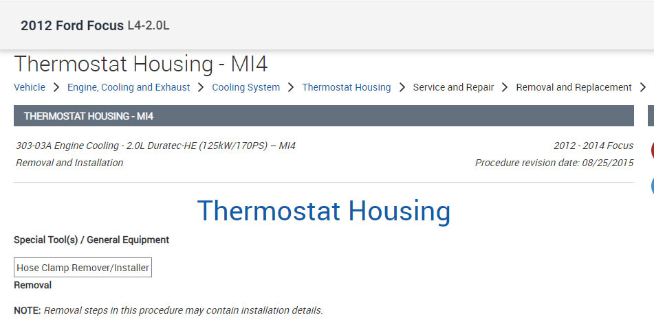

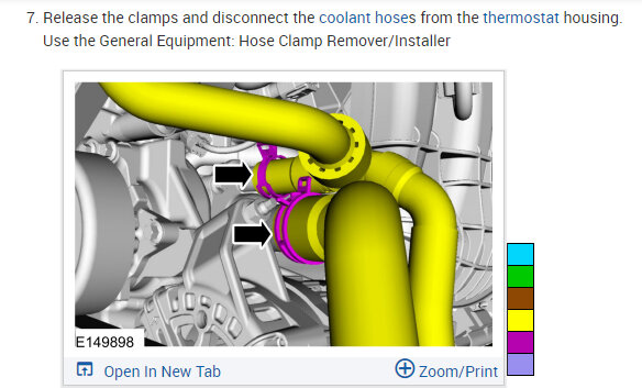

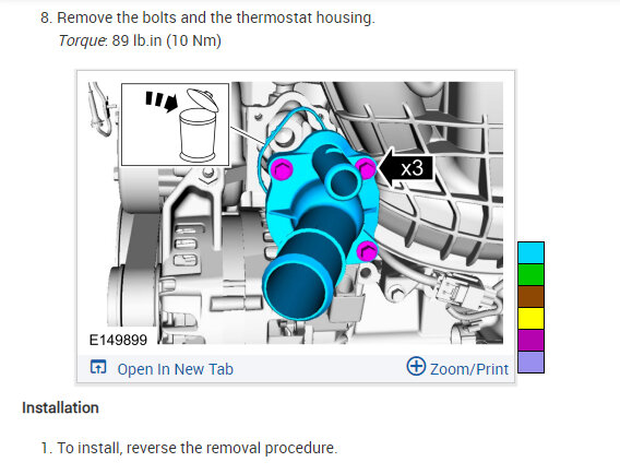

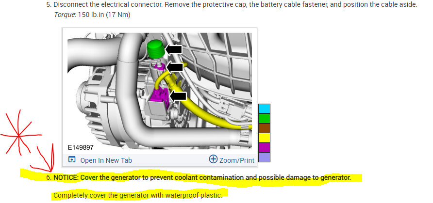

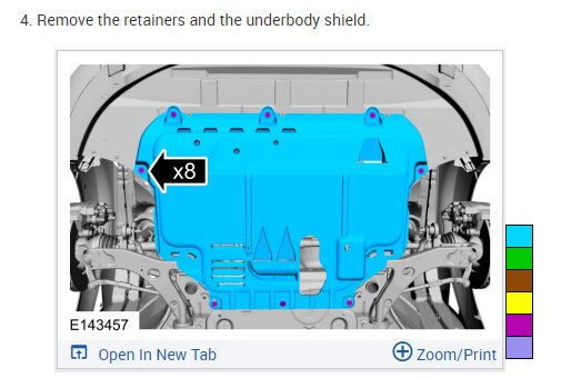

As far as replacing it, the only difficult part is that it is done from under the vehicle on this car. As far as precautions, disconnect the negative battery terminal before you start and cover the alternator to prevent coolant from getting to it.

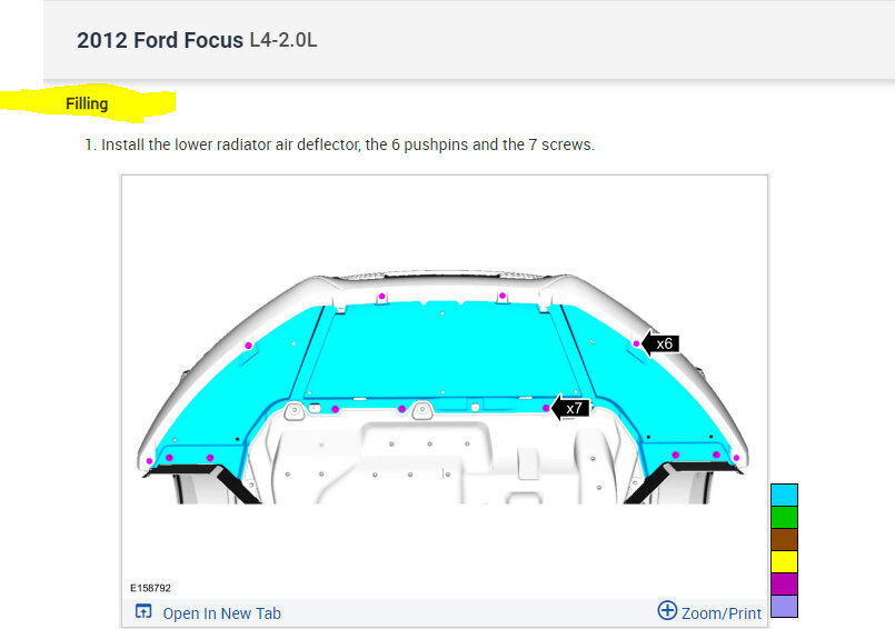

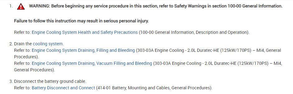

I attached the directions below from my manual. Take a look and let me know if you have questions. Also, here is a link that explains in general how it's done. It will give you an idea as to what you will be doing.
Note: The directions below indicate the removal of the thermostat housing. Please confirm with the local parts store if the thermostat is integral to the housing. If that is the case, they will be replaced as a unit. Here is the OEM part number so you have a reference. Also, if you go to Google, type Ford part CP9Z8592G and see where you can get the best price. According to my manual, it's a 90.00 part, but that is an OEM part price. I bet you can get it from a parts store or even Amazon for less.

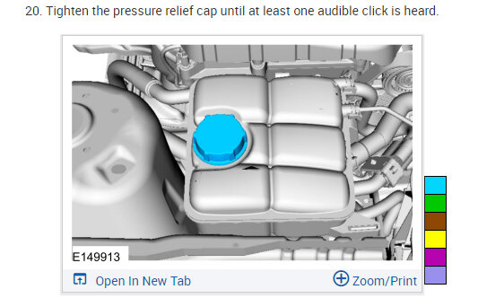

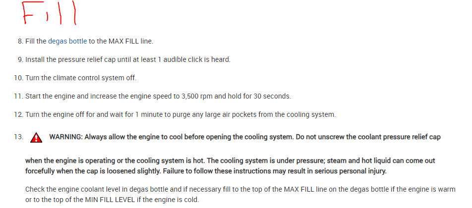

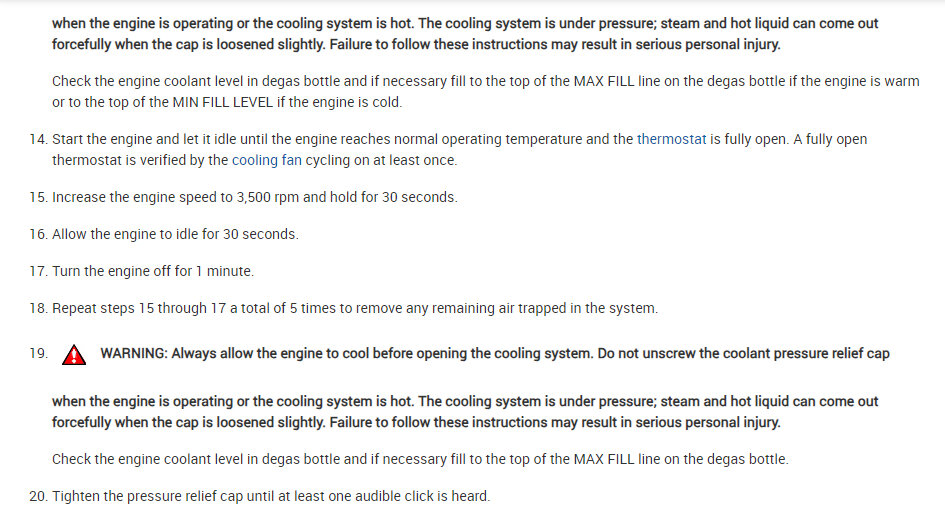

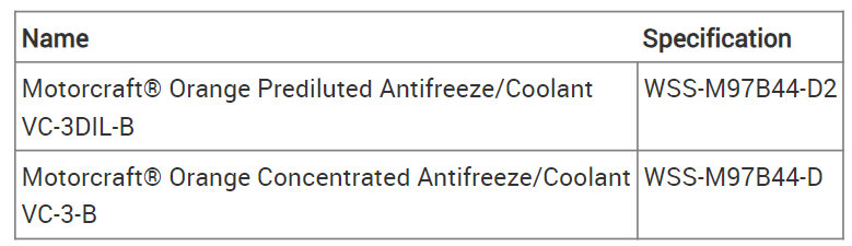

Also, at the end of the directions, I included the refill procedure. When you start refilling the system, go slow so it has a chance to purge air. Once it remains at the full mark, start with the directions. They start at number 8 because the prior steps were for draining and how to mix the coolant based on extreme conditions. The very last pic shows the coolant type needed. There are other manufacturers that make it, so once again, get the best price. One last thought. Coolant should be 50% coolant and 50% water. Pay attention when you purchase it. You can purchase it already diluted or not. If the system is completely empty, it will hold 6.8 quarts (a little over a gallon and a half).
Let me know if this helps.
See pics below. Also, make sure the neg battery terminal is disconnected prior to starting. You will be right near the alternator and don't want to cause a short.
