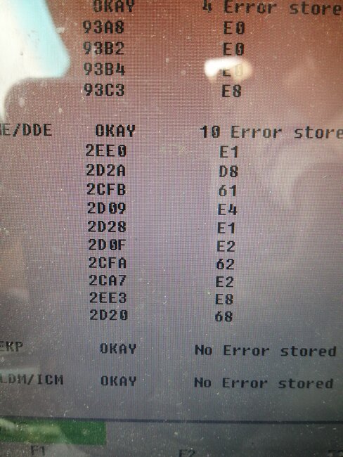

I have the car listed above 300i and the throttle not working and car in constant limp mode.
I have changed the following parts below as I was trying to fix the problem:
1Throttle body
2Throttle pedal
3Mass air flow meter
4Coils
5Map
6Vanos
7camshaft both
Please, I need help guys. Ps the code for electric water pump was because I disconnected it before scanning for error code via INPA.

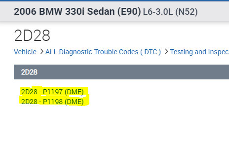

Wow, that's a list. By chance, do you have the P codes? My manual provides multiple P codes for the manufacturer's codes you provided. Each one takes me in a different direction. See pic 1

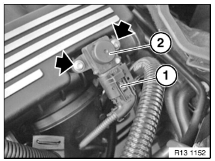

Also, have you checked the differential pressure sensor (pic 2)?
