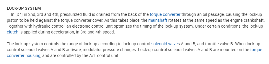

What happens is most likely the converter is locked up all the time. So when in park and neutral the transmission is not connected due to the converter being disengaged, same thing in reverse. However, when shifting to forward gears it is applying the converter when it shouldn't. This is the same effect as in a manual transmission when you put it in gear and let the clutch out without accelerating, it just stalls.

Okay. There is no easy way to do this on your vehicle. On more modern vehicles, we can monitor with a scan tool for RPM but I don't think that is monitored on your vehicle.
If it were me and you bought the transmission used, I would replace the converter and go from there. This is based on experience but if you want to confirm this, then we will need to inspect the system including the lock up solenoids.

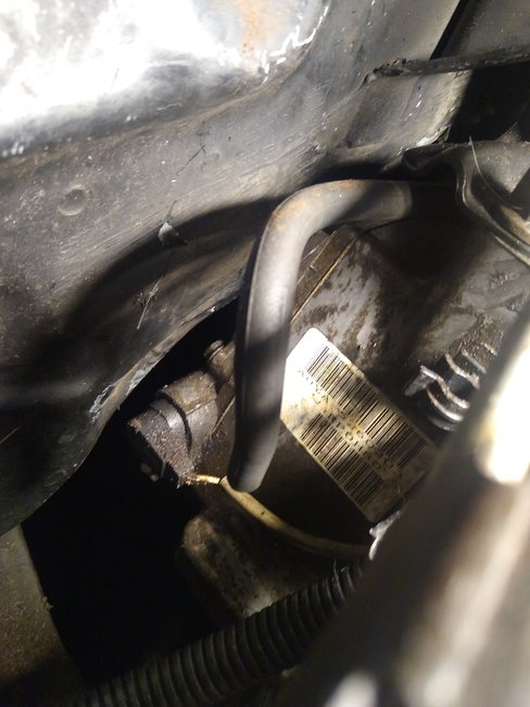

I found something odd probably overlooked it on install. Is this vacuum tube just a vent? It is right underneath the transmission side mount passenger.

Lastly, I don't recognize that line. It looks like a vent but what is it coming off of?

As for the hose I am not sure but it is directly under the transmission passenger side mount. I'm not home to look currently but I will double look. I didn't plan on pulling the transmission since the drive plate not being seated hopefully was the issue.
