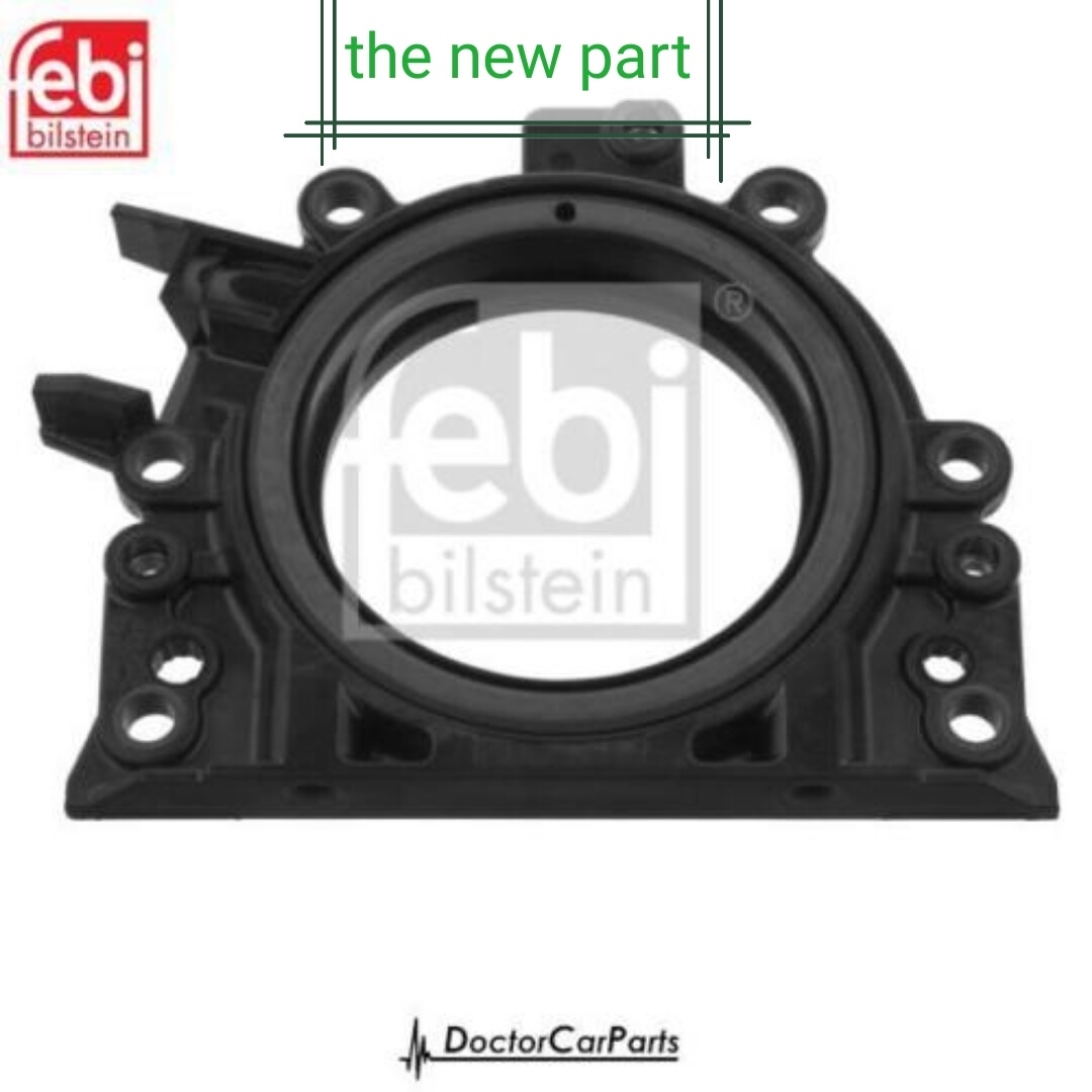

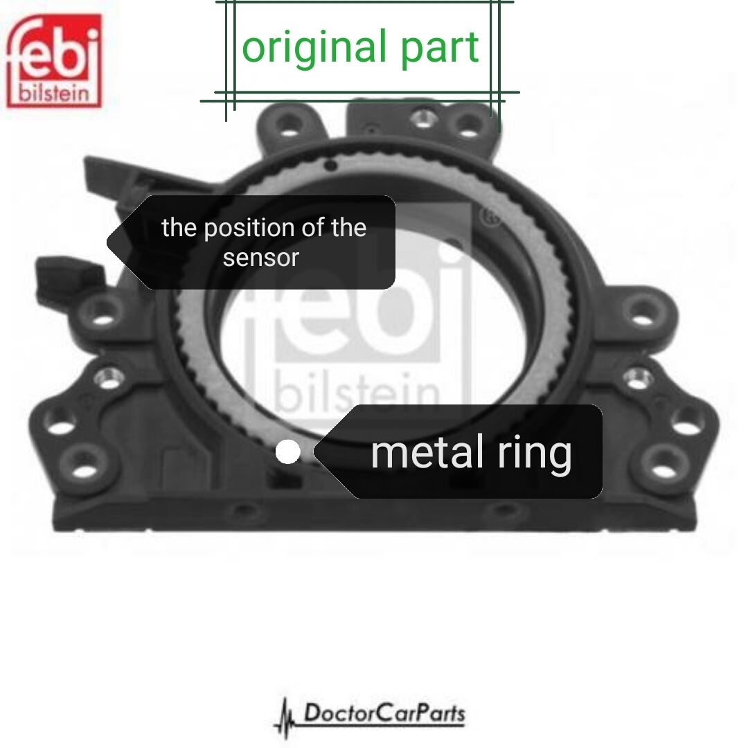

After replacing the rear crankshaft seal which comes with a new sensor housing and the seal. The starter kicks but the engine does not run. Do I need to program the car to solve this problem?

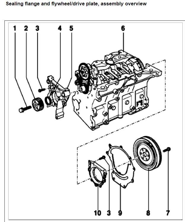

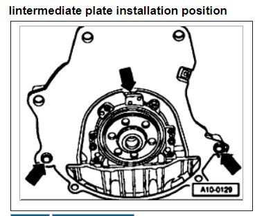

The rear seal came with the sensor. I have the diagrams for the seal. I do not see the sensor?
Can you see if the ignition has spark?
Check the diagrams below. Please run down this guide and report back.

Can the deference be the problem? They said it is the correct part at the auto store.

So does the metal ring spin in the housing? Do you still have the old one? If the ring spins then I would say you have the wrong part so the crankshaft angle sensor bolts to the seal housing? I have never seen that before.

No, the rear main oil seal should not prevent the engine from starting but it might be something left disconnected while doing that job. Double check everything.
For instance if the crankshaft position sensor was disconnected.

The engine fires up but cannot run. Now I think of programming the car because the new sensor might not be recognized. Can these new sensor be the problem?
Jun 17, 2018 at 10:50 AM (Merged)
  • 54,840 POSTS
Yep sure can, some sensors need to be programmed in. Here are instructions:
