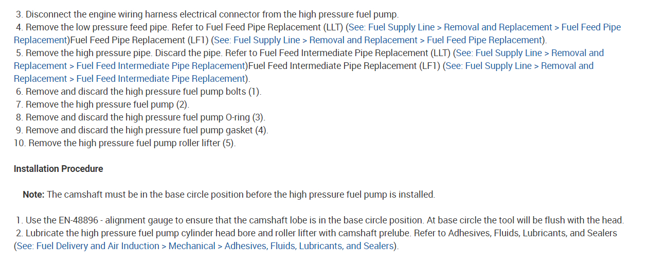

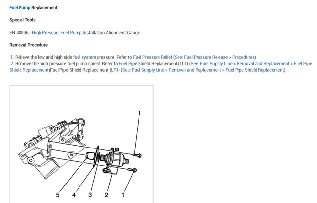

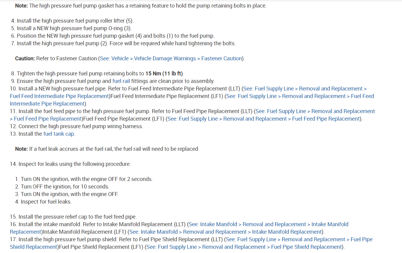

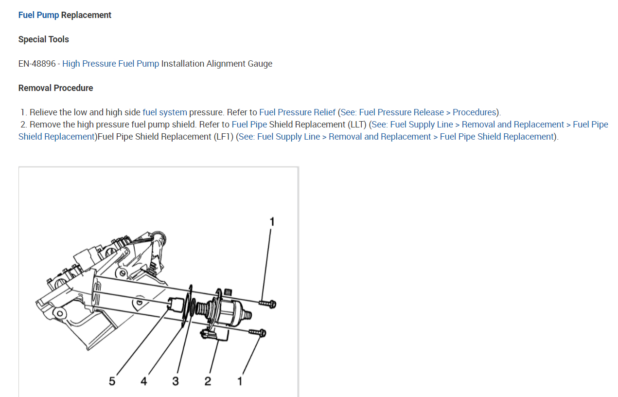

I attached some guides below for you to review. This could be a fuel delivery issue from a bad fuel pump or it could be a spark issue.
https://www.2carpros.com/articles/how-to-replace-an-electric-fuel-pump
When it does not start, you will need to test both the fuel pressure and spark to see which system is malfunctioning. I attached the procedure for replacing the pump if it is a failure. You can rent a tester at a parts store.

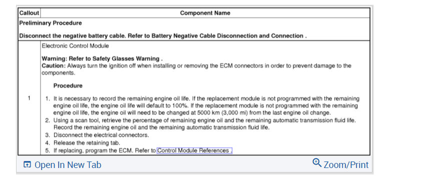

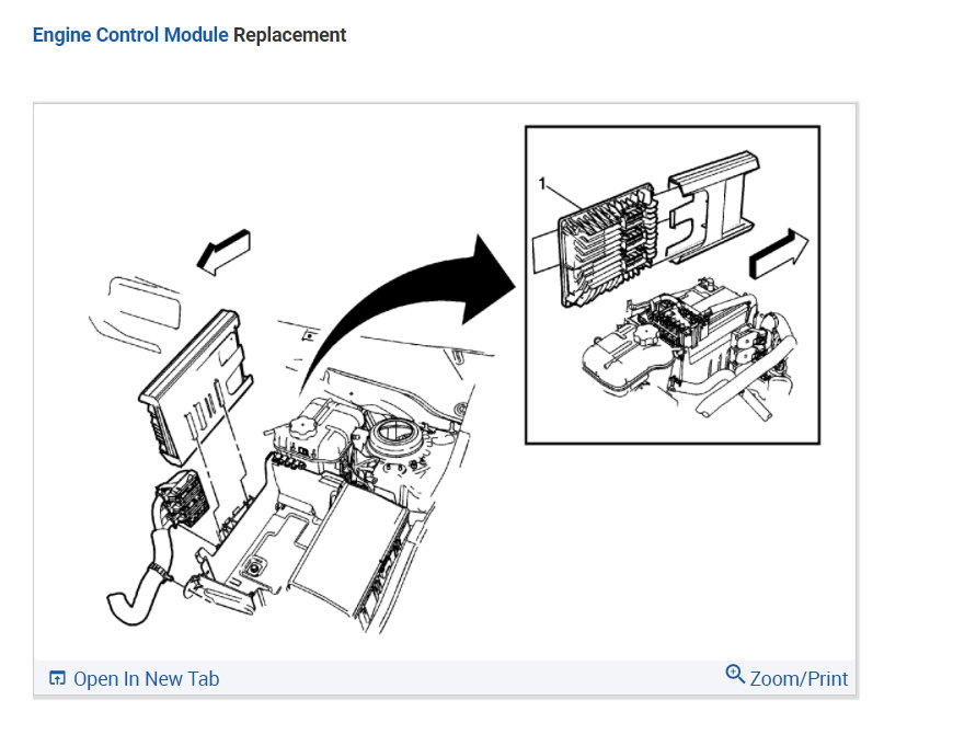

If it is spark-related, it could be the ECM as it controls the spark for the engine control system. I attached the location and the procedure for replacement.
