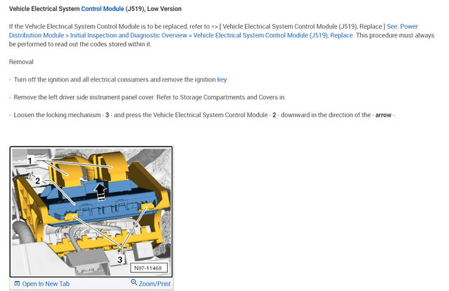

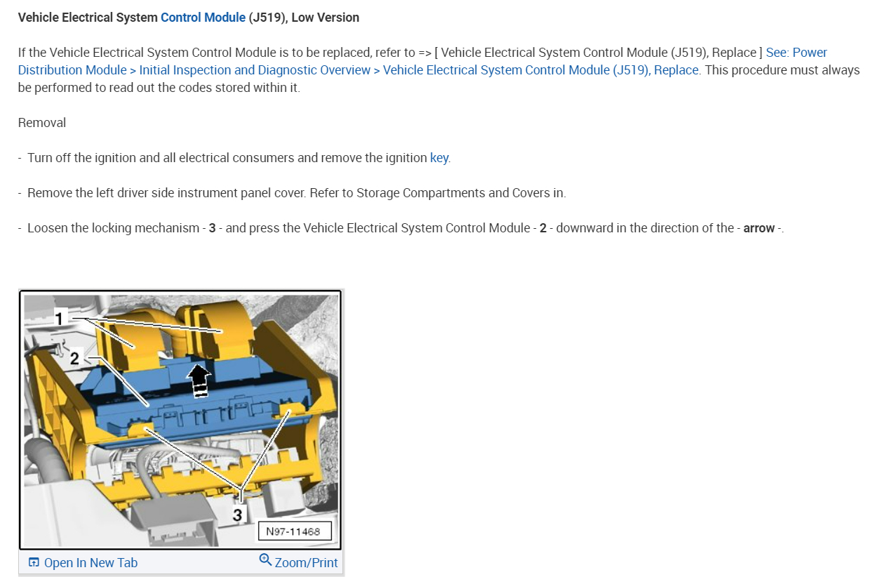

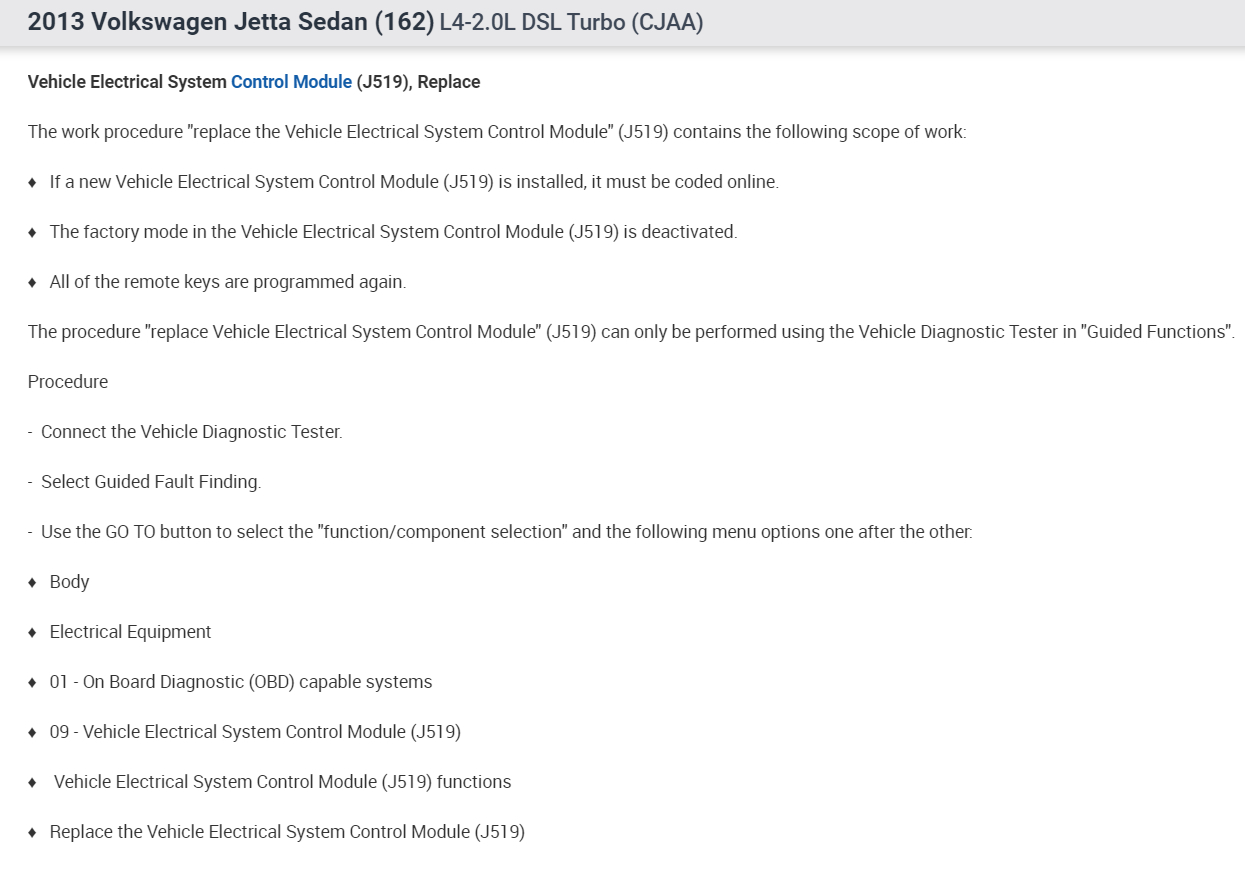

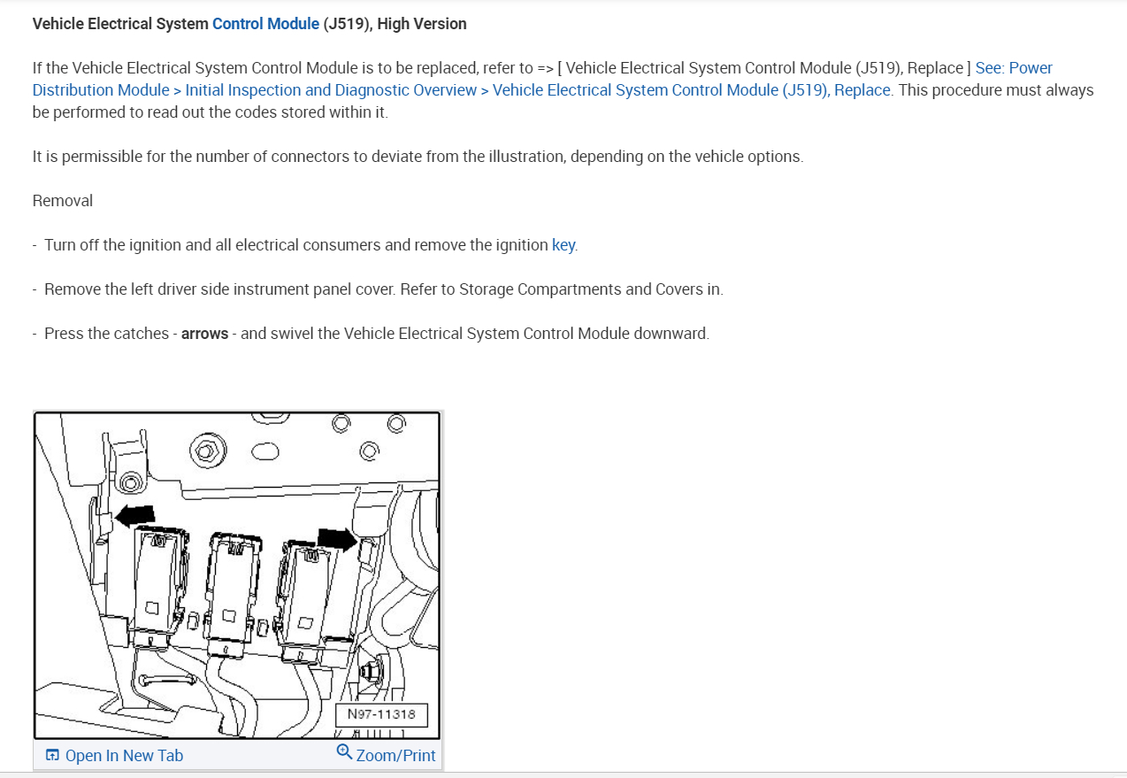

This sounds like a bad Vehicle System Control Module but to be sure we need to run a CAN scan which is easy to do. You can get a CAN scanner (Controller Area Network) from Amazon from about $32.00.
https://youtu.be/u-4syLc-ifQ
and
Amazon CAN scanner link:
https://amzn.to/3sX8MCX

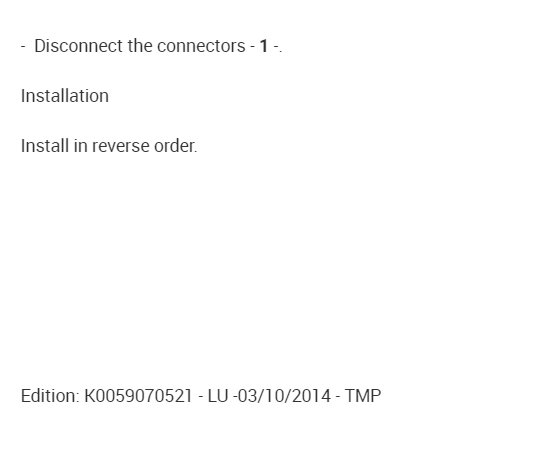

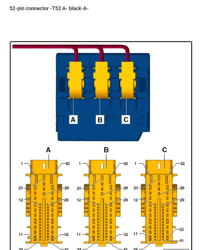

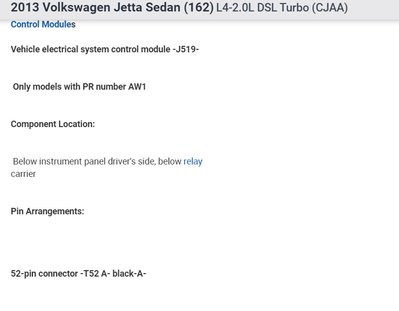

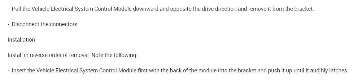

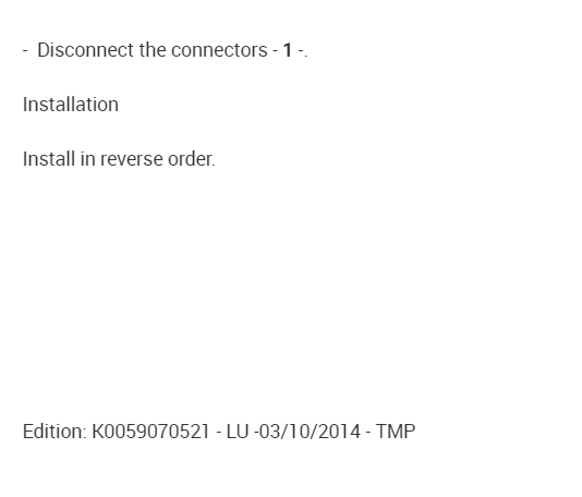

Here is how to replace the Vehicle System Control Module in case you need it. Check out the images (below). Please let us know what happens.
