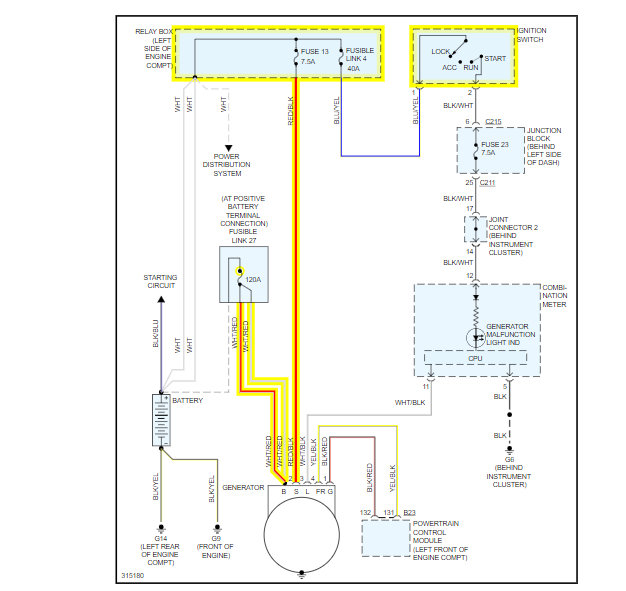

My battery keeps dying. First I had the battery checked. Good battery. Then I replaced the alternator and fully charged the batter drove it for about 10 maybe 15 minutes and it died again. If i get a jump it starts right up but dies within minutes. If I fully charge the battery it lasts a little longer. I fully charged the battery again and had both the battery and the alternator tested both came back good but the terminals on the battery were a little loose so i tightened them. Again drove for about 10 maybe 15 minutes when i first shut it off it started back up so i thought i was in the clear but when i came back out to leave about 30 minutes later battery was dead again.

It sounds like you have a charging system issue.
Have you checked the voltage at the battery with the engine running to verify the alternator is working? It needs to be 14 to 14.5 volts.
This guide can help as well
https://www.2carpros.com/articles/car-battery-dead-overnight
I attached a wire diagram for you and you need to verify voltage to the highlighted wires with the key on.
