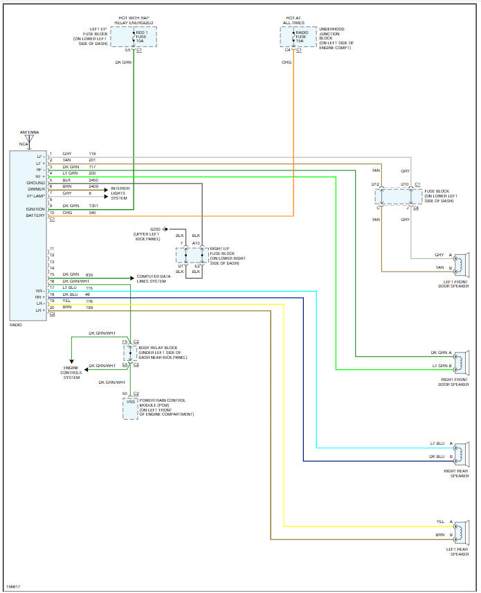

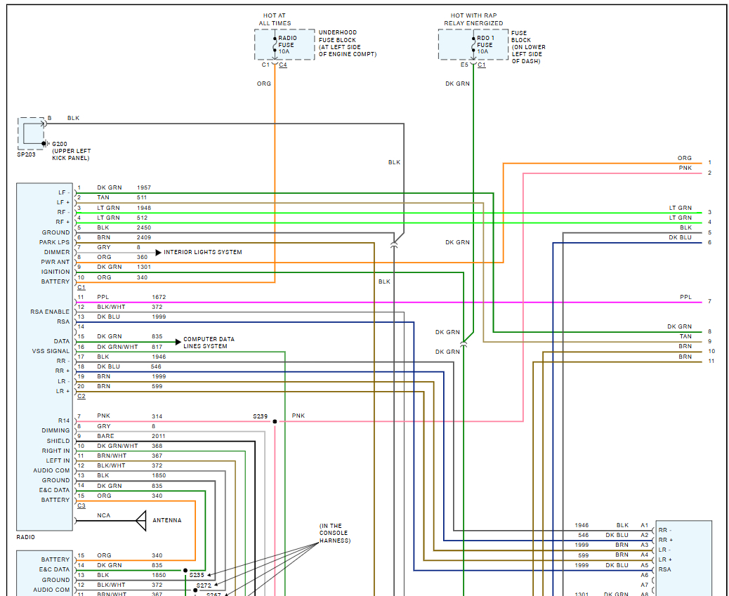

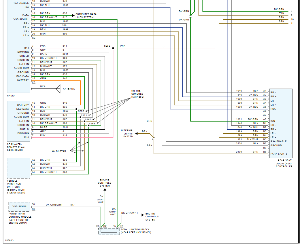

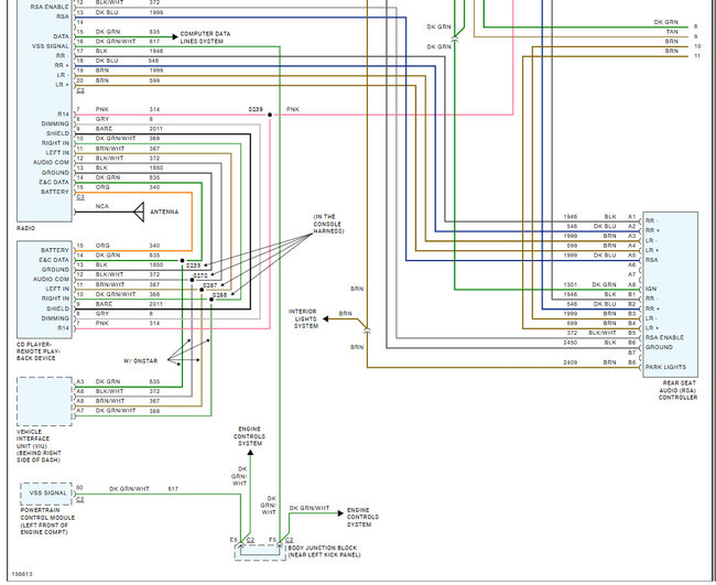

Can you send me a wiring diagram for the non-Bose system with rear subwoofer. Changing rear door speakers and need the wiring colors/schematic. Thanks
Nov 29, 2025 at 11:38 AM
  • 55,224 POSTS
Hi Danny, here are the radio wiring diagrams as requested. Let me know if you need anything else. Check out the images (below). Let us know how it goes

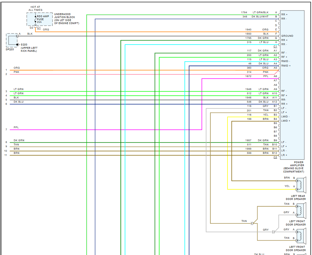

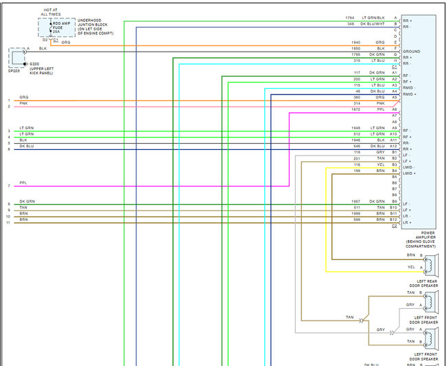

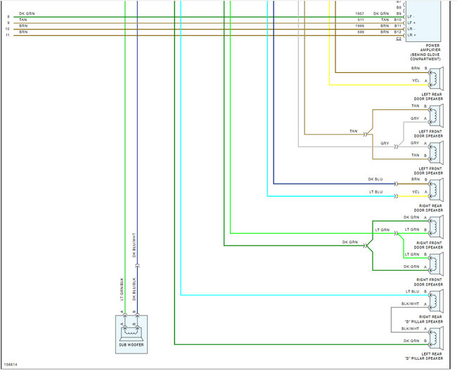

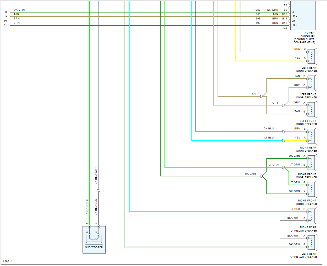

Thanks, can you provide me with the rear subwoofer diagram? This is helpful, but need more info
Dec 2, 2025 at 8:44 AM
  • 55,224 POSTS
Sure, here is the other system which has the subwoofer. Check out the images (below). Let us know if you need anything else.
