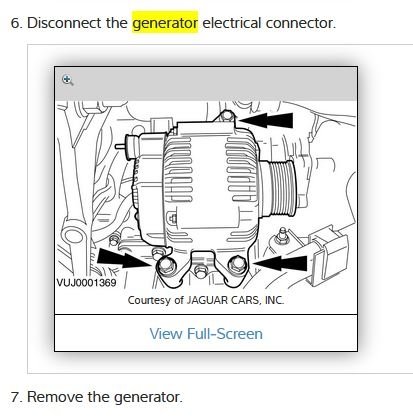

Good evening, my car alternator is overcharging. Do you know what can cause this to happen?Thank you in advance.
Jan 8, 2020 at 4:52 AM
94 TRANSAM
  • 680 POSTS
This is caused by the voltage regulator failing. When they do they either stop charging or over charge. It will need to be replaced.
Step by step below.
Rich
Jan 8, 2020 at 4:59 AM
AUSTINO
  • 231 POSTS
thank you.
Jan 8, 2020 at 5:15 AM
94 TRANSAM
  • 680 POSTS
You are very welcome. Anymore questions or help please come back and ask.
Rich
Jan 8, 2020 at 7:16 AM
AUSTINO
  • 231 POSTS

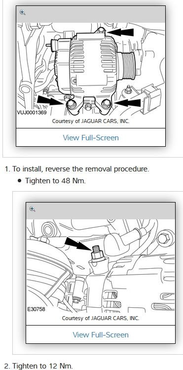

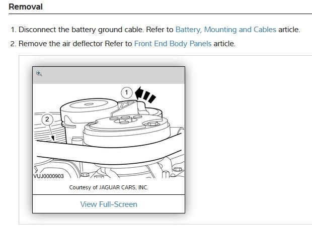

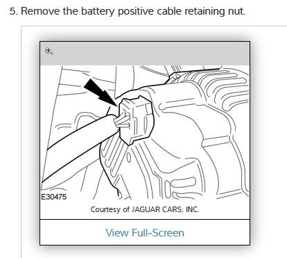

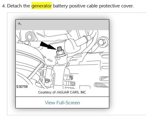

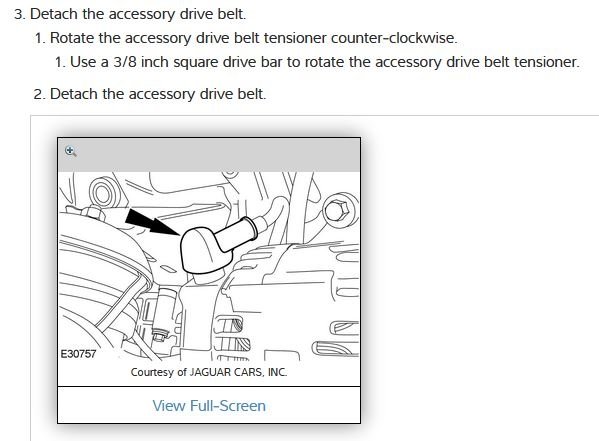

Hello, good morning. can you please tell me where the voltage regulator is located in the car please? Can you please send a diagram showing where it located? Thank you for a speedy response.
Mar 17, 2020 at 1:16 AM
94 TRANSAM
  • 680 POSTS
The voltage regulator is inside the alternator and is not serviceable. You have to change the whole alternator.
