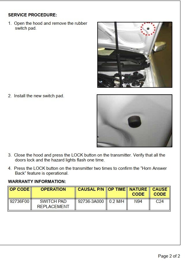

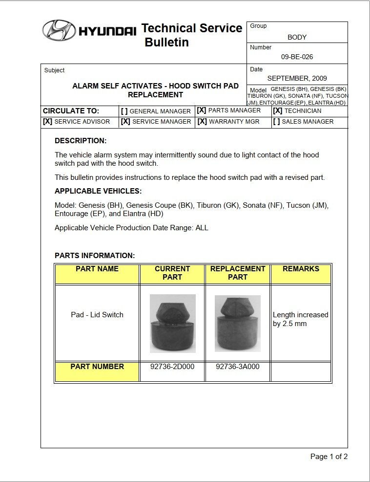

Being a 2008 they should be able to go into the security system and see what is turning it on. The common items are door and hood switches. There is a TSB out for that vehicle with this problem as well. It involves replacing the rubber bumper with a different one, so it hits the hood switch better. Hyundai TSB 09-BE-026

Technical service bulletin. IE something that the company has found that repairs a known problem. It basically says, we know this is a problem, here is a solution to it. In this case they know there is an issue with the hood bumper causing the alarm to go off because the hood switch doesn't depress fully and randomly sets off the alarm. The same issue you have, and knowing how many times vehicle alarms get tripped by bad or bent switches I would say it's very likely the problem.
The reason it doesn't go off when manually locked is that using the manual locks doesn't arm the anti-theft system. Nothing to do with the fob.

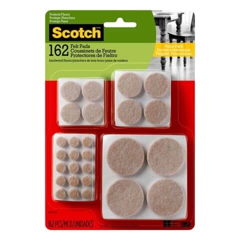

It is a simple switch that is the common problem. An easy solution is to simply add some material to the rubber bumper that moves the switch. I've used the self stick felt or plastic floor protectors for it without an issue. Clean the bumper with some alcohol, let dry peel the backing and stick it in place. Like the attached but in lower quantities.

The dealership claimed the trunk and hood were closing fine hence their attention on the driver's door. They should be aware of this hood issue with my model?

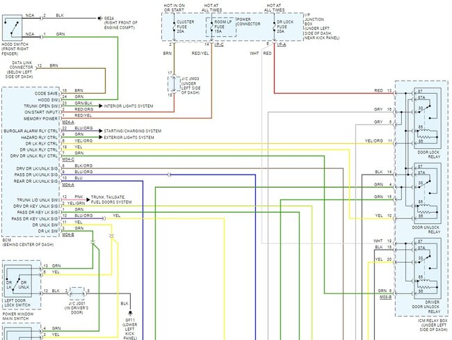

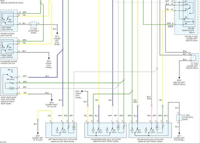

They may be closing fine but if they didn't pull up the TSBs they may have missed it, that is not uncommon. It's also possible that it is a door switch but usually you can look at the data and it will show what switch activated the alarm, so it would show something like LH Door active in the system. I'm just saying that it's a place to start. The other option is to put a data recorder in it and when it goes off it would record what was setting it off.

I would add the felt to the bumper and see if it stops going off. If it does you fixed it. If not, then it's likely one of the door or the trunk switches. If it's one of the door switches and the doors are closing normally then the repair is usually replacing the latch assembly as the switch is inside the latch.

He did say he looked for and replaced a rubber cap so hopefully that does enough. He didn't seem convinced though. I wouldn't mind if he disabled the switch entirely. Not sure if he can't or legally isn't allowed. Either way nobody is stealing this old car. Lol.

Well, so far so good with the rubber cap. It is a cheap solution. Wish they would of tried it in the first place.
