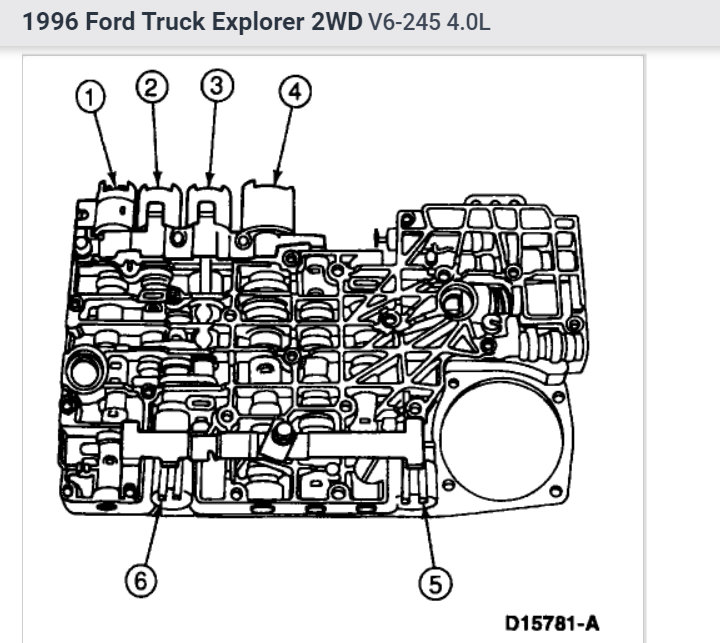

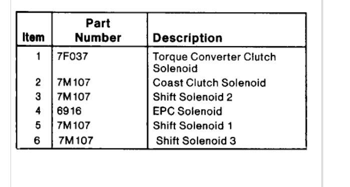

I have seen the pressure control solenoid go out which will cause the transmission not to go onto gear. You will need to remove the transmission pan which this guide can show you how and I have left the instructions on how to change it out in the diagrams below.

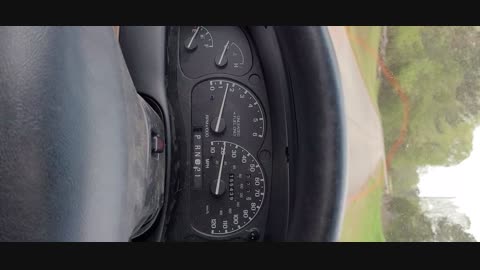

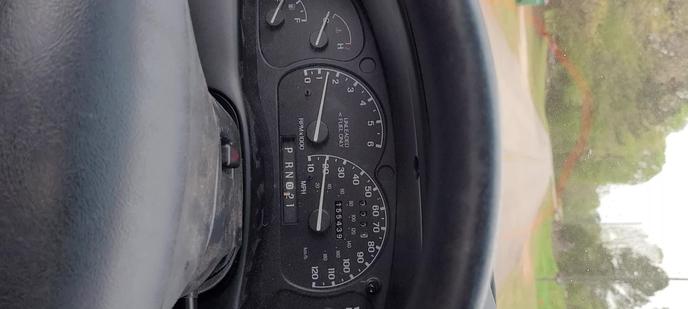

I'm uploading a video ignore the rattling it's a socket set not the car. The car will only go past 2,000 to shift into first gear then from 3,000 it slams into second gear and will not go past 2,000 RPMs, also will not top more than 35 MPH.

OTTIS710
Video should be with this reply.

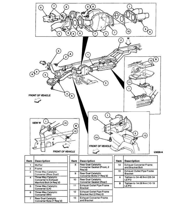

This seems like the catalytic converter is clogged. To be sure this guide can help confirm the issue:
Let me know what happens and thanks for the video, it helped. Check out the diagrams (below).
