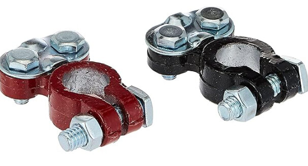

Yep, I would look at that battery terminal connections, if yo have an cable end repair kit like the one down below in the images these are famous for corrosion and stopping the car from getting electrical power.
https://amzn.to/3Vvibjv
Please go over this guide as well
Check out the images (below). Let us know how it goes

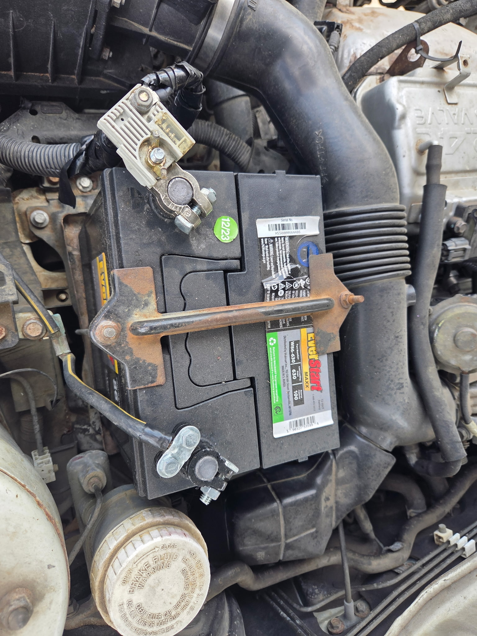

Yes, a continuity will not help, once the draw hits the circuit it shuts down. Are the cable ends painted? this will make it fail as well, I would remove the battery cable ends from the cable and scrape clean the connect area. Can you upload an image of the cable ends so I can see?
Sep 10, 2025 at 5:54 AM
PAULSENJAKE
  • 30 POSTS
they are painted, but it ran for a solid 2 months before it happened
Sep 15, 2025 at 5:26 AM
PAULSENJAKE
  • 30 POSTS
I'm gonna sand the inside of the negative terminal
Sep 15, 2025 at 5:59 AM
  • 55,224 POSTS
Yep, good call, this should be the problem. Thanks for the image, it helps.
