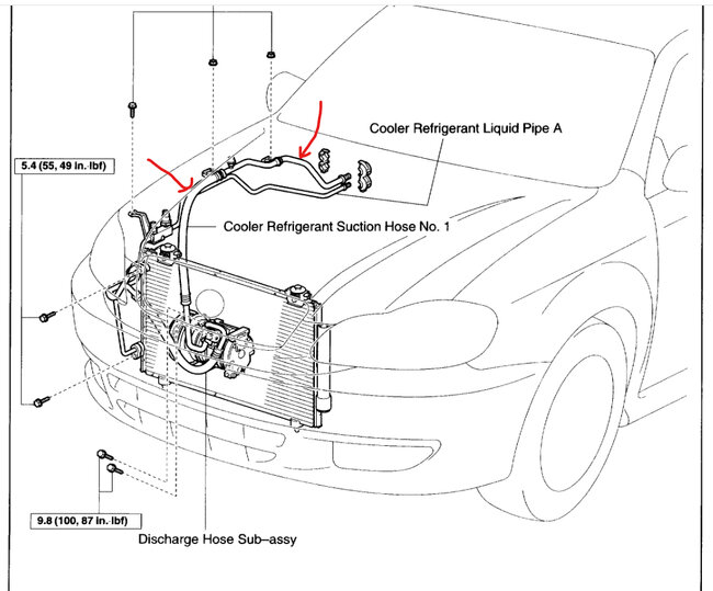

(90-100 degrees+) My car A/C is decent, but could be better when idle in this hot weather.
Jul 8, 2024 at 4:58 AM
  • 55,447 POSTS

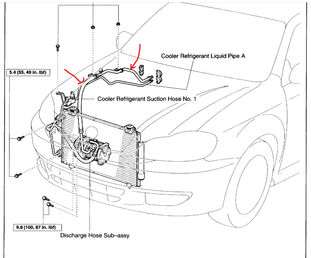

It sounds like the refrigerant level might be low, I would use a garden hose and pressure wash the condenser and radiator core (fins) to remove dirt, then here is a video to show you how to check and add refrigerant:
https://youtu.be/uZrQCGwXfek?si=paiqv4wKwjE8Gqz_
The service port is on the low side line here are images to help you find it. Check out the images (below). Please let us know what happens.
