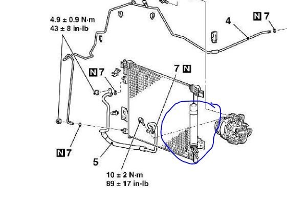

Low pressure side from ac cooler is too high and high pressure side is too low.
When accelerating about 2,000 rpm's the blowing cold air will be perfect.
Please send me how can i rectify the problem, and how can i dismantle compressor inside if required?

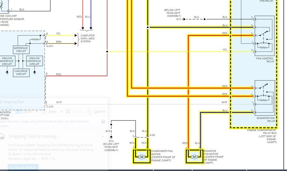

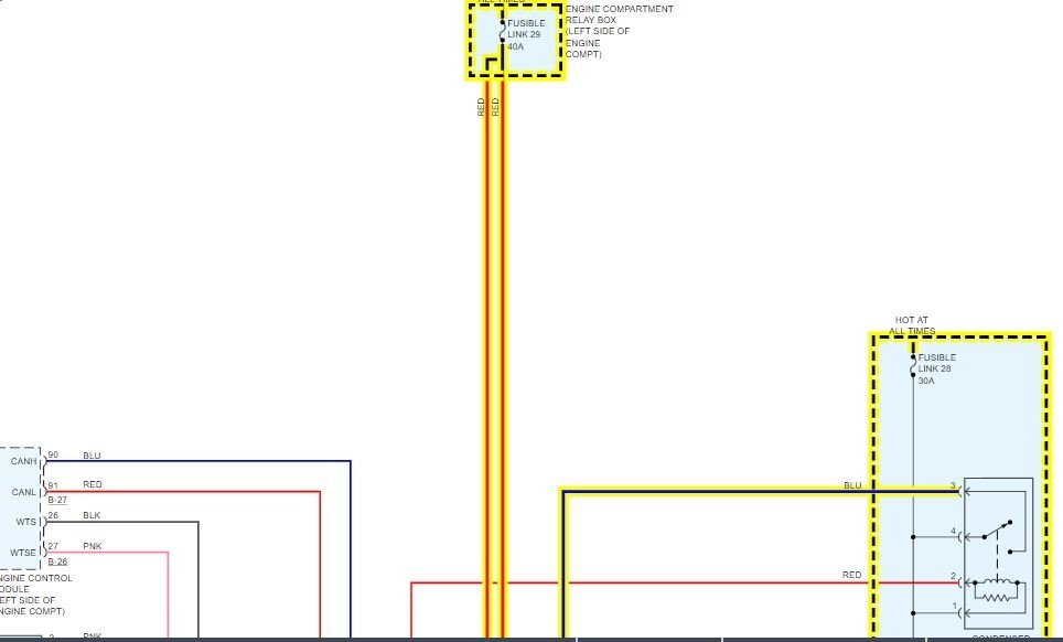

Are the cooling fans running with the A/C on?
https://www.2carpros.com/articles/how-an-electric-cooling-fan-works
If they are not working, the air will not be cold especially at idle. When you drive, you are forcing air through the radiator.
May 1, 2020 at 4:59 AM
PETROYADA
  • 66 POSTS
Yes, the cooling fans are running with the A/C on.

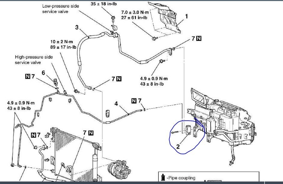

Low side :45 psi.
High side : 150 psi.
In idle .
May 1, 2020 at 10:52 AM

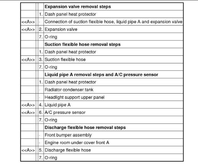

Okay, the low side is too high. It should only be 25-30 pounds and rock solid.
The high side should be 2 times outside temp plus 15%.
It looks like you need a expansion valve and a dryer so far.
