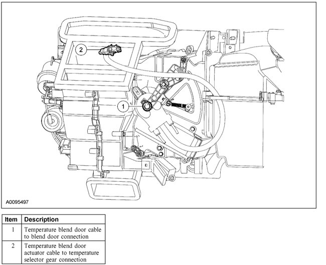

When running interior heater is on. Can’t turn off won’t turn down A/C won’t come on.
Aug 4, 2019 at 3:27 PM
  • 55,215 POSTS

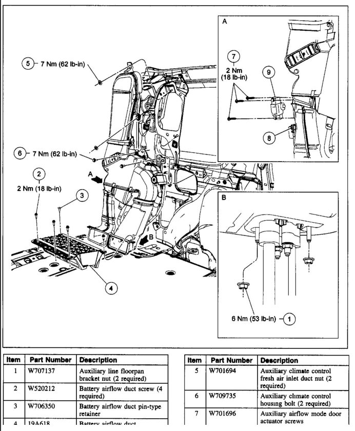

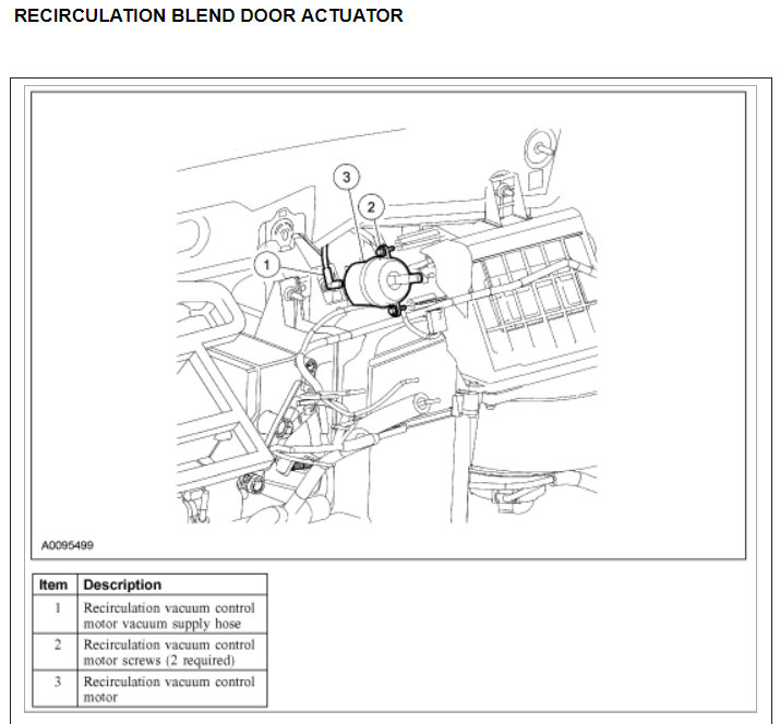

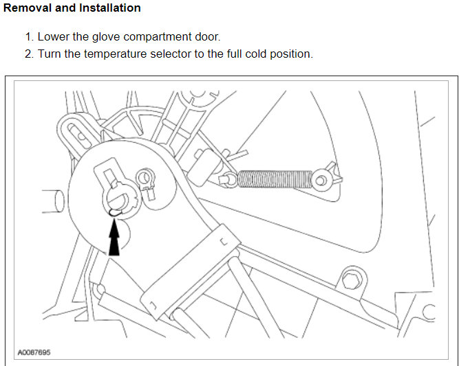

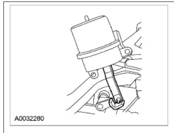

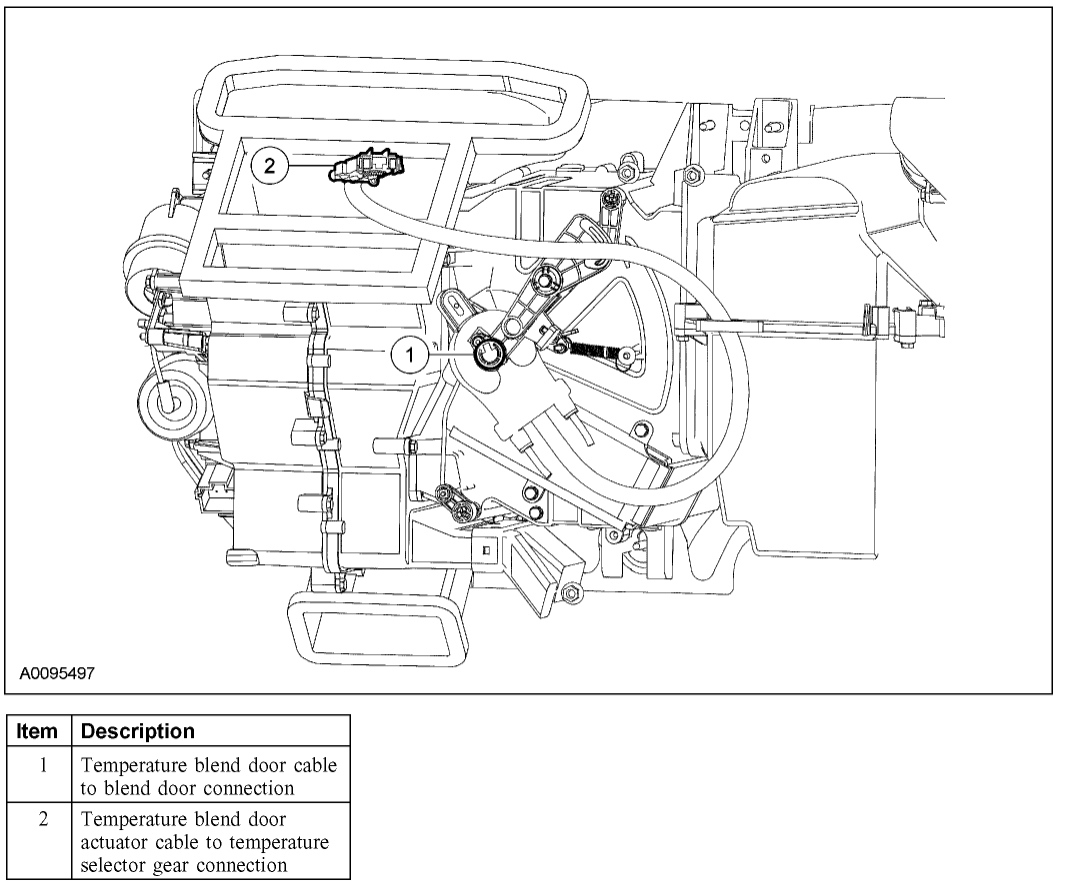

This is common when the mode blend door actuator goes out. here is a guide to walk you through the repair with instructions on how the job is done one your car in the diagrams below:
You may have a vacuum leak under the hood that supplies the HVAC system as well. this guide will help:
