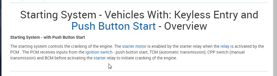

Car was in a minor front end collision. The engine won't turn over since collision. It's like the computer does't recognize the key. Any thought on what it might be?
Jan 11, 2020 at 10:23 AM
This could be a number of things but we are guessing until we check the codes. I suspect you have a pinched wiring harness but you should have some communication codes. If you do then we can track them down.
Also, let me know if you have a push button start or a turn key. Thanks.
