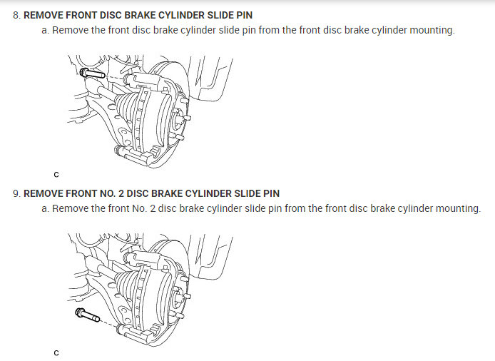

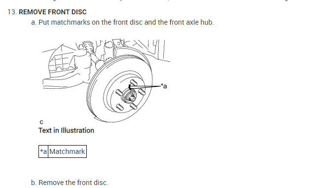

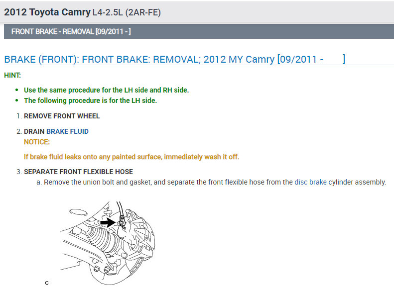

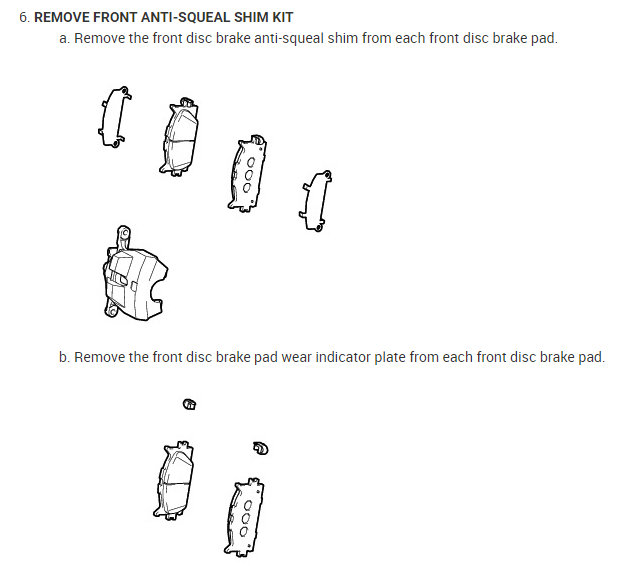

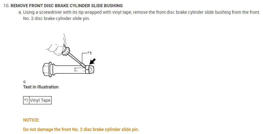

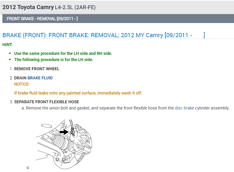

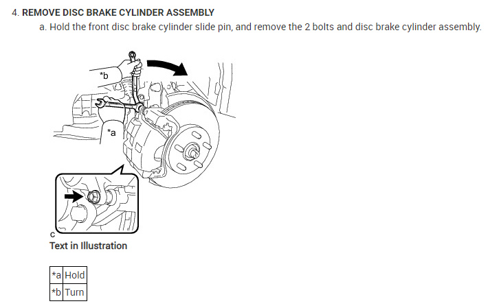

I have a 2012 se Camry and my battery died, I had to jump start my car and the signals, heat and power windows worked, after I changed my battery the problem is gone but I need to do the brakes.
Jan 31, 2016 at 8:53 AM
DANNY L
  • 5,648 POSTS
Hello, I'm Danny.

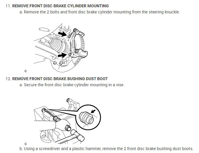

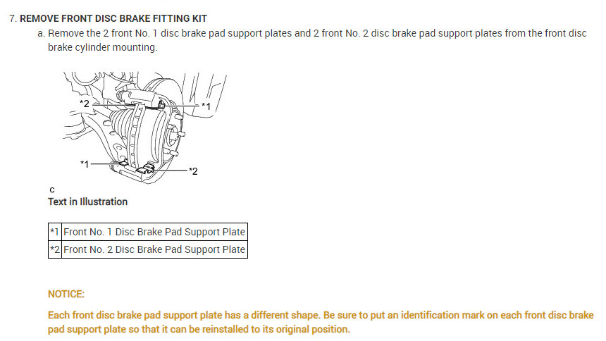

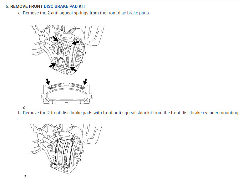

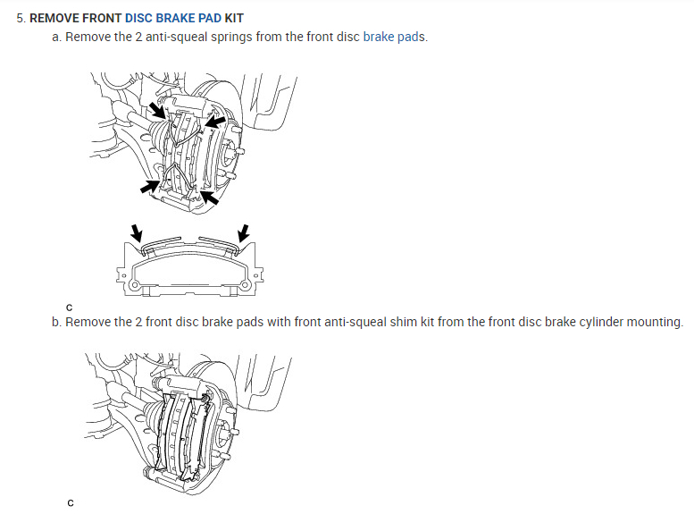

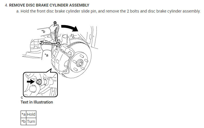

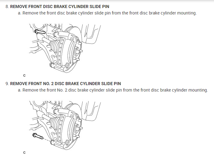

Here is a tutorial for you to view getting you started on how to change the front brake pads and rotors:
I've attached picture steps below on how to change the front brake pads and the rotors on your Toyota. Hope this helps and thanks for using 2CarPros.
