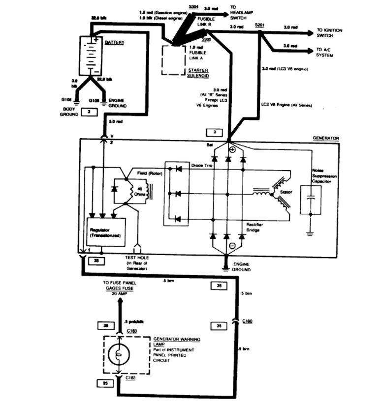

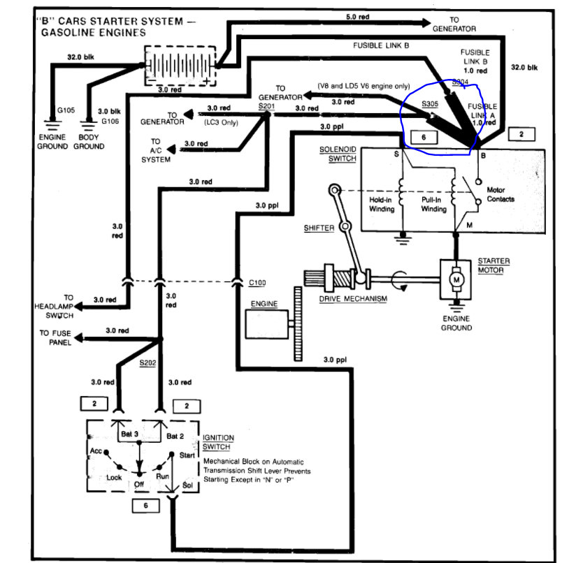

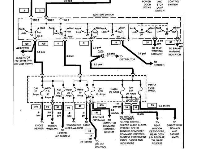

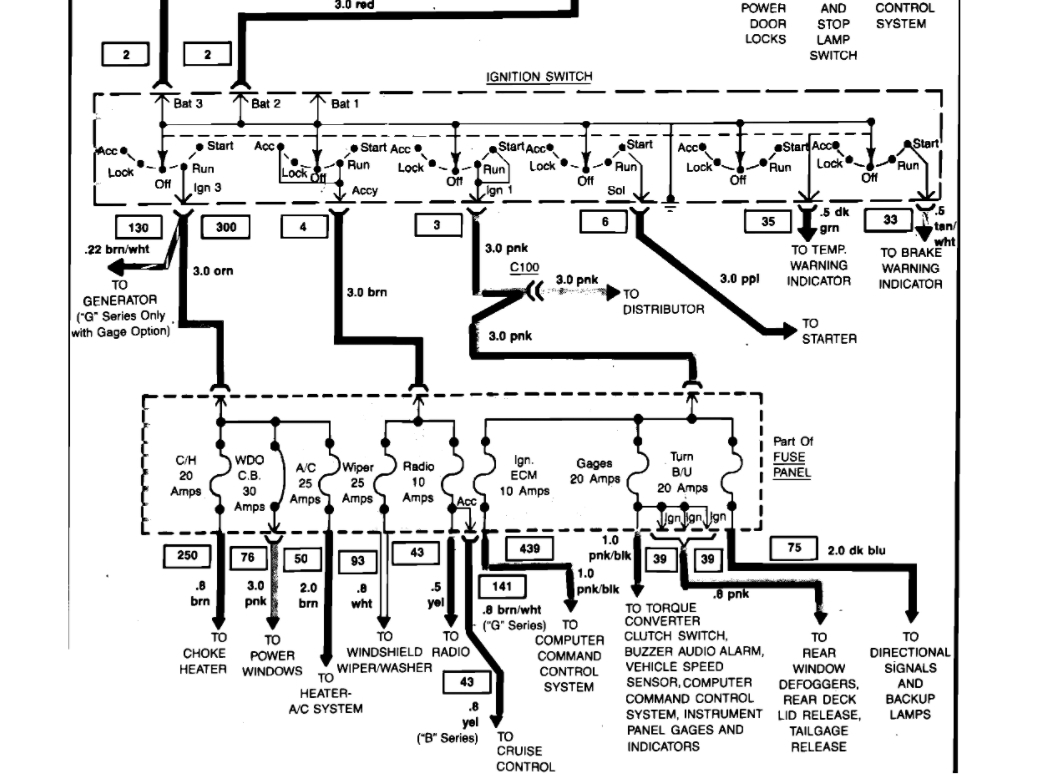

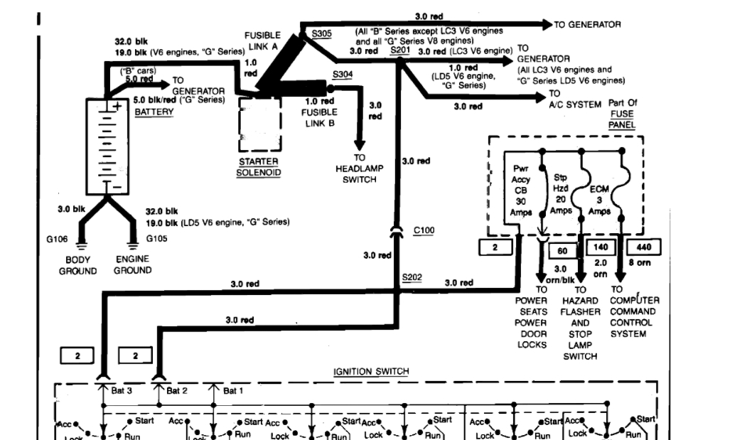

Caprice classic was working just fine until I was backing up in my driveway and it just shut off. no power no crank nothing .I checked the battery and fuses they are all good. What should I do?
Apr 29, 2021 at 8:59 AM
Good evening,
I attached some guides for you to follow. You need to test the battery voltage. It needs to be 12.6 volts for the car to have power.
https://www.2carpros.com/articles/how-a-car-electrical-system-works
I also attached wiring diagrams of the starting system. I circled the fusible links that are common for failing at the starter. They will cut power to the car if they are bad.
