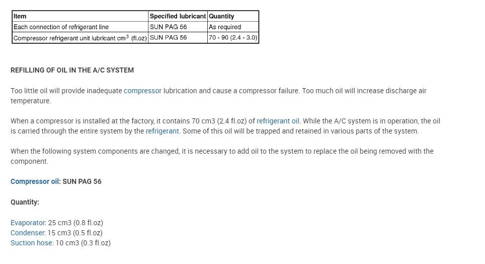

The A/C compressor for my car was failed and also we will replace with a new one, but for installation, I need the procedure.
1. I will be replaced by the new A/C compressor and A/C Dryer?
2. How the amount of oil will be charge into compressor?
3. If I refill the oil in the new compressor and reinstalled it so after vacuum, should be a bit charge oil or not?
Please inform me that how can I install a new compressor properly?
the VIN related to my car is : 4P3XTGA2WEE801499.

I attached the nformation for you below. It takes 3 ounces of oil in the compressor.
Why are you replacing the compressor?
