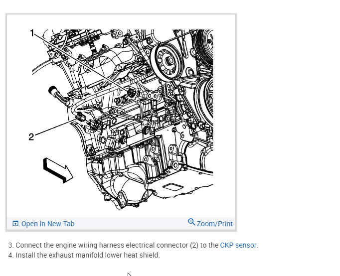

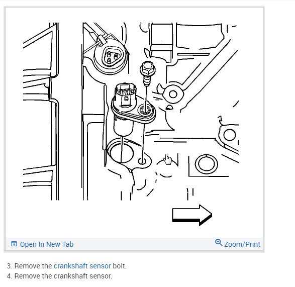

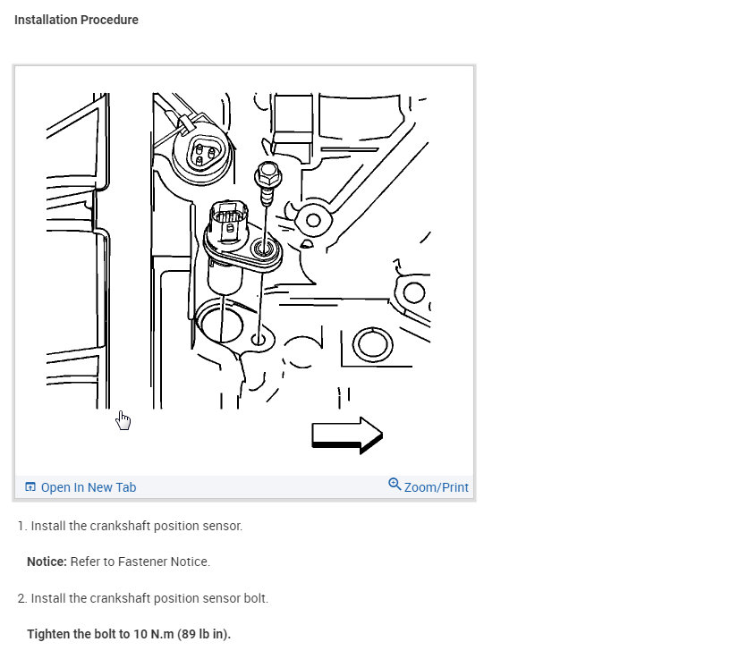

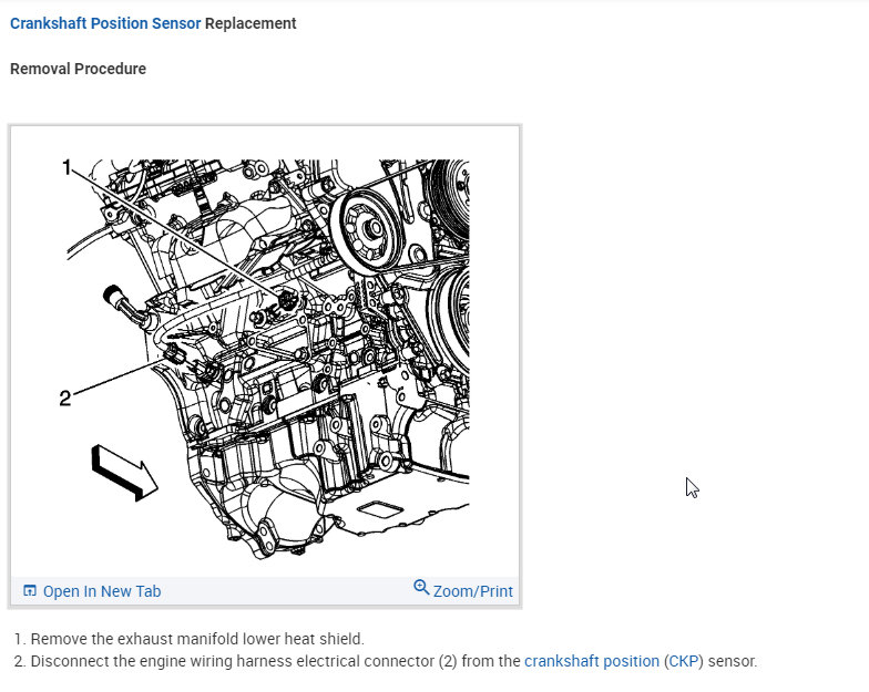

Car starts every morning but once it’s driven and hot outside I can’t start it until hours of letting it cool down? Replaced starter and battery.
Sep 3, 2019 at 8:38 AM
✓Experienced Mechanic
18,907 POSTS
The most common cause of this issue is the crank sensor. Clearly there could be other causes but I would not move on until we replace the crankshaft sensor.
Here is a guide that will explain this a little more:
I also attached the procedure on how to change the sensor. Please let me know if you have questions. Thanks
